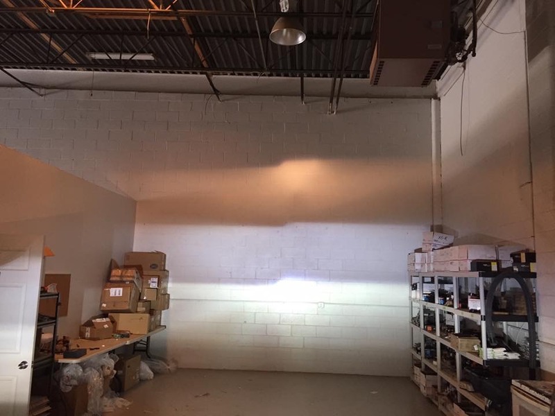

Just found this image, it's a halogen vs LED vs HID in the same halogen projector:
The exact results will vary depending on projector and LED design, but you can see there is no hotspot at all for the LED. This will translate into very poor distance lighting which is where you need it the most. It'll also have an over bright foreground fooling the brain into thinking it's a 'better' light. Unfortunately, we aren't very good at comparing light objectively...
Got to admit the led looks quite poor in that pic compared to hids anyway.
