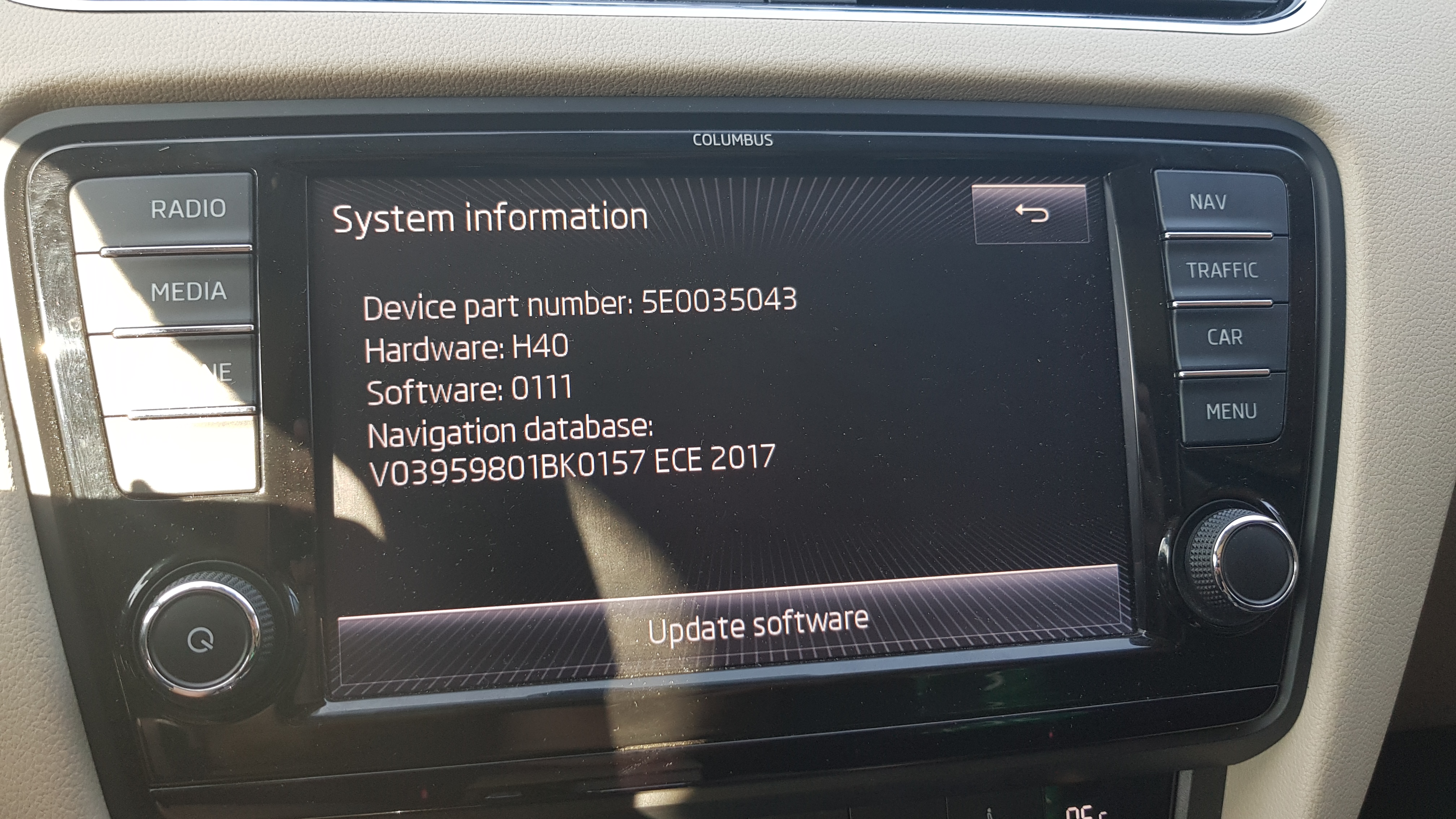

skoda411.zip is the right file for my unit?
Edited by mecatalin
My car is also June 2013 with a MIB1 Columbus. Mine originally had very old firmware, similar to yours, and I have successfully updated it to 0411. It is easy to do, doesn't take very long. Confusingly, on your screen shot where it says Software: 0111, that is the firmware version. Where it says Update Software, it means update the map version, quite different. To update the firmware you have to press and hold the Menu button, bottom right, to get to another menu where you can update the firmware.

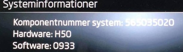

I retrofitted columbus mib 2 from Skoda Octavia MY2017 to my superb.
The MIB 2 unit has FW 0933 (only Octavia support) and needs to be updated to latest FW(for superb).
Is there any place here to get FW?
