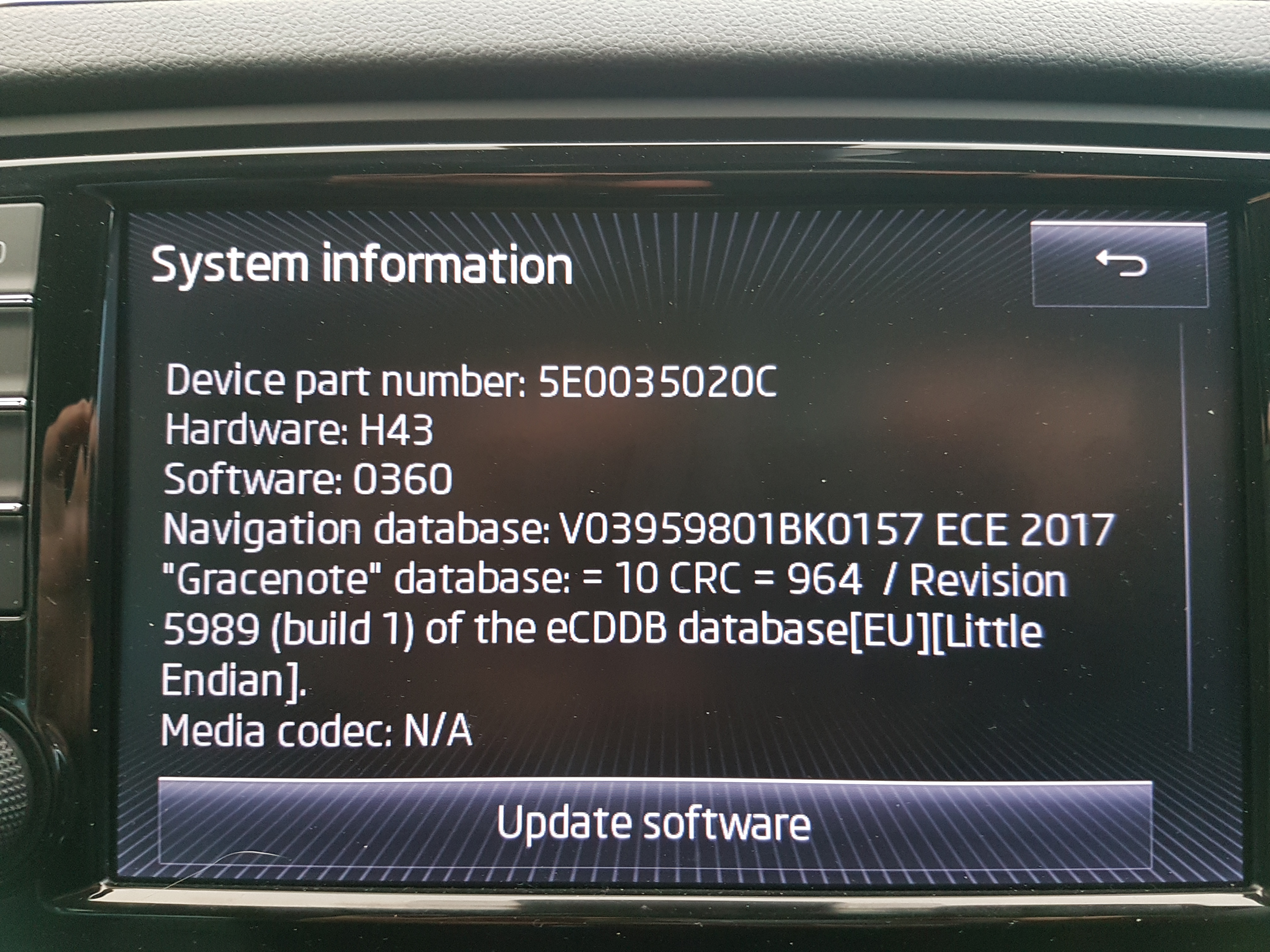

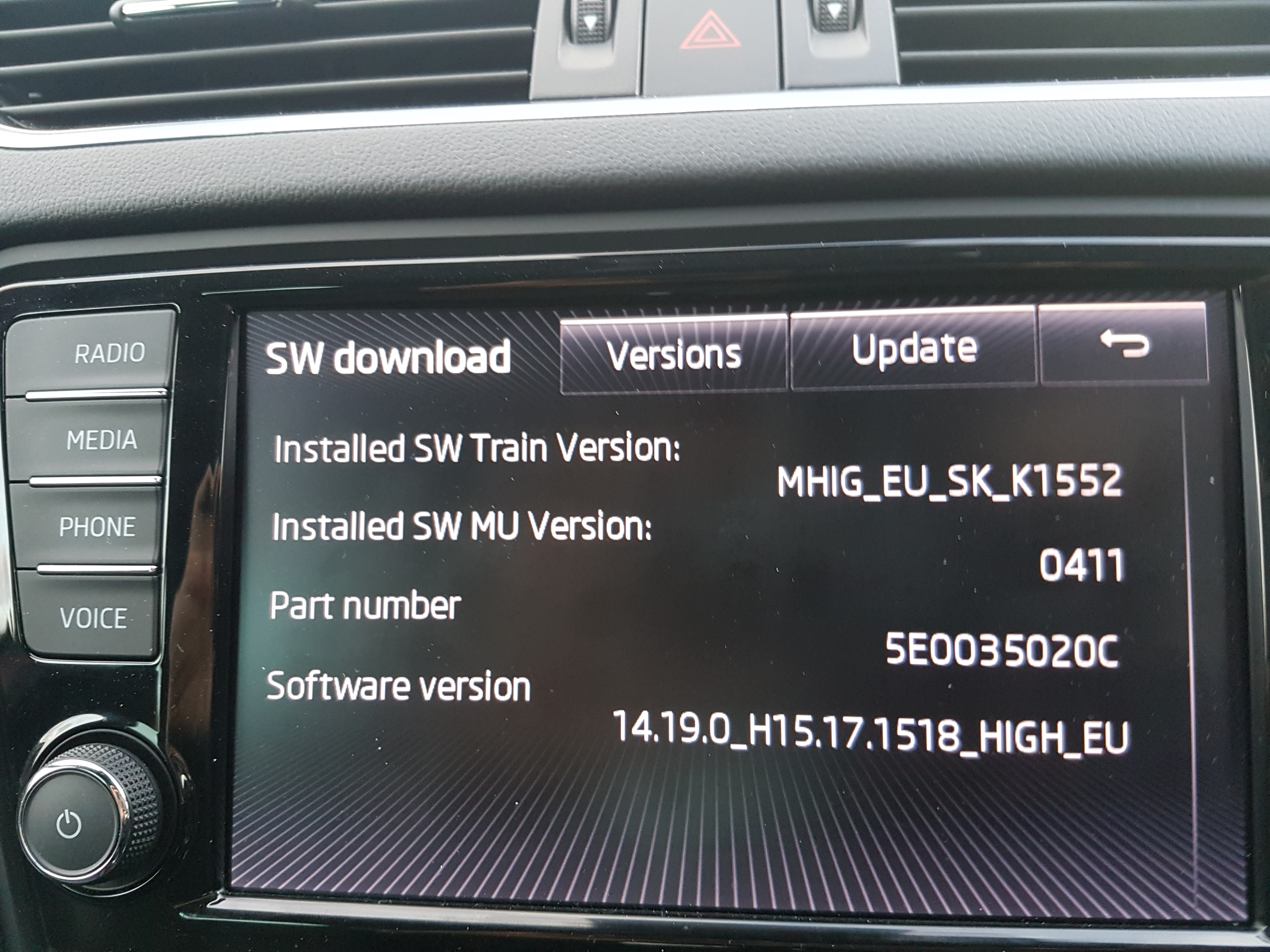

Before and after shots
2 hours ago, logiclee said:
I'm currently on 0360 and experiencing no issues apart from the sound is a little on the thin side with a lack of bass.
Any benefit upgrading to 0411?
I upgraded form same version as you to 0411, and i must admit that bass and volume are better, but dont expect too much.

Ok so  I went out to the car and phoned home just to test it and it all works fine.
Sounded great, maybe better than before or it could be I'm imagining its a better fuller tone less tinny. Lol

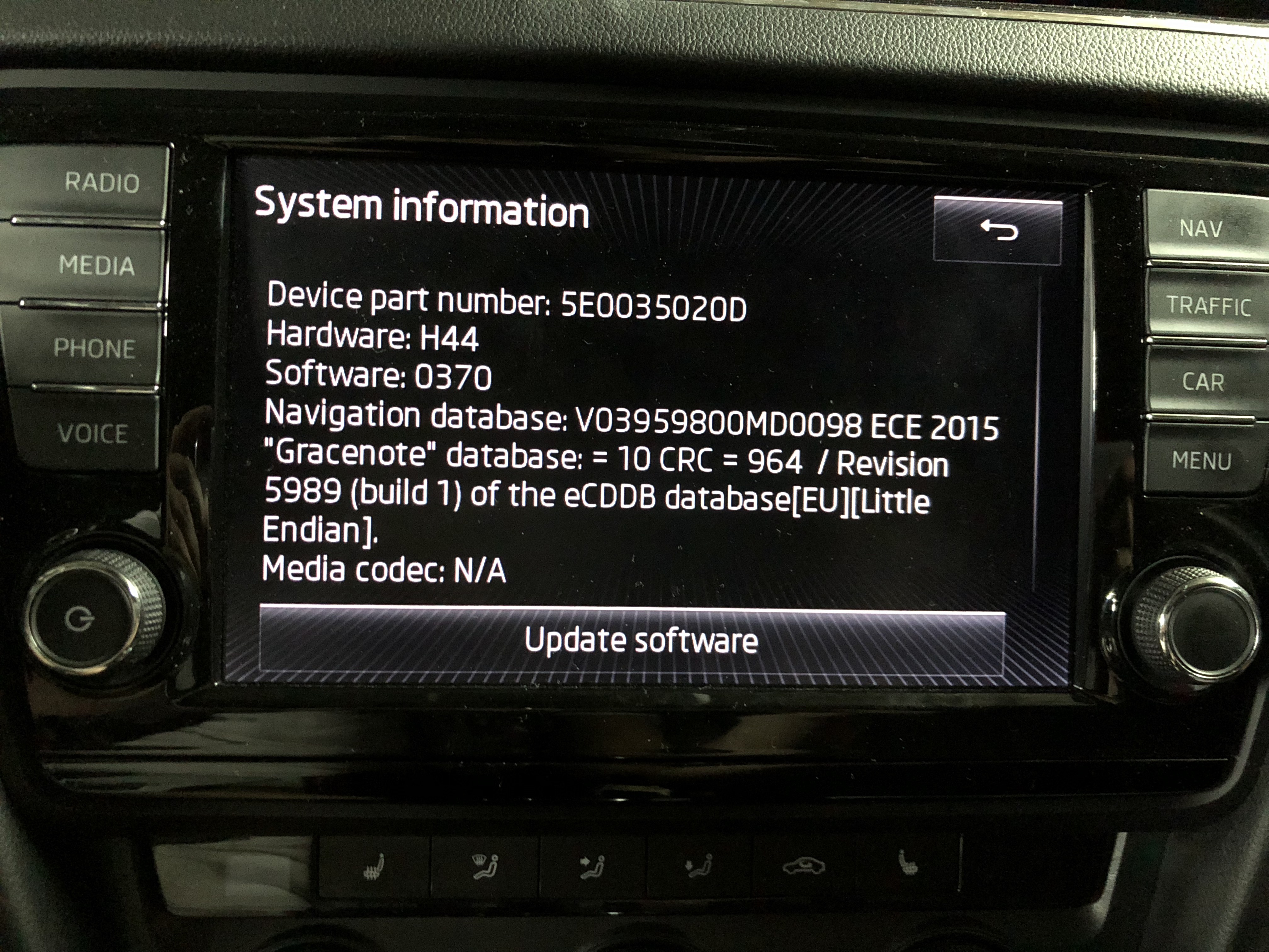

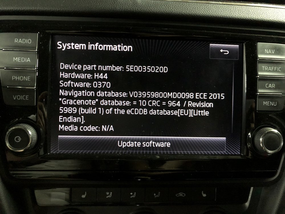

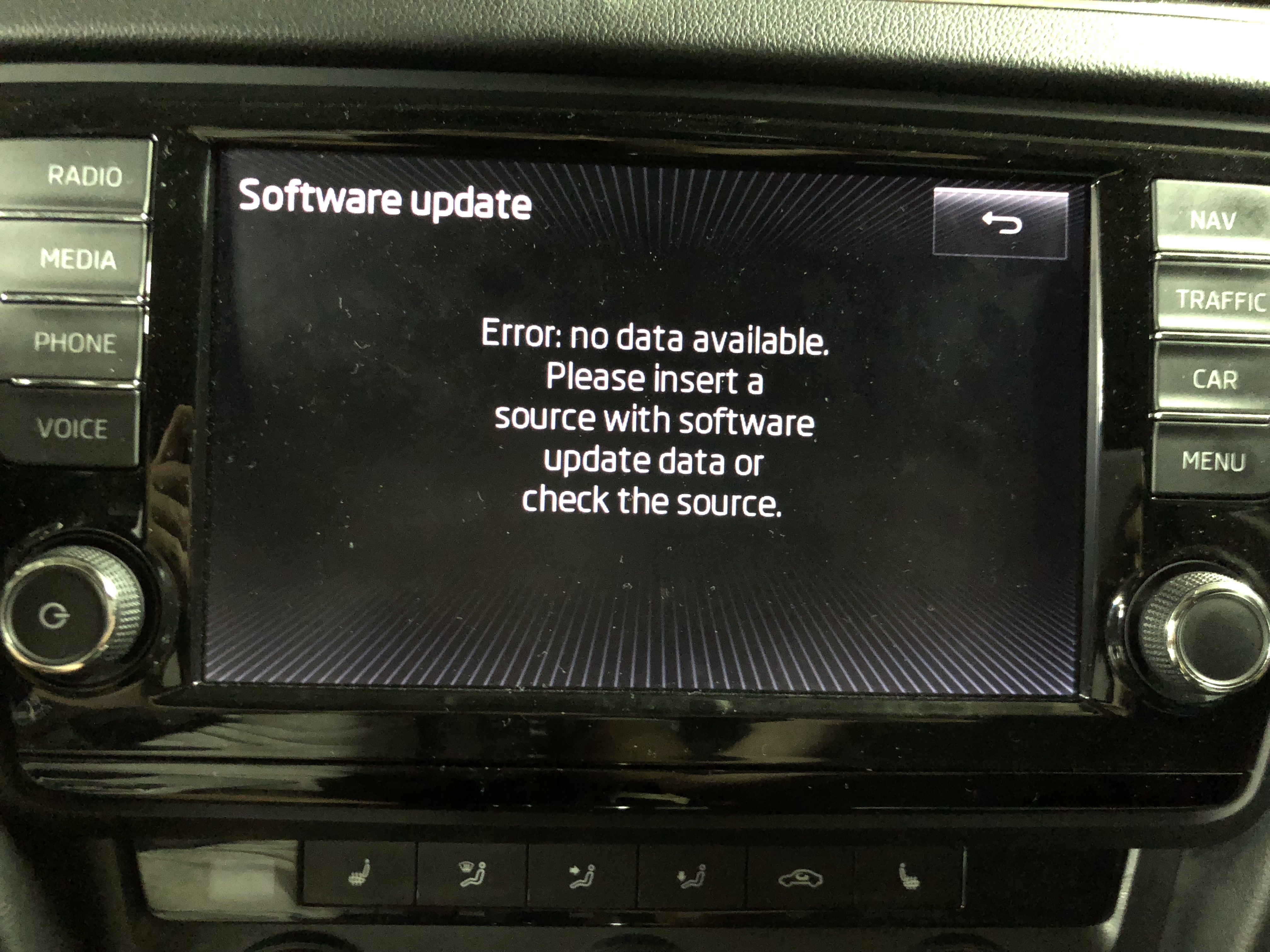

I'm trying to do my update last few days, but unsuccessful?!
After download and unzip, appears 3 files
- metainfo2.txt
- Mib1
- Mib2

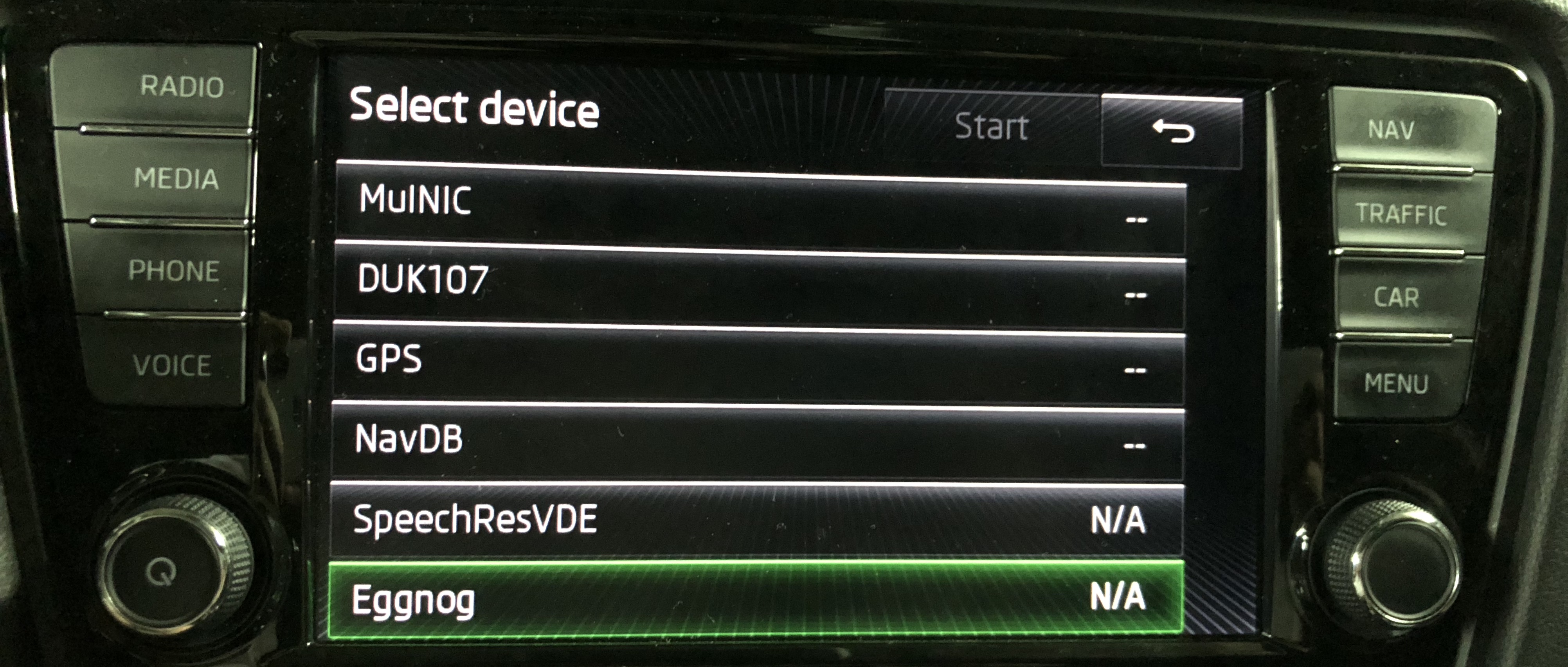

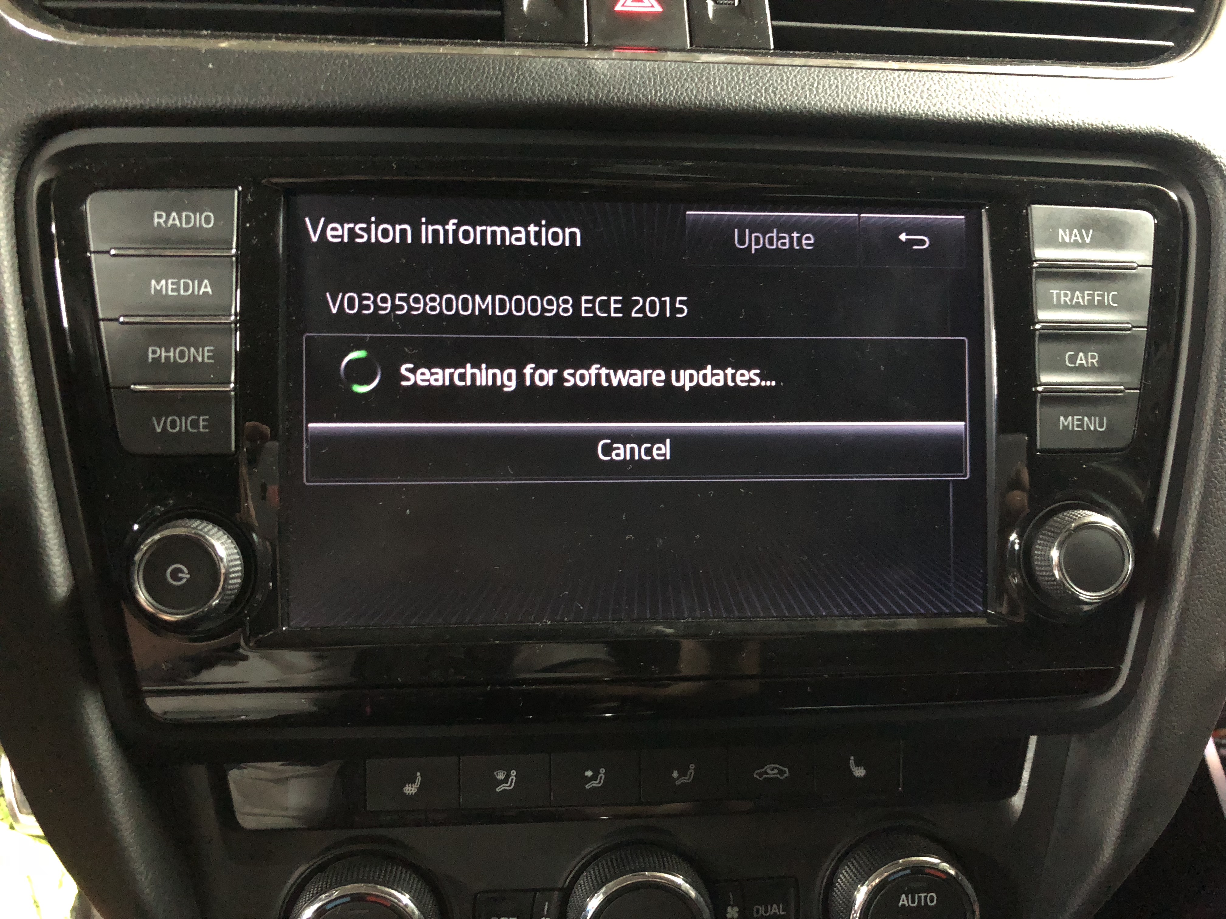

I'm entering the SD card into SD1 port and nothing :(
This is what's happened:
After i read all the posts,..
Edited by chant
Somehow appear option for update Mib1, but a could not press the "START" button. It seems that everything is empty:...
Took the plunge and updated from 0360 to 0411 today.
The sound doesn't seem as thin so could be an improvement.
Media selection seem slicker.
But I had a problem that no matter what I'd been listening to previously I'd turn on and it would play track 1 from USB. It appears the update has not resolved that.
Scanned with OBD eleven and I have the upgrade management error. Will get around to clearing that when it's a bit cooler and I can get my head around it.
