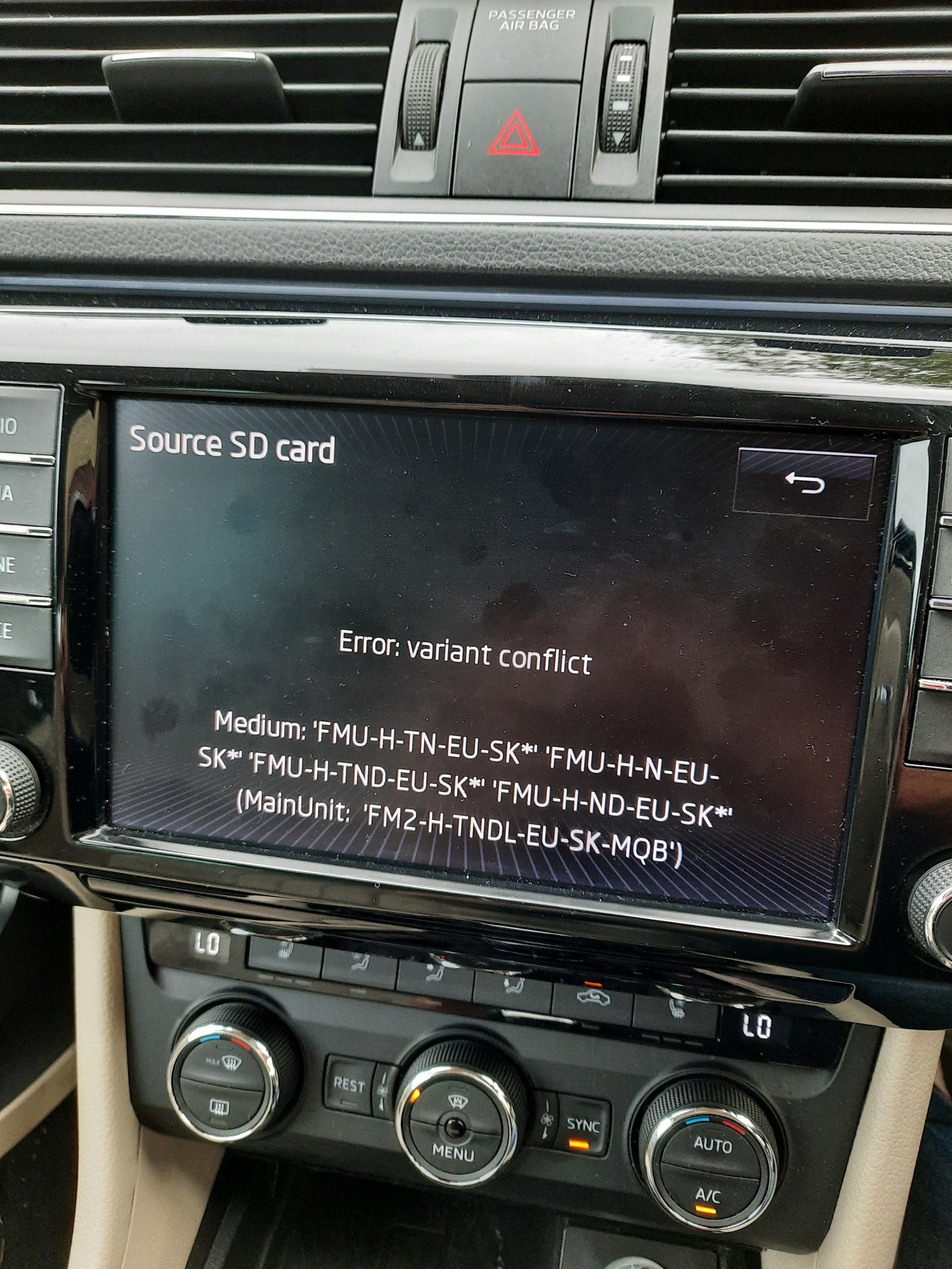

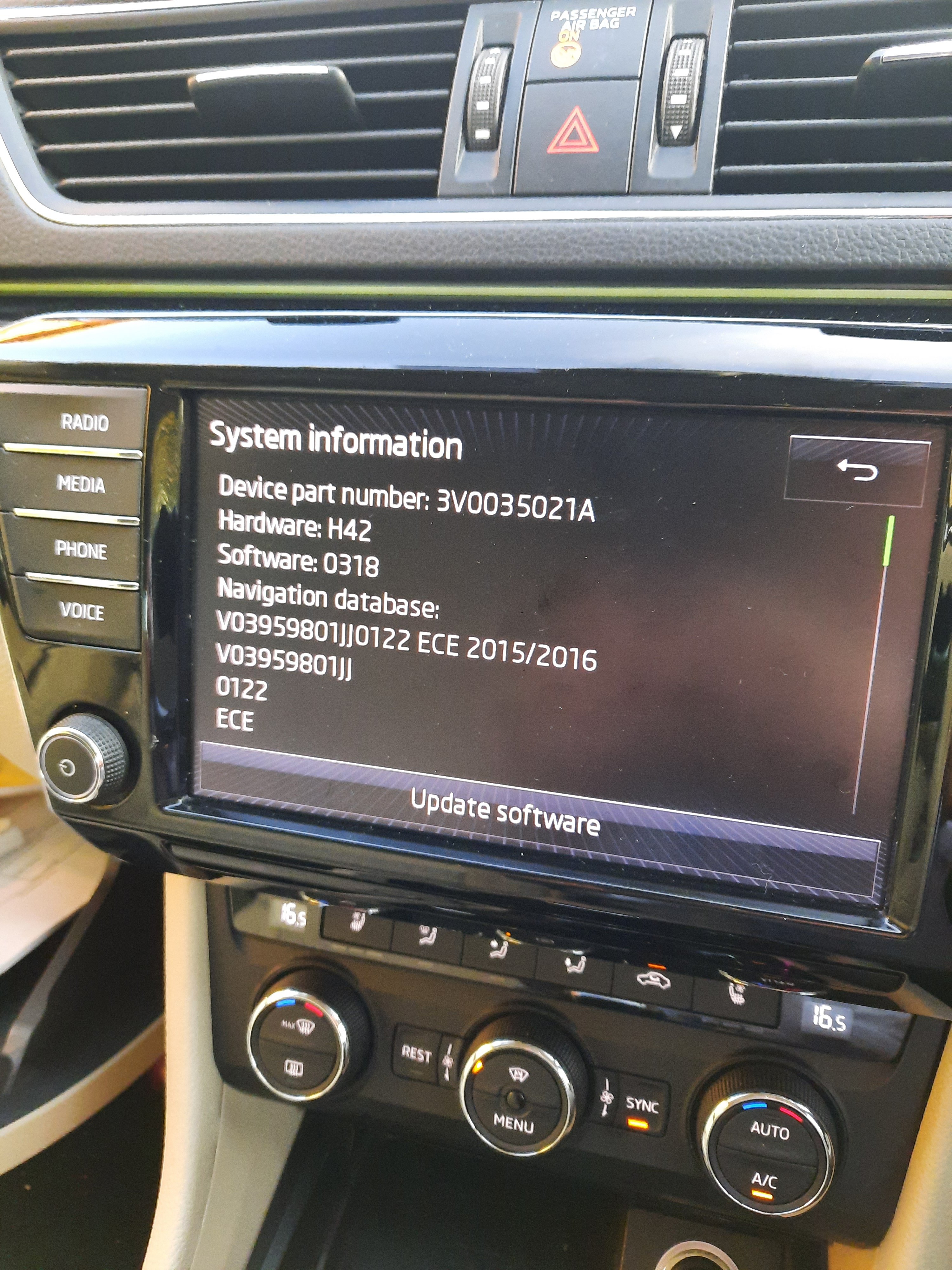

Hi all
Just tried the 411 update on my 2015 Superb
And getting variant conflict . Please see photos. Any ideas please? I reformatted the sd (ntfs)and downloaded agin but still same error. My current software is 318.
Looks like a mib1 as have the dvd player in passenger glove box
