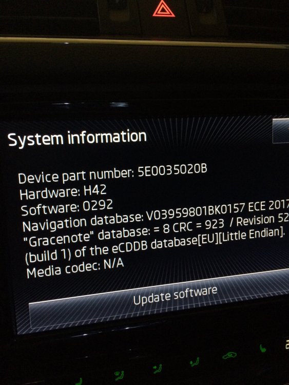

On 2/4/2017 at 12:07, safire said:
SAME PROBLEM HERE Rustynuts !
I just tried to install it, Columbus cant find update data on my SD card, ive got soft ver. 0292
Ive updated my maps from and SD card yesterday and everything was okay.
@ahenners, did you update it from an SD card ?
This is the same system info I get on mine (just picked it up yesterday) except I still have Navigation 2014. What real benefits are there to updating the firmware?Does it give you anymore bells and whistles to play with? A bit wary as not exactly too tech savvy and don't want to knacker it up like it seems possible to do. Navigation update is safer isn't it? How much will the dealer bend you over for if you took it to them to do it all? I should have been a bit more on the ball I guess and insisted Sparshatts in Fareham did it anyway as part of the deal. You would have actually thought a 'proper' Skoda dealership would update all this sort of stuff anyway or their 'approved' used cars. They charge a premium for them as it is.
