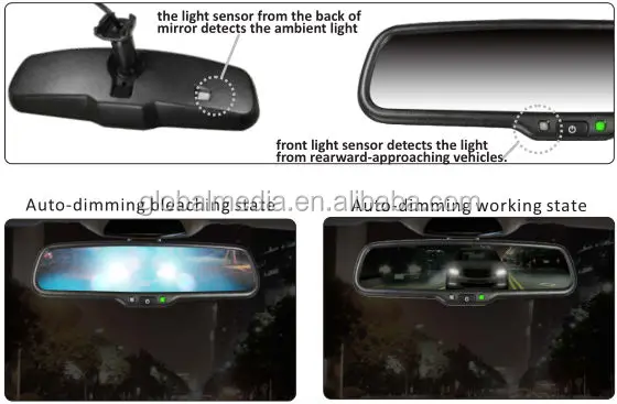

If it is similar to the mk ii version try covering the sensor on the back of the mirror when the light is on and you should see it darken

There are sensors located on the mirror. One facing the front one facing back. Each time the rear one is exposed to light flood and there is an adequate difference measured in the signal from both sensors, the mirror dims with emerald tint (liquid crystal layer I guess).
To test it, shine a flashlight on the sensor (located next to small green led indicator on the mirror) and there should be a gradual change visible. It takes few seconds, but you may see a faster (reverse) change when switching the system off after "blinding" it with light.

Shine a bright torch in the senser in the back of the mirror you should notice the reflection turn blue - obvious I know _ but make sure the senser is turned on first.
Now my question - why would doing this affect the mirror dimming as the light is coming from the wrong direction? - I don't know either but this happens with my mirror.   :wonder:
