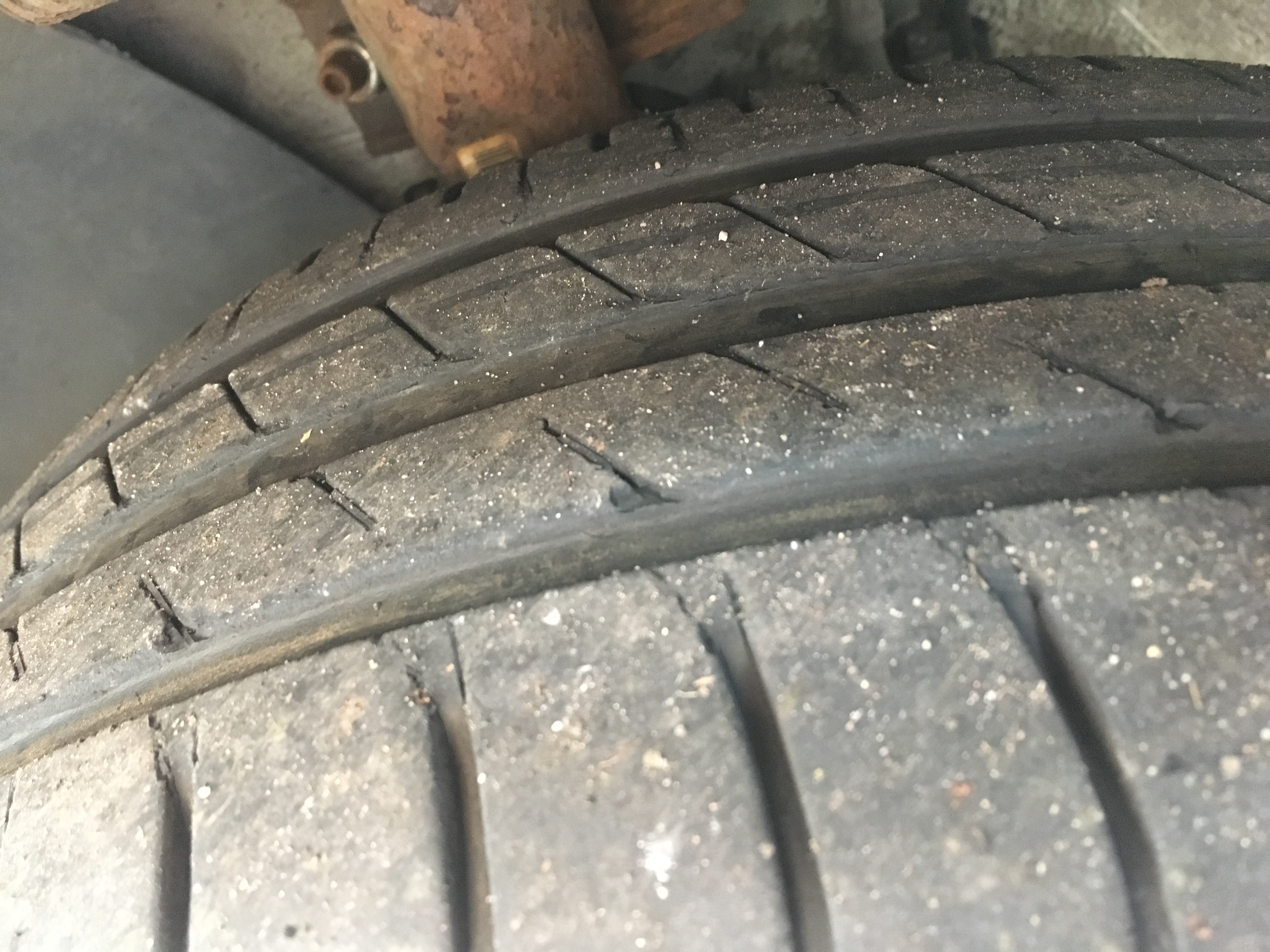

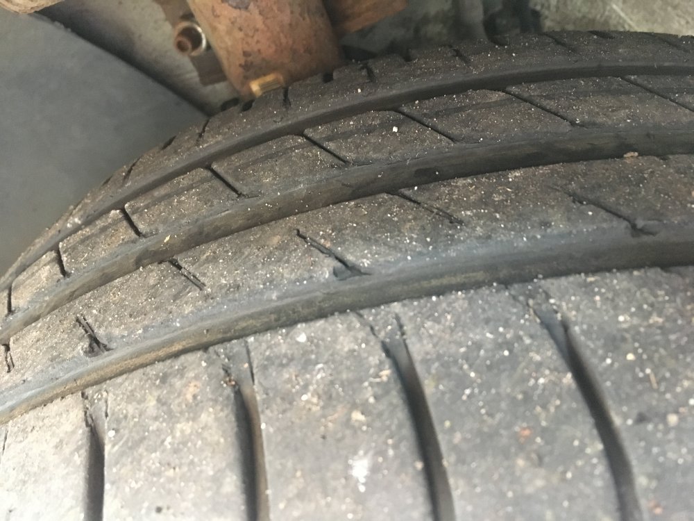

Bit of an update I suppose to say Ive not had such a good experience with these Goodyear's as I would have hoped.
7,500 miles and one is already almost on the limit in the centre. Im not putting the wear down entirely to the tyres, I know the wheel alignment may be slightly out but I think the main reason for the wear is due to the fact the Skoda recommended pressures are too much for these tyres.
Im on 195/50/R15 and have been keeping an eye once a month to make sure they stay at the recommended 31psi but there is just so much wear on the centre part of the tread. The outside edges have around 3mm tread left fairly evenly so Im very surprised at how considerably the centres of the tyre have worn.
I must add I probably do almost  the worst kind of driving for tyre wear in that my driving is 70% A roads stop and start with roundabouts and fast twisty corners. The other 10% is motorway and probably 20% town.
I would still have hoped that a fabia 1.2 wouldn't have worn the tyres this quickly though as it can't exactly accelerate very quickly and the brakes are more to slow you down than stop you.
Something else Ive noticed now they are getting close to the limits are they squeal like mad on certain surfaces, even at relatively steady speeds on moderate bends
Im tempted just to stick a set of cheaper tyres on next just to see whether they last any longer, maybe not Accelera's tho...
Wow, 7.5k sucks, I'm amazed you only run 31 PSI, I too am on 195/50/15 and I run 33 PSI to reduce tyrewall deflection and squealing, I was running full load 36 PSI at the back but have backed it off now due to it being a bit looser in the wet with the RARB, mine are actually wearing on the outside edges at the front despite the pressure, certainly not in the middle. Mine are not Goodyears though because they're not really a grippy tyre.
Bad tracking generally wears out the inside edges incidentally.
Im down to 25 psi at the moment to try and counter the wear so I can get a few thousand more miles from them.
This just makes them squeal even more tho and they feel very soft on initial turn in.
I think its just a case of them not being very well suited to the car, as you said tracking would cause the inner or outer edges to wear which is not the case with these.
Will upload a picture in a bit
Not the clearest photo but you can sort of see the tread on the outside compared to that in the middle...
