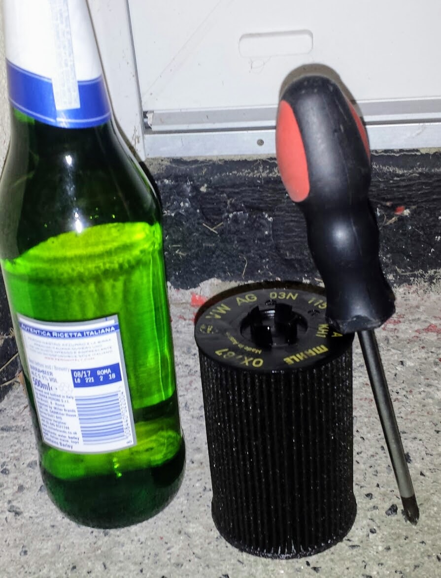

I just had my oil filter changed at 7k miles. Mine is on variable even though I asked for it to be set on fixed. I don't do the mileage or motorway driving to warrant the variable servicing so will have my car serviced at 10-11k miles regardless.
I asked for the oil filter to be returned to me after the change and I was shocked at its size. It was smaller than the 330ml Coke tin and looked shoddy already at 7k miles.
Had to use my laptop to upload a pic of it. You see how small it is. IMHO it seriously isn't up to tackling up to 18k miles, so I'll be changing mine more regularly than the dealer / manufacturer suggests. I'm an experienced mechanical engineer and this is only my humble opinion.
Edited by blahde2
