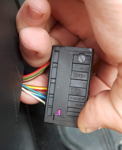

- relay/control module was included in the seats, BUT under the passanger seat (right side). The guy i bought them from (+ climatronic) dismantled a left side steering wheal car, but the position of the relay/control module being on the right suggests otherwise.
- i bought a kufatec loom http://www.kufatec.ro/shop/en/skoda/octavia/1z/seat-heating-cable-set-skoda-octavia-1z-seat-adjustment1?info=7336 without electric seat adjustment
What i did:

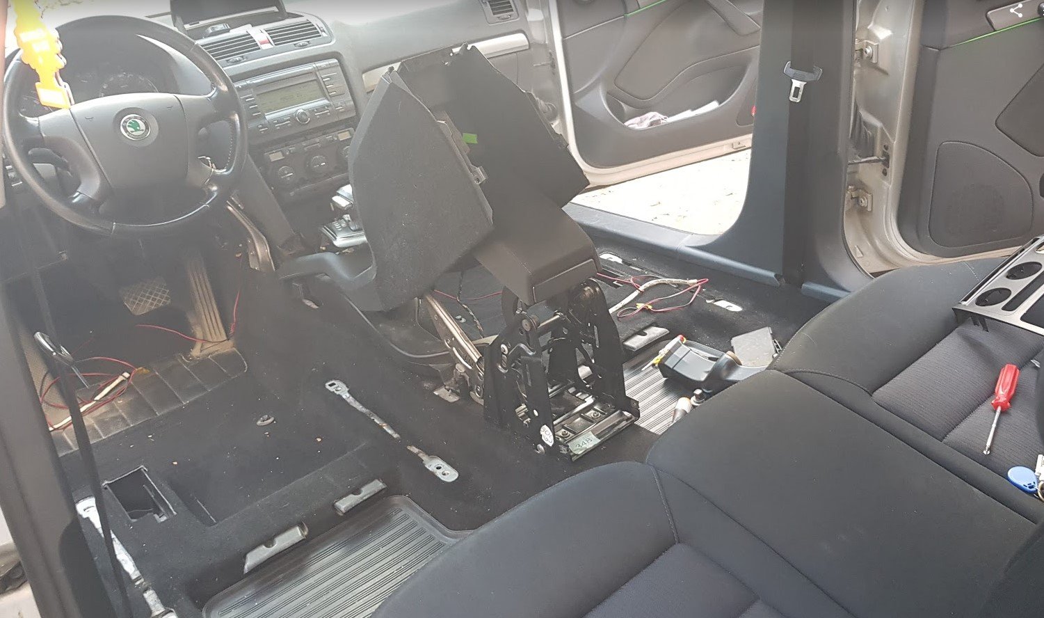

- swapped old seats with the ones with OEM carbon heating. Thy also had airbags and seat occupancy wires which i did not connect to anything.

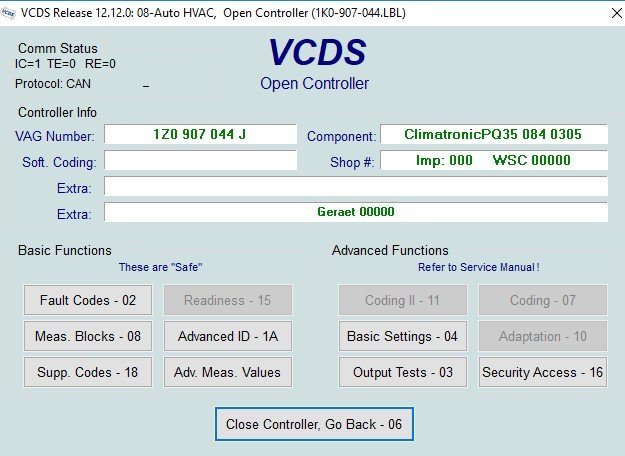

- swapped the climatronic modules (with the one with seat controls 1Z0 907 044 J ), inserted PINs 10,11,12  (pin 11 of the loom was thin double wired and labled blue/red - so for seat with relay)
- I connected the single PIN to CECM > Connector C > Pin 1 (this was so easy)
- i connected the 2 fuse wires: fuse 37> 30A, fuse 7 > 5A and checked, both of then were live with current

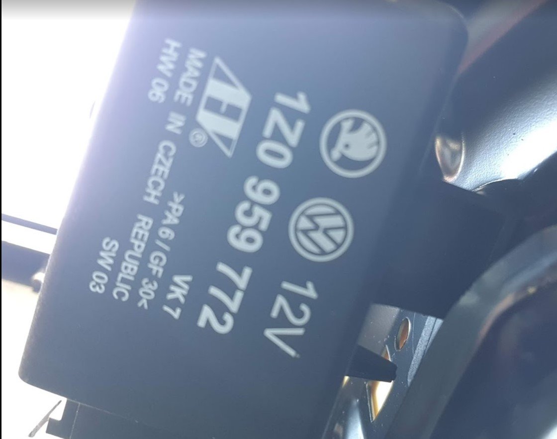

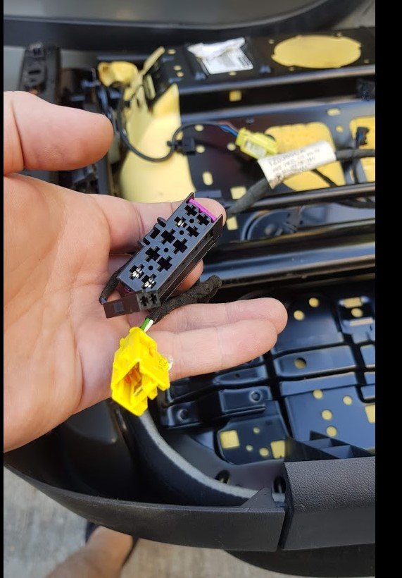

- since my relay/ control module (1Z0 959 772 ) was on the right seat(passenger), i had to extend the loom connector for the relay, 6 wires, with 3 of cabling meters each, matching the gauge (thickness). I ended up with both seat connectors having a 3 meter length of wiring.
- connected 2 groundings near the hood release lever, individually as there were 2 earthing points.

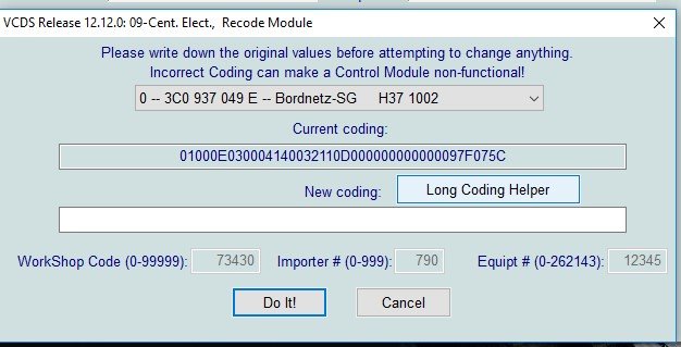

- I get 'Coding Accepted' in VCDS > Cent. Electr. > Coding > Long coding> Byte 2 > bit 7 "enable seat heating". But the setting is not saved. Wen i go back and check, the checkmark is blank.
- I tried reversing PINs 10 & 11 in the climatronic, and VCDS again. Also nothing

If the VCDS coding does not work then I'm 99% sure it is the fault of the VCDS itself.
I had a VCDS (not official) which produced the same symptoms. I was able to set long coding with it only once but never again.
Cracked versions of VCDS 14.xx are known to have this fault.
Try to set the bit with a different VCDS or with another tool (OBDEleven, etc).

You were right on this.
I have a vcds 12.12 interface, and i borrowed one from a friend which is also 12.12
It worked to activate seat heating with his 12.12 on the first try. Strange as it is the same version as mine.
With the help of a multimeter i was able to detect that current from the 5A fuse in the fuse box was not reaching pin 12 in the Climatronic module. The stupid whire will just not stick in the specific location in the fuse box, so i wired it outside of the box with a little improv.

- Keep in mind that my seat heater controller is under the passenger seat like on cars with stearing on the right
- The passenger seat heats up, but only on levels 4 & 5. 1 - 3 doesn't seem to do anything.
- The driver seat is dead however. I measured the cables in the connector under the seat which connects to the seat connectors, the're all good. This connector has 3 wires (Steady +, Ground, and another thin blue wire from the climatronic control). The steady= has 14v current, and when i turn seat heating on from the driver dial on the climatronic i have 14v on the thin wire also. I then connected the large connector in the seat and measured up to both heating pads (back & seat). The current was reaching the wires with no issue, but the heating pads will not heat up. It's strange because none of the 2 heating pads is working, Both seat and back pads are not heating up.
The only explanation is that both pads are fried.

There was no need to extend the seat wires, the loom you have was already left hand drive, it's the same one as I used, all I did to overcome the problem of extending wires is to swap the seat looms over, so now I have the seat relay under the drivers seat instead of the passenger seat, problem solved.
On your set up you should not need to do this?, I could be wrong?
