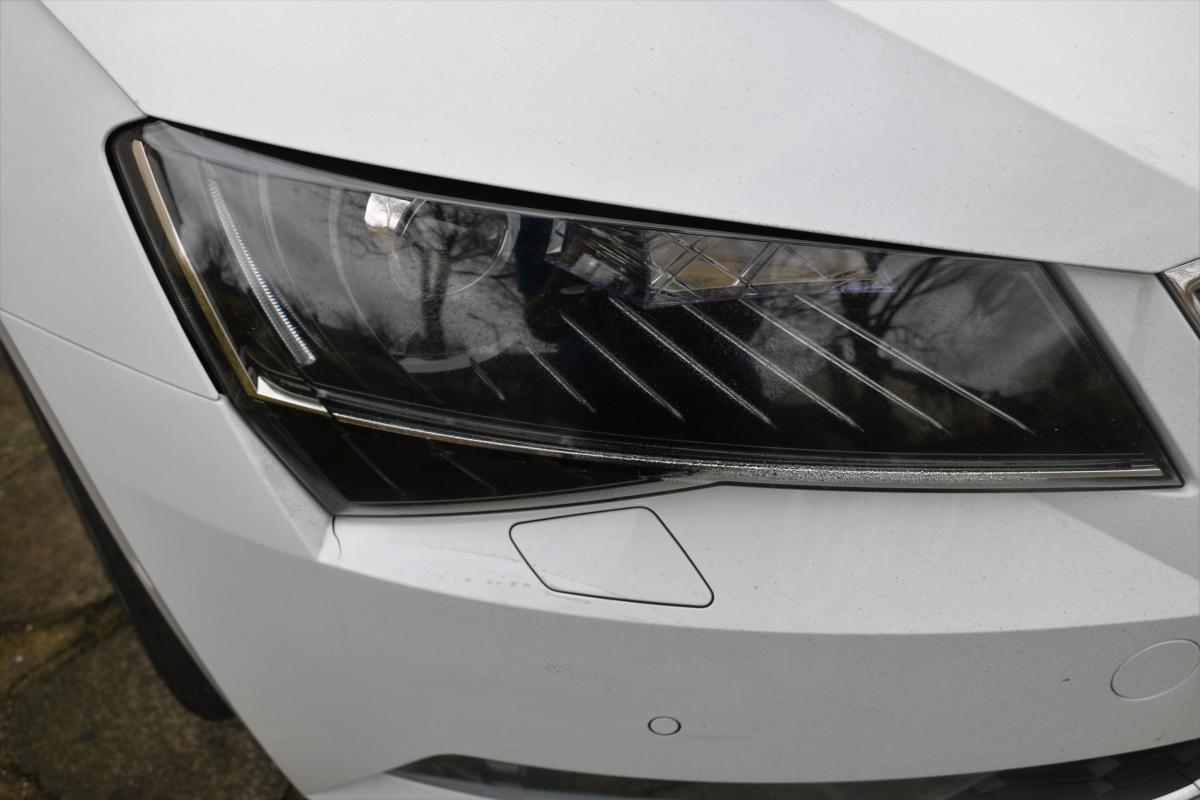

I have subsequently found a crack in the front bumper under the driver's side headlight that I had not noticed prior to the accident and there are no tell tale signs of someone reversing into me so without any evidence to the contrary I have attributed this to a jolt from the accident traveling through the car and cracking the front bumper at a stress point.

That crack originates from someplace under the headlight. Does the corner of the headlight look to be making contact with the bumper? Does the left headlight make contact at the outer corner? Could some other owners check their cars for the same?
so without any evidence to the contrary I have attributed this to a jolt from the accident traveling through the car and cracking the front bumper at a stress point..
If cars were this fragile they would self destruct every time you drove one and hit a minor road imperfection let alone a pot hole.
Its either had a parking knock at sometime or been like it from new.
id say its highly unlikely that was caused in the accident, its either a parking ding or some other defect or damage.
id get it looked at asap though as it looks like it may spread.
Agreed, I very much doubt this is related to the accident unless the shunt from behind pushed you into the car in front?
I guess you've been unlucky, being hit from behind and also having someone else knock the front of your car whilst parked.
