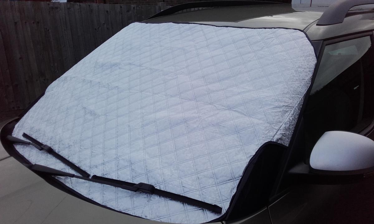

Its arrived and fits really well on the screen so now just need to wait for the next frost to try it out.
But that is just a sticking plaster, it will not fix the problem that is causing the condensation.
Yes maybe, but it only happens in frosty weather and several others on here have reported similar problems even with new cars. I cannot find any source of water ingress and none of the interior feels damp.
I suspect that just heating up the inside of the car just keeps the water vapour in the air as a gas and the cold windscreen condenses the vapour overnight. It only appears on the windscreen, not on any other glass, so maybe water vapour is rising through the screen heater vents?
This morning only half the windscreen was frosted and there was a thin layer of condensation inside exactly where the frost was on the outside.
If the screen cover keeps frost forming it may be the answer. I am prepared to be proved wrong but it seemed like a good idea anyway to save scraping.
