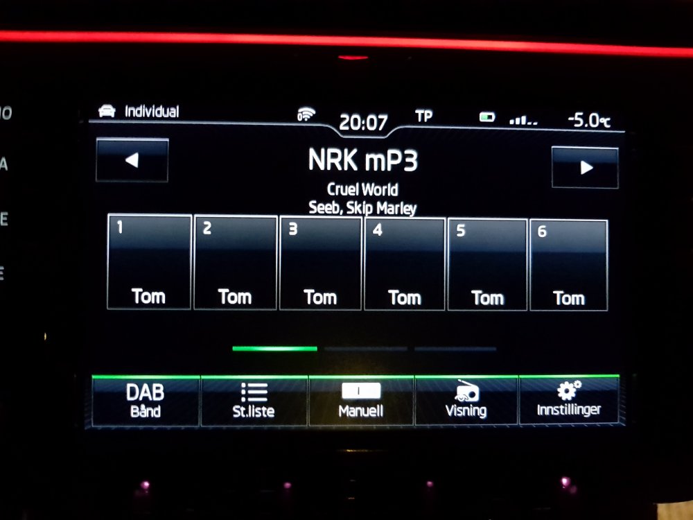

Happened again, 11 months since last time.
Had been driving for 30 minutes, parked for maybe 10-15 minutes, drove off, radio went on with ignition as usual, last radio station playing, but all DAB presets gone.
All FM presets,  on the other hand, are still there..!
("Tom" is Norwegian for "Empty", by the way)
