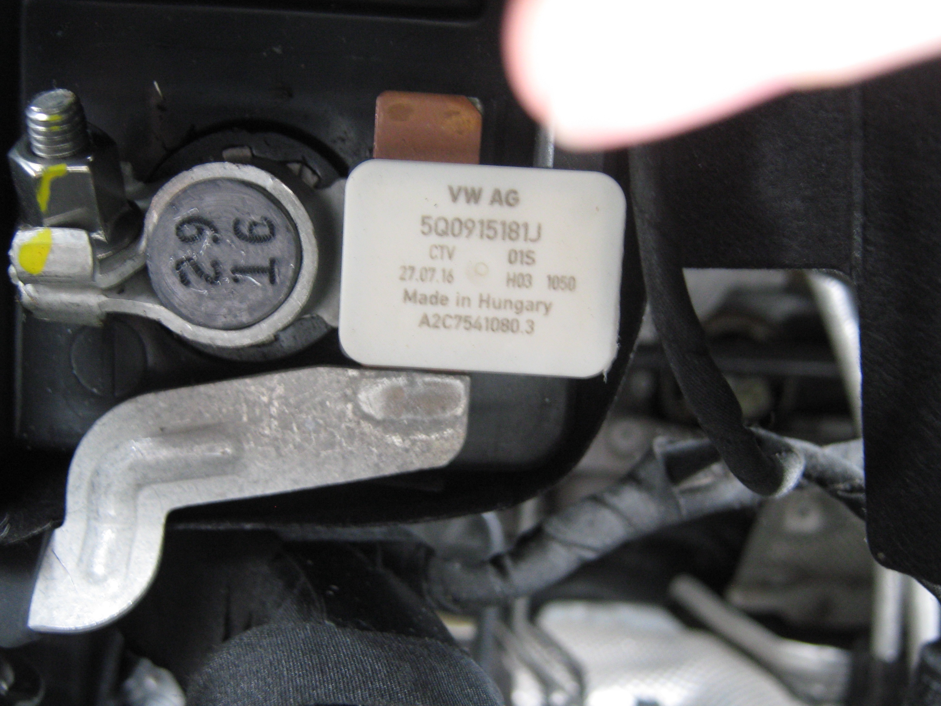

Is this the battery monitoring module? or is the battery monitoring module buried deeper in the system?
That is identical to the one I specified in my Construction Eqt days - Hella or Continental were the 2 we developed with and I think we plumped for Hella in the end.
