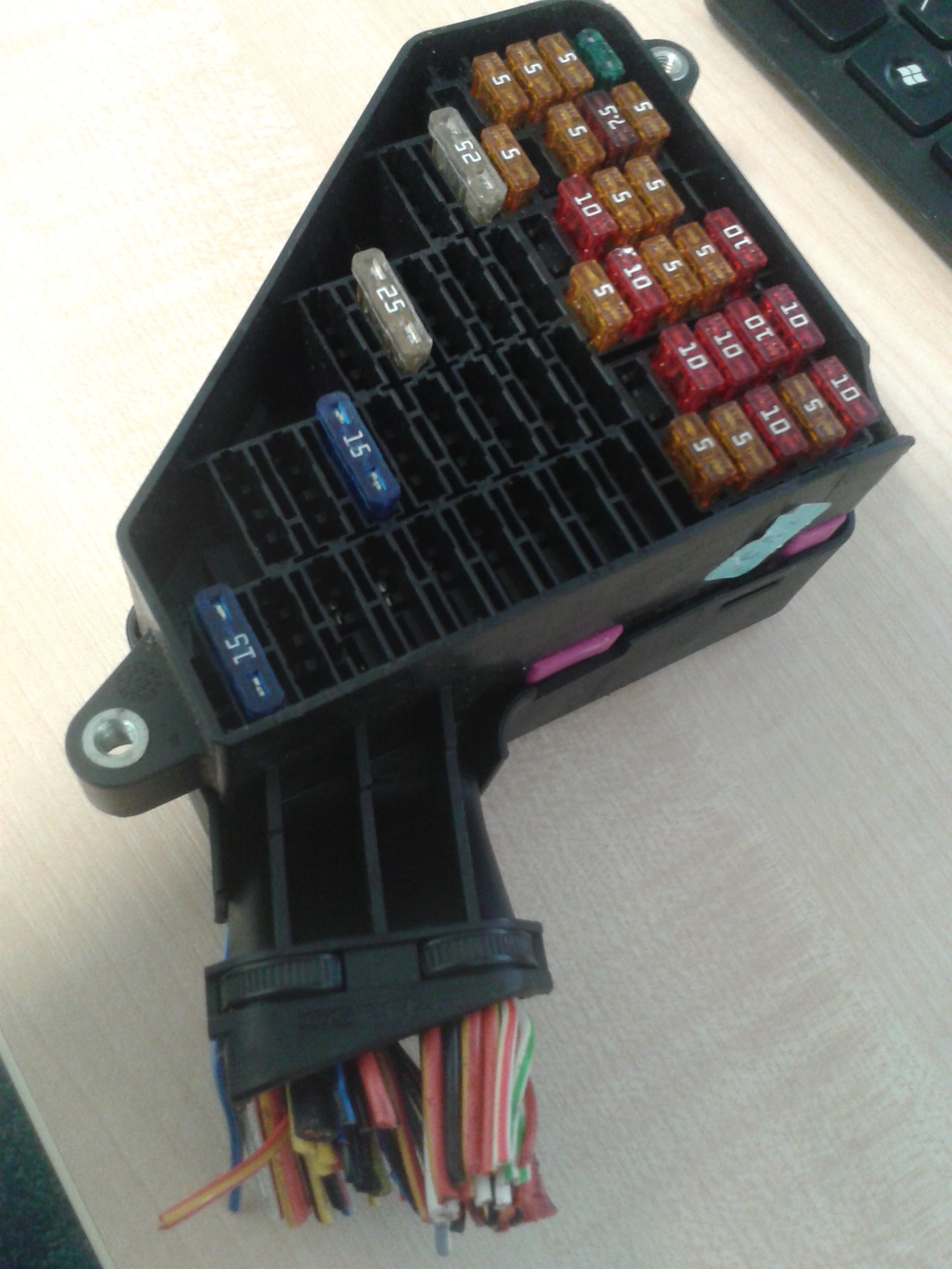

I've got a spare fusebox somewhere, with wires hanging out of it. If I can find it I'll investigate and potentially have some healthy wires/contacts I could send you.
PM me a reminder tomorrow.
Wino your a bloody star :biggrin:
  • Sponsor
I found it, after tidying my shed a bit!
I've extracted the two relevant wires/contacts, have taken a few photos which I'll pop up in a bit (gotta walk the dog).
  • Sponsor

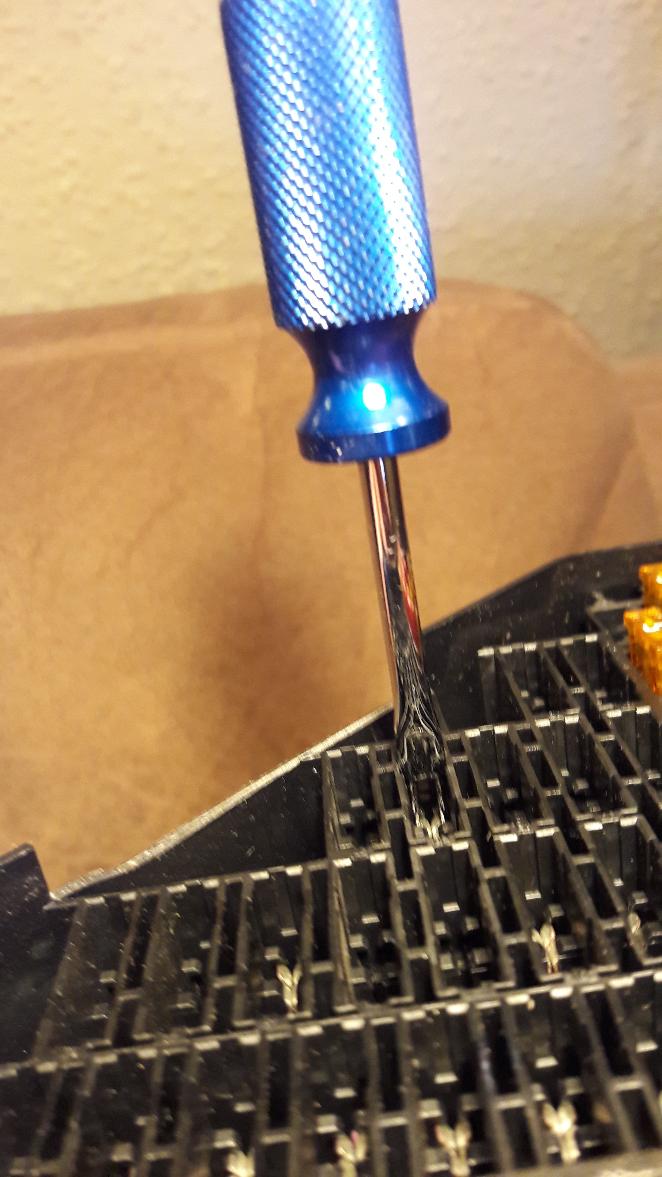

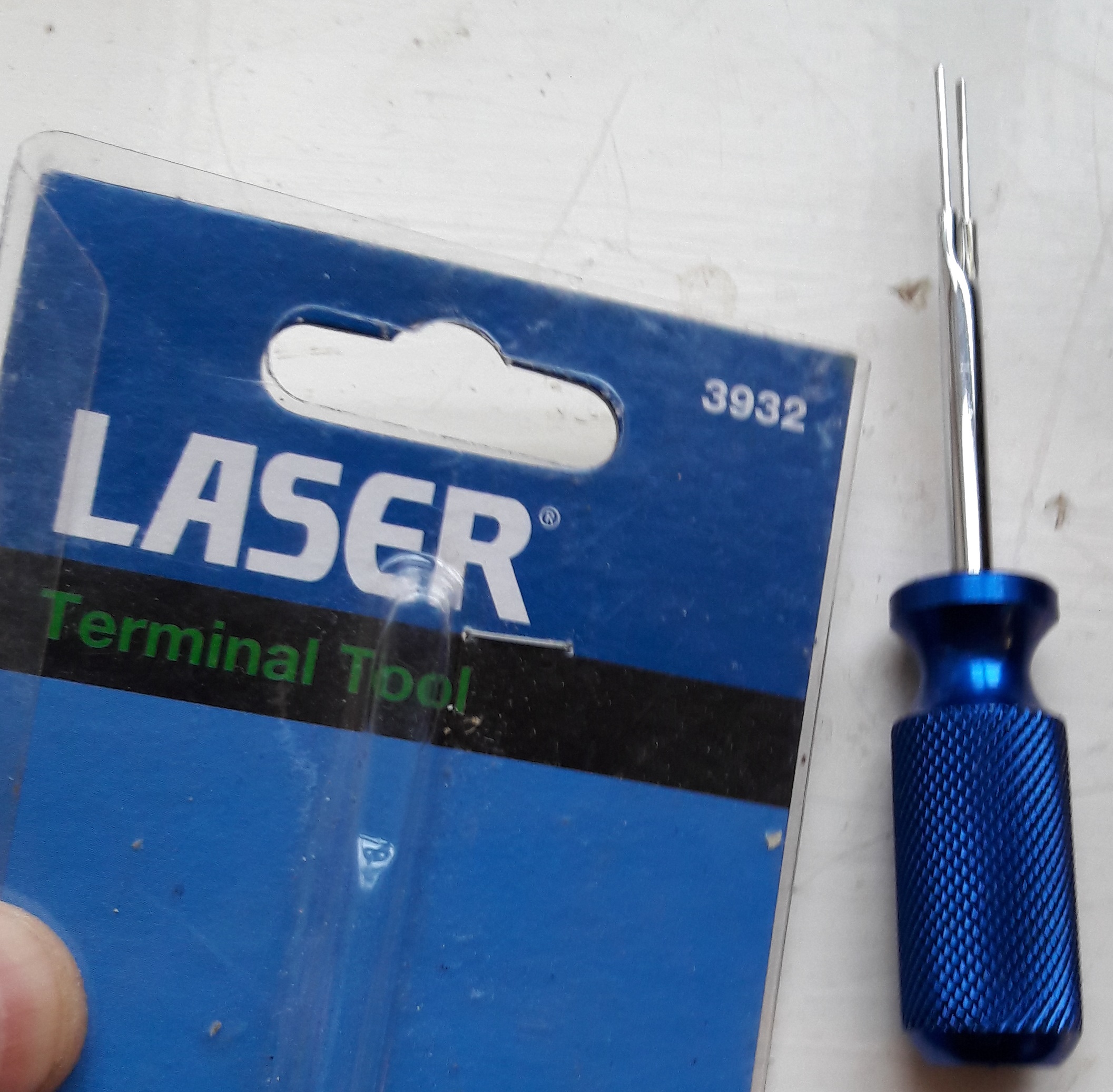

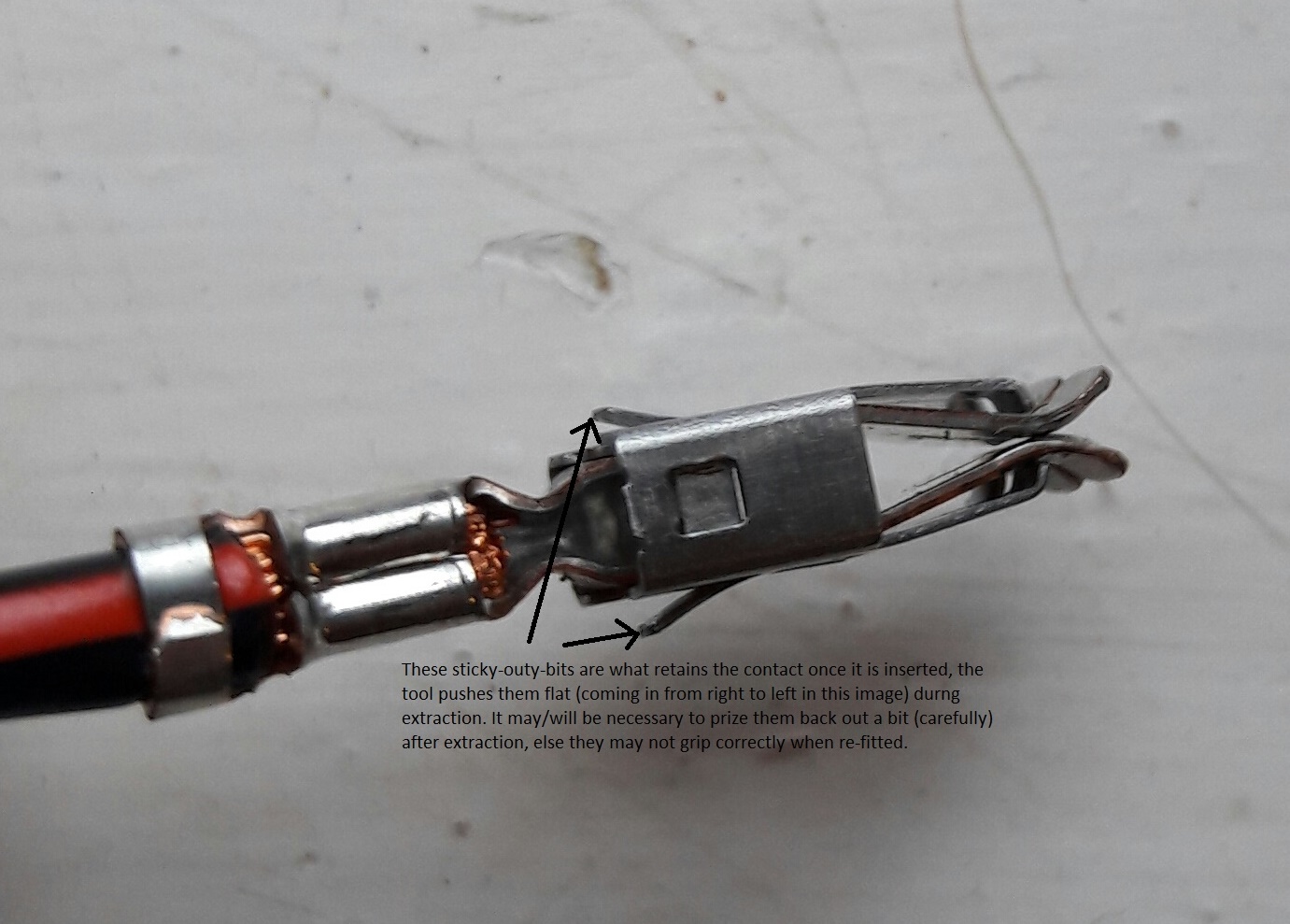

Take one fusebox (this one's actually from a 9N Polo, but same enough I think), one Laser 3932 extraction tool, poke tool into holes above and below the contact you wish to remove while pushing the wire in towards the tool from the other side. Out pops the wire and terminal, undamaged.
Fingernail the two retaining thingies outward again before reinsertion.
Let me know by PM if you want these two wires, with a delivery address.
