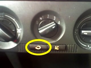

First, turn on the fan, and set it to re-circ. Once the re-circ's come on and the fan starts to blow harder, turn off the ignition (just to be on the safe side!) Doing this will open a flap on the back of the fan that lets the air from inside the car back into the fan inlet - more on this later:

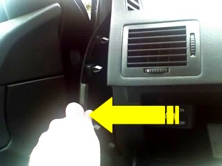

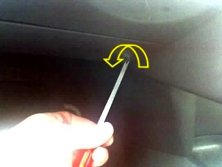

Next, open the passenger door and the glove compartment lid, and push off the D-shaped bit of trim down the side of the dash:

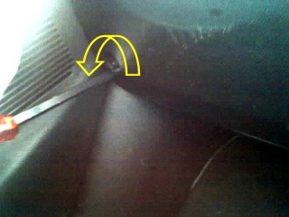

Close the glove compartment lid again, then undo the two screws underneath the dash, just behind where the glove compartment lid hinges down:

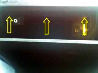

Now, use your knee or foot to support the glove compartment unit, open the glove compartment (again!) and undo the three screws along the top edge:

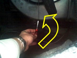

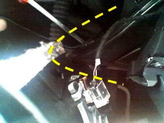

The glove compartment unit will now drop down, and you will be able to see the fan housing in front of you. If you reach right round the back, you can get your fingers inside and pull out any leaves stuck in the fan blades. Turn the blades round a couple of times to make sure you've got everything:

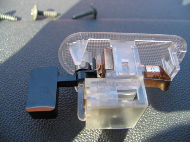

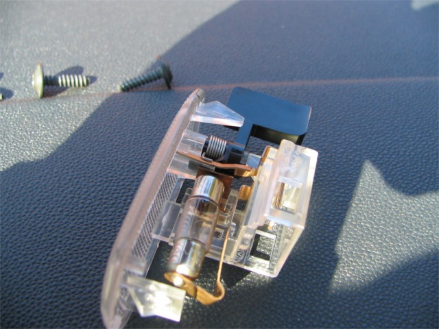

Further to the above, I've had to do the same on SWMBO's car, and managed to explode the lamp holder for the glovebox. Here's how it goes together - note the way the spring goes (just in case it happens to you! ;) ) Hope the pics are good enough for you to figure out what goes where!

Top man these pictures also help me re assamble my glove box light after i took it out in several bits :thumb:

Thanks a MILLLLLLLION for these pictures.    I just had mine explode on removal, and I had NO idea how to put it back together.   I was resigned to buying a new one until I came across your pictures.  I did work out that the trick is to get the spring onto the black arm first,then tension it and put it onto the body, then put the lens back on making sure that the copper contacts go into their correct places in the lens.
Works a treat now.  Saved me  ££££££££'s.
