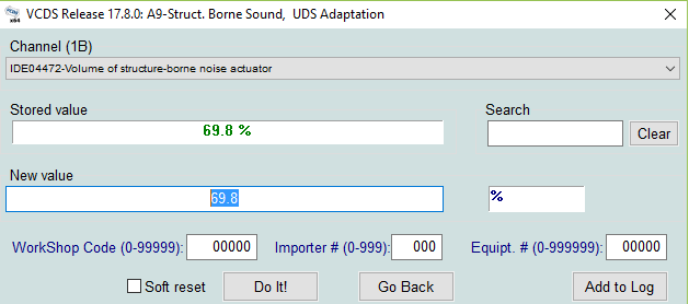

You can using VCDS or OBDeleven. With that said, I can’t remember the default settings so it may be at max anyway. There is no ‘11’.
IIRC the default max volume on my FL 245 was about 70% so theoretically it can be turned up. Not to my taste at 1% however, but each to their own.
Edited by juan27
add vcds screenshot
