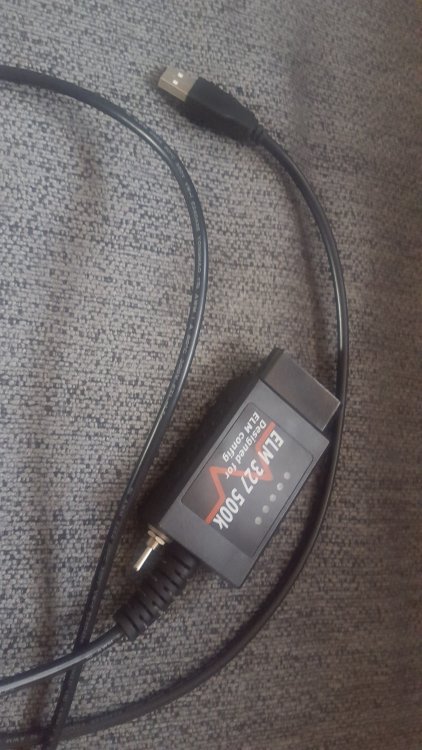

Hello,
I have my old cable which i did use with ford. Will that be ok with skoda? please see attached pic . If yes where can i get basic program running on win 10 ?
Many thanks

Unfortunately the best you'll get out of that is basic OBD2 access, i.e. basic errors etc.

You'd be able to run generic ODB2 applications on your computer however for approx €50 you can purchase an OBDEleven bluetooth dongle and with an Android tablet or phone, you can run diagnostics and make adaptations on your car.
I purchased a cheap knock off VCDS cable for my old Fabia which was perfect however for MK3 Octavia's you need the correct HEX+CAN cables from RossTech or OBDEleven.
