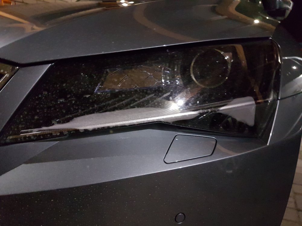

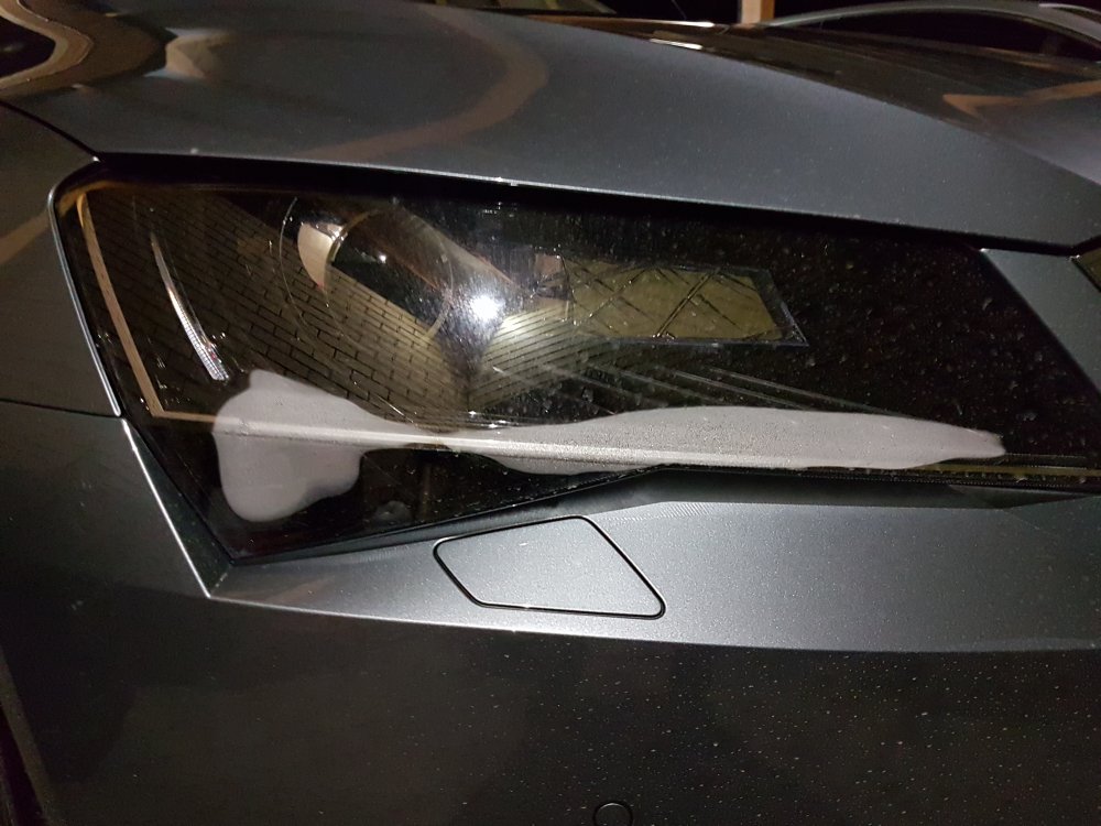

I know this has been raised a few times now, but is anyone suffering with condensation inside their headlight lenses to this extent?
I've never had a car with steamed up lights quite this bad. SWMBO's Yeti is fine in the same conditions. I'm beginning to suspect a fair bit of moisture is getting inside as it's always worse for a few days after the car been driven in moderate rain. Both lights are the same.
I even pumped some dry nitrogen gas through the light fittings in an attempt to dry them out. It worked for about a week and came back after driving through rain.
I understand the ins and outs of moisture, condensation, dew point etc. But this is excessive.
Anyone had their lights sorted under warranty? All things aside, it makes the car look really crap.

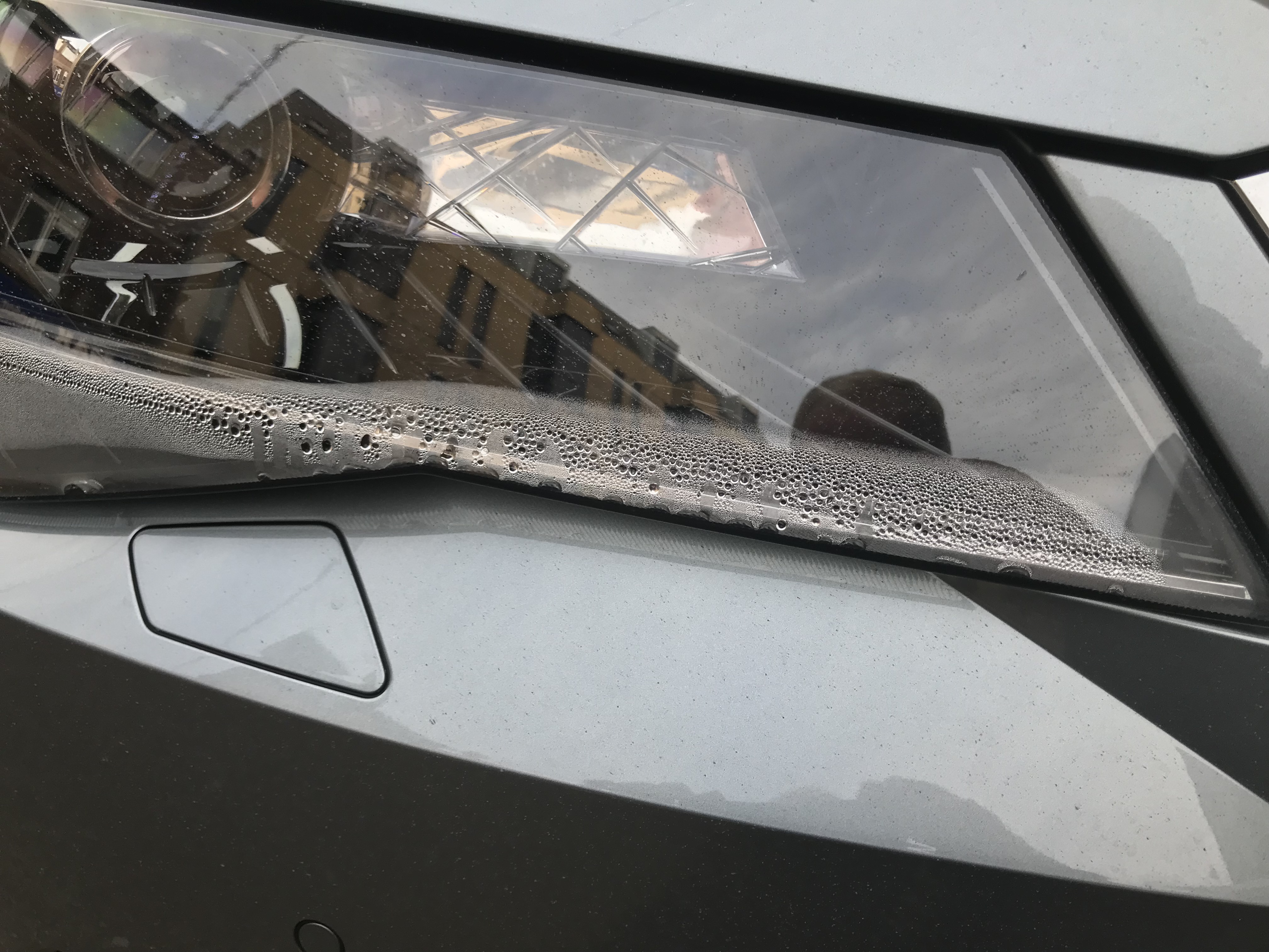

I must admit, that this is really something new for me. I got my car today, got home in slight rain and both headlights have fog inside.
I have never seen fog inside of my Superb MKII headlights (also dual XENON headlights). Also i have electric VW e-Up (got it as new) and haven't seen any fog in her headlights, but those are halogen lights.
There is possibility that this comes from fact, that car was prepared and washed indoors and overall moisture in this room was significant. I also noticed that after one hour all windows from inside of car had same kind of fog/moisture. But this leads me to believe, that those headlight are not very airtight and sealed.
Time will show how bad this will be.
