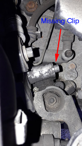

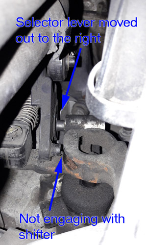

In looking at it a second time (properly), I've discovered that the gear selector lever seems to have lost the clip on the end, so the whole L-shape piece moves left to right meaning if it's moved to the left, you can't get the selector to go into 5th gear.
In the diagram, I'm talking about part no 4, which has lost clip no 3 and therefore moves left to right.
Here's what it looks like on my car without the clip:
And what it looks like when it's moved out of place, meaning you can't select 5th gear:

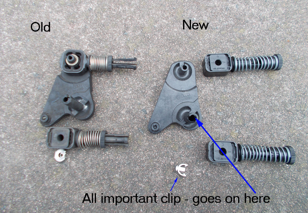

So I ordered the parts:
5K0711203 - relay lever
N90815903 - washer (for the bottom of the two cable ends)
1K0711761B - cable end catch (bowden) - for the bottom cable
1J0711761B - cable end catch (bowden) - for the top cable (although I got two of the first type in the original order so had to re-use my old one initially)
1K0711522 - clip - the bit that holds the relay lever into place, without this I was struggling to select 5th gear.

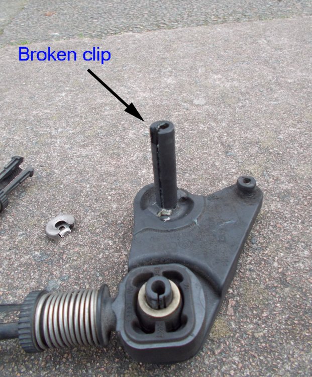

Here's the old relay lever, note the broken bit where there should be some form of plastic clip to stop it sliding out.
New vs old parts

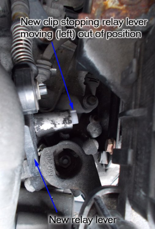

And fitted:
Fitting is pretty simple:
1) Pull springs on cable catch ends and twist to lock (as per gear shift reset procedure)
2) Unclip cable catch end from relay lever (top cable)
3) Unclip metal clip holding bottom cable catch end on the shifter
4) Pull both cable catch ends off the cables
5) Pull out relay lever to the left
6) Insert new relay lever, attach all important white clip to the end
7) Attach new cable catch ends to the cables (compress the springs and lock in place before doing this)
8) Attach bottom cable catch end to the shifter and attach metal clip to hold in place
9) Attach top cable catch end to relay lever, this just clips into place without a metal clip
Everything should now be back in place and moving nicely.
10) Perform the gear shift reset procedure (as per this video: https://youtu.be/eeOoDJuhSx8
11) Test drive.
Job done.
