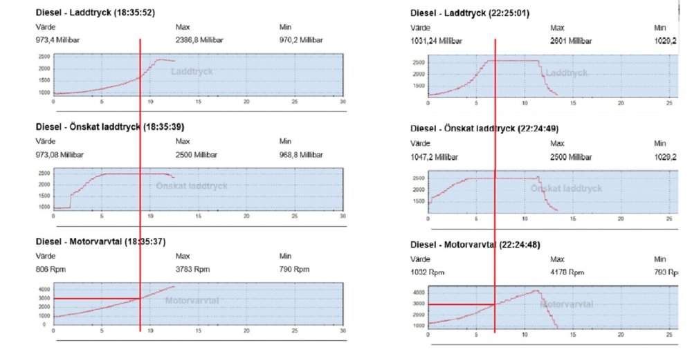

Has also logged boost with Autocom and it looks undeniably slightly wrong.
To the left is the curve I get now and to the right is the curve I got when I had problems with stutter (I have no curve to look at from when the car went well).
Both runs I started on third gear and 1000rpm and gave full throttle, at just over 3000rpm will the boost pressure peak that I can feel when driving as well but as one can see  I should have significantly higher boost pressure before. At 2000rpm.
The question is can it be map sensor is malfunctioning, even though I cleaned it? Or is there something else I should check out? Can add that I have runned with leaking EGR cooler for a while so was quite a lot of water in the intake pipe of the intercooler and there is where the map sensor is located , therefore I am a little suspious that it can be a problem with map sensor.
Egr are now plugged but not  reprogrammed can add that the intake manifold is replaced to one without the infamous troublesome swirl flaps.
On the picture with the test with autocom the two top curves stands for actuall boost pressure, The two in the middle are for requested boost pressure and the bottom curves are for engine rpms..
These can be tricky to get to the bottom of. Certainly that graph is very low on actual boost until very end of cycle range.

Could also be a diverter valve not holding boost but achieving boost at end of cycle may exclude that.
