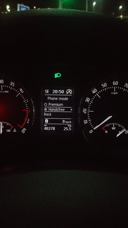

Mike  it's in maxi dot  settings select. ,  phone  settings,  phone  mode.premium  or hands  free,  select  hands free will  not work  in premium

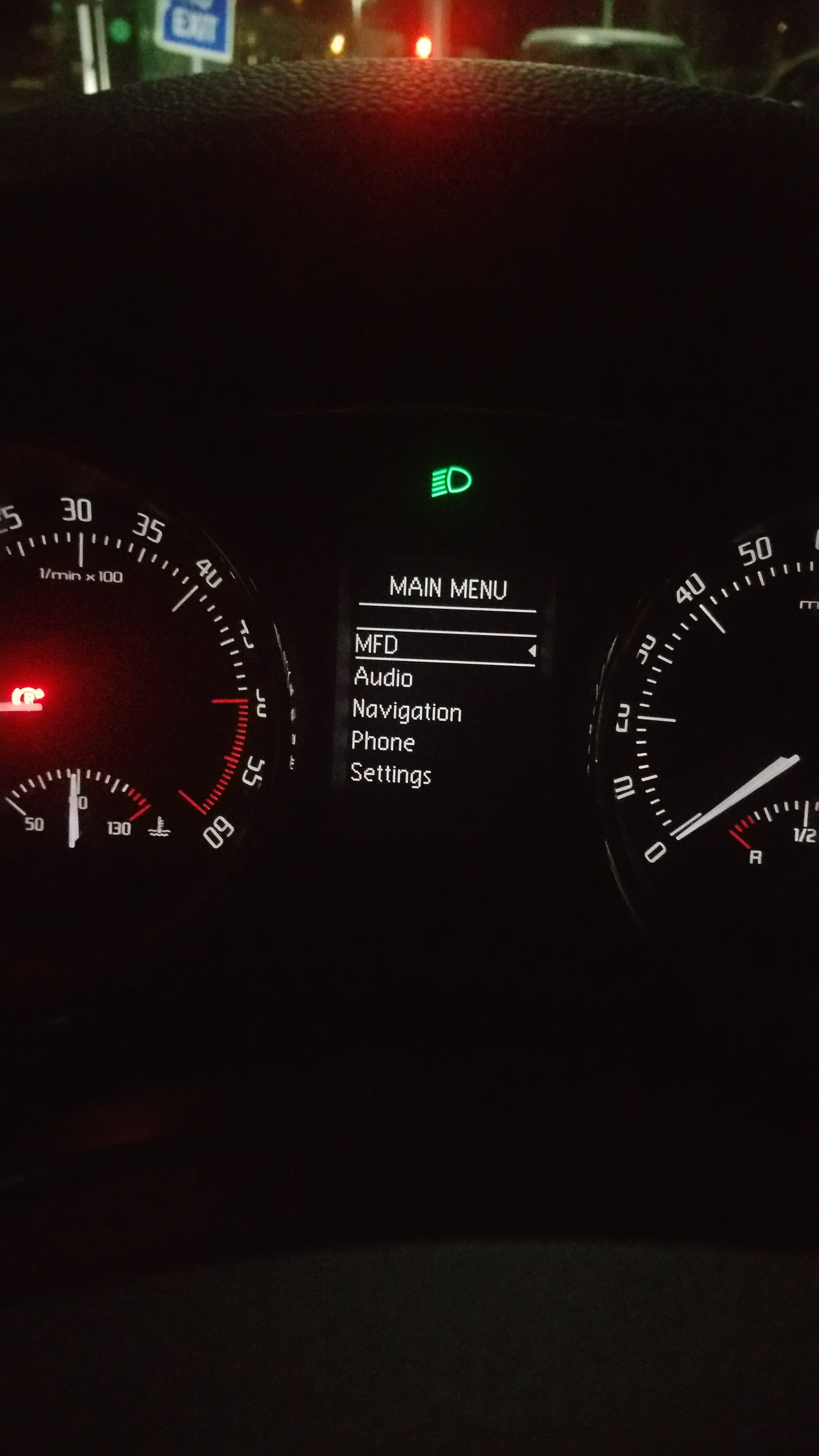

Do you have an L&K?
Have  you  got full maxi dot  it's between  the  speedo and rev counter,  the controls for it should  be on your  steering  wheel  ,  it should  show  you  in your  manual, your  columbus has nothing  to do with  it
2 minutes ago, skippy41 said:
Thanks for posting.  Mine looks different.
List is
Driving Data
Assist Systems
Audio
Telephone
Vehicle
All the telephone option does is bring up a call list, and the manual says is what should happen
What is your Superb type?
Mine  is the  last  flowers 2 version,  scroll  to phone  .press  the scroll  wheel  and other  options  open
