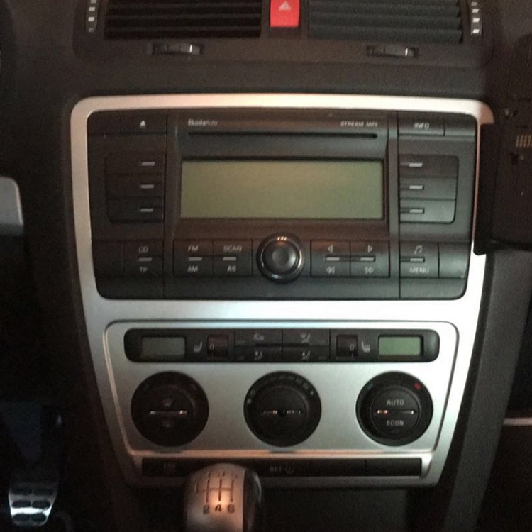

I own a Skoda Octavia II from 2006 and I am thinking on buying a new head unit. My car have Maxidot but does not have steering wheel controls.

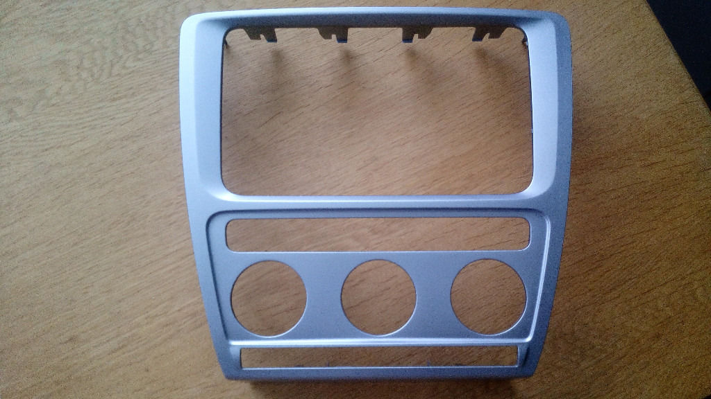

My guessing is that they only pay attention to the hole the hu goes in, in case of Skoda is wider than the rest of the vw group, being 258mm wide. They do not know that there is a fascia front plate (1Z0858069R2AU) that adapts the original radio (Stream) to the Columbus RNS510, which is around 218mm wide.
