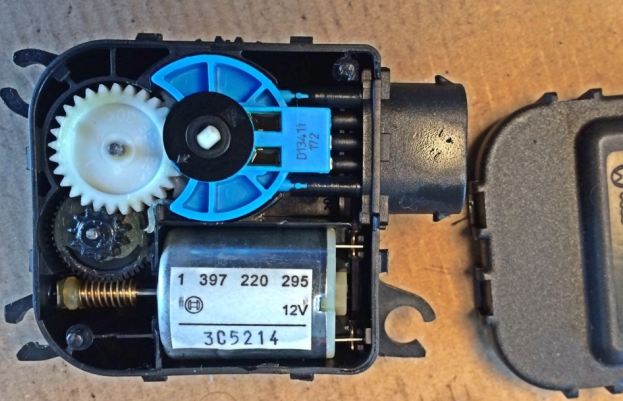

To day I will fix the heater. It is very unstable! The air is mostly to warm.
I vas reading about inside her, ands get some good info.
Dos anyone know the resistant of the regulator? Ohm?
I will try to put inn a standard potentiometer ..?
If it is possible?

The regulator for the heater: 2qkuixu.jpg
And now?
Best to by a new one?
There is a potentiometer behind the regulator on dash also. A little mini one.. (not the car) Can this make trouble?

So I clean the pot with whitespirit. Hope the best...?
Is it possible that something is wrong with the hand operation part on the dashboard?
There is also at pot meter ... that control the other pot meter?
I will put things to gather to morrow, go make a manual control?
