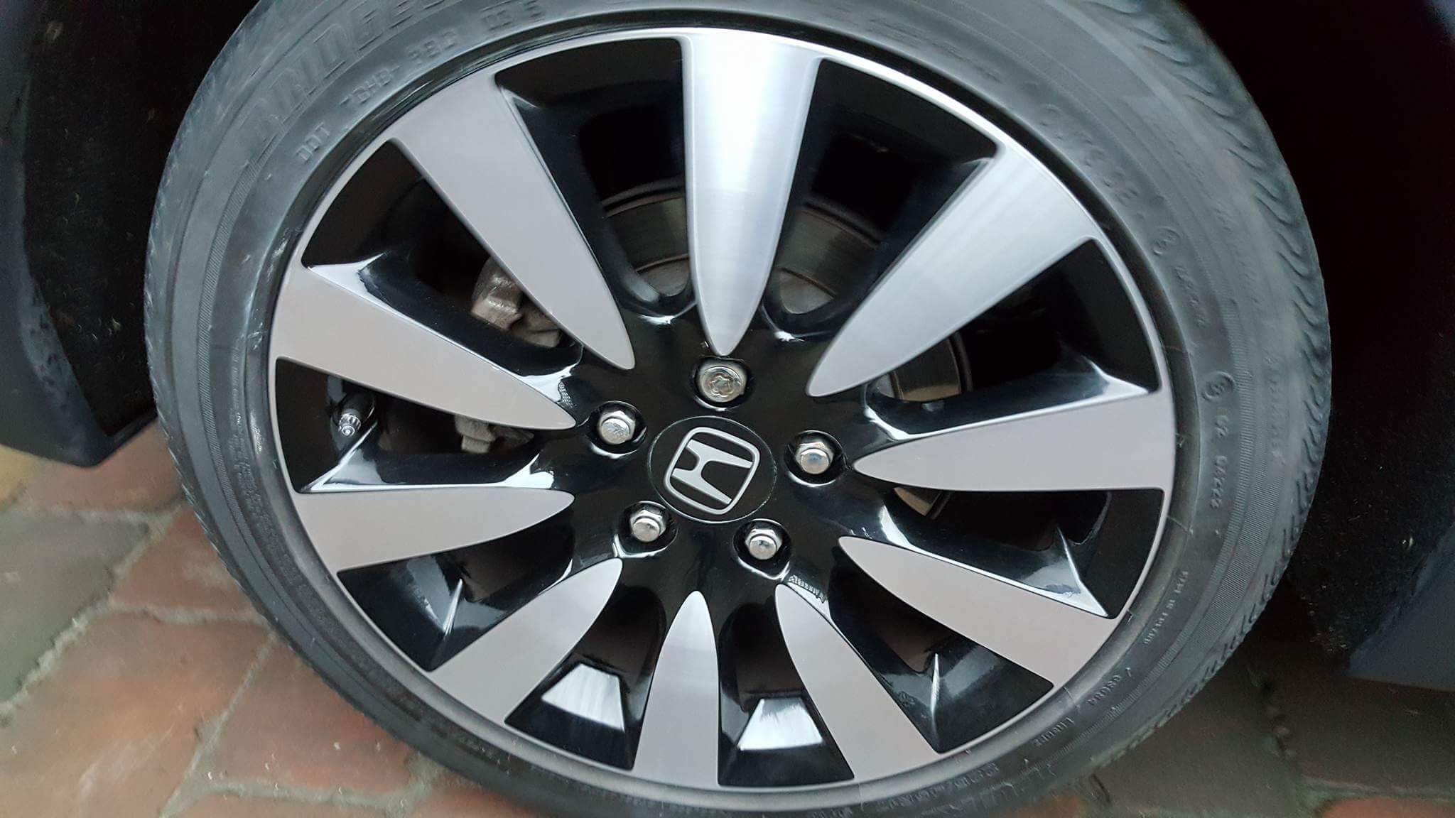

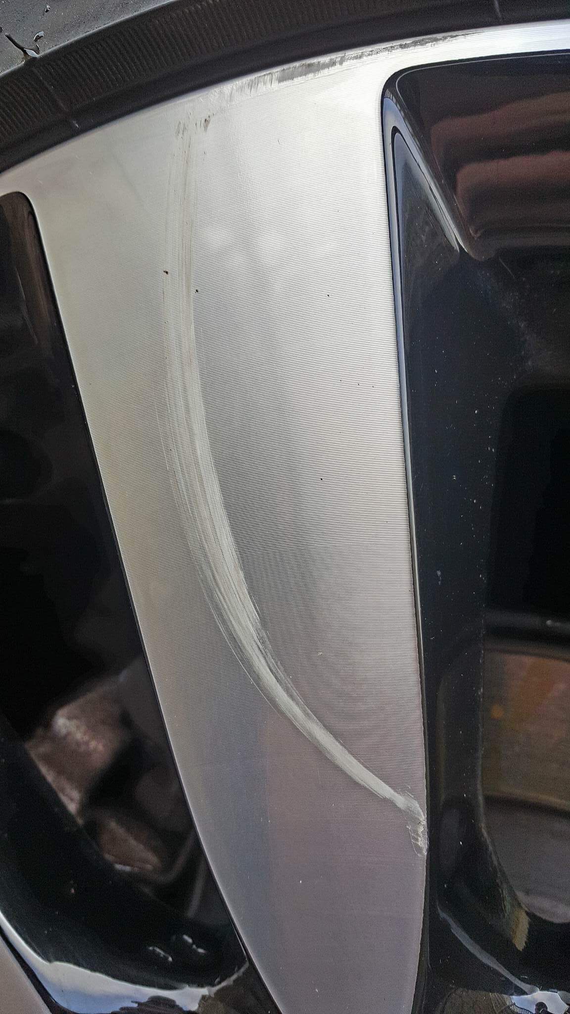

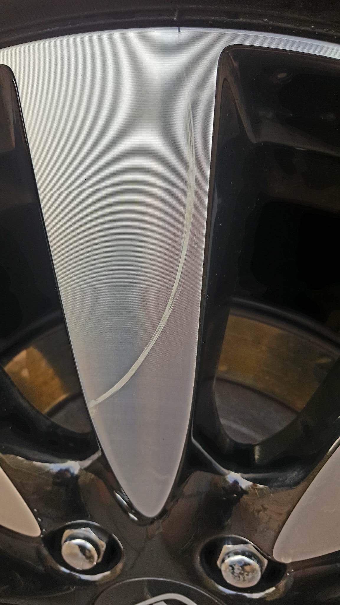

Parents Honda diamond cut wheels got scratched, went to a local tyre and alloy repairer and he managed to polish them out. Great service, can no longer be seen!
Before;
After;

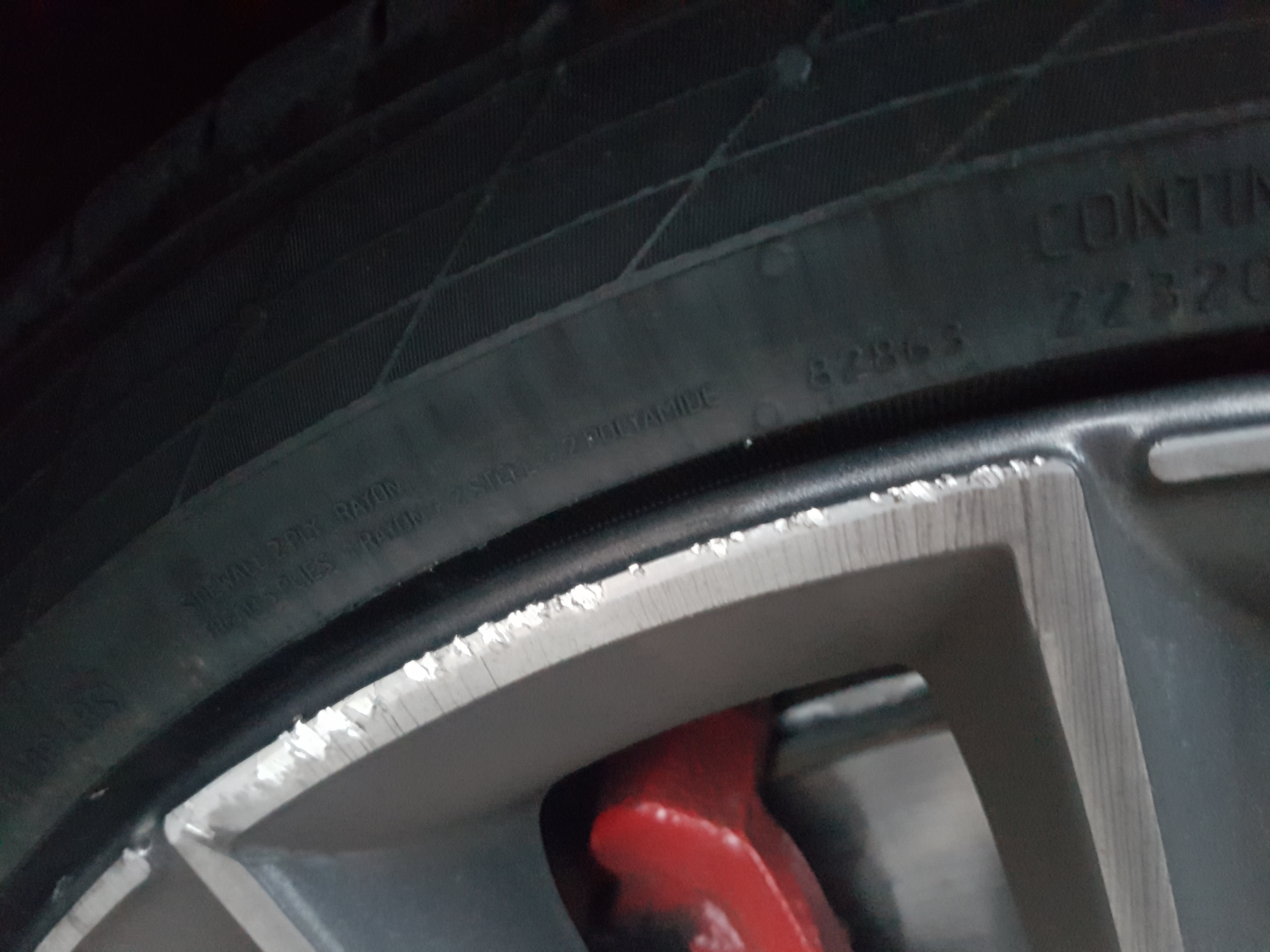

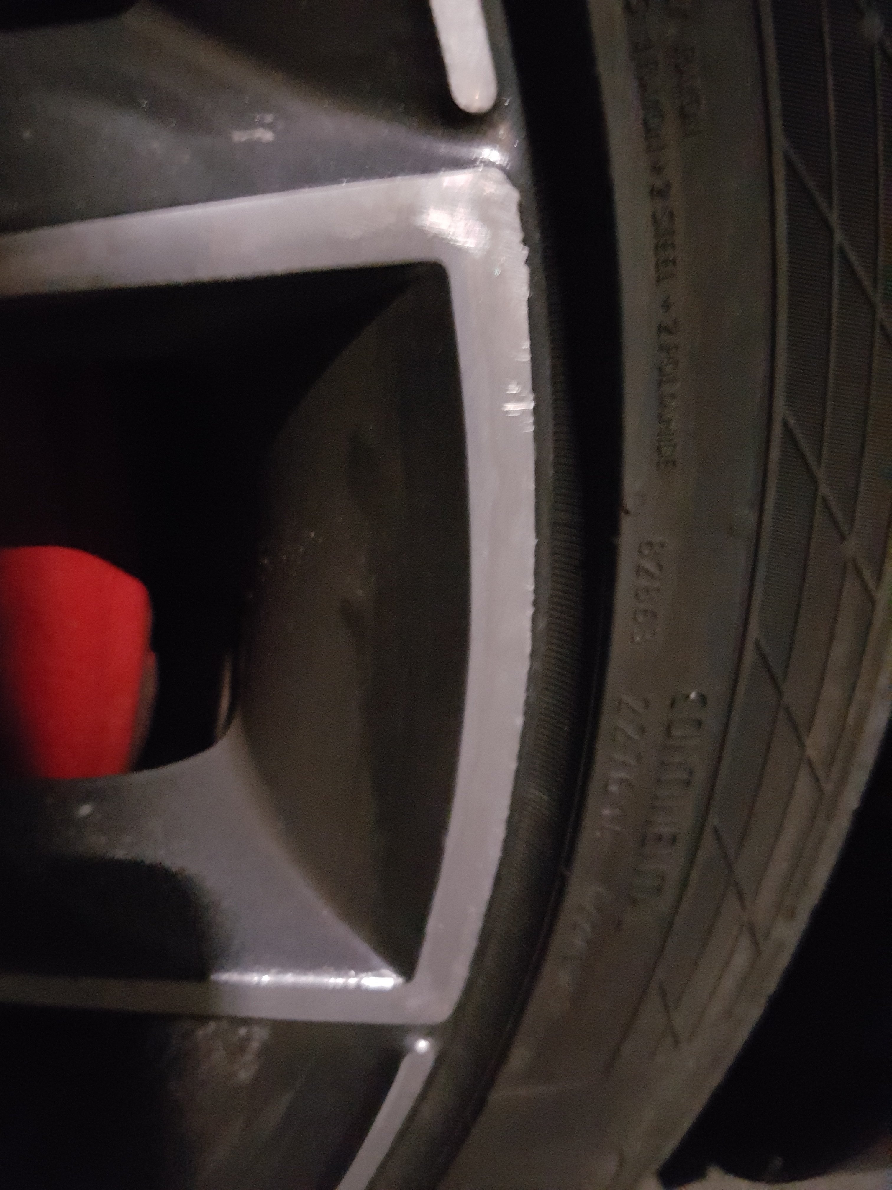

My vRS had a little bit of alloy damage on it before I picked it up, I done quick fix repair this afternoon to protect the exposed metal, it doesn't look to bad for a 20 minute repair on the drive.
Will post a pic when the wife gets in.
Not really noticeable from a few feet away and will do until I get it properly sorted, rubbed down with 120 grit and brushed with lacquer
