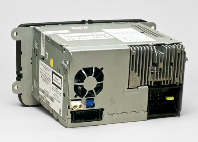

I HAVE NO IDEA WARE THESE CABLES GO. (PICTURE BELOWE )
I have a camera on the boot handle nstc witch has yellow rca video , one cable coming from reverse light and a positive trigger cable from a previous head unit i had fitted,
can ANYONE PLEASE tell me ware the gray cables go. and what im ment to with the yellow rca cable in the picture,
7 minutes ago, craigandrew said:
ok i have now got my Rear View Camera - "Universal" Interface für Audi/VW - RNS 510/315
https://www.kufatec.co.uk/shop/en/volkswagen/multivan-transporter/t5-until-2009/rear-view-camera-universal-interface-audi-vw-rns-510-315?action_ms=1

Anyway, after a quick look through the instructions, it appears to suggest the following for an RNS510/315:
The camera RCA connects to the yellow RCA (in the bag), do NOT connect the camera directly to the interface.
The other end of the yellow RCA (in the bag) go to the connector for the kufatec interface (black pin5, yellow pin 14)
The remaining large connector goes to the headunit.
There should be 4 other wires from the kufatec interface which are:
- power, red (ideally a new fused feed, otherwise pin 15 on headunit)
- ground, brown (pin 12 on headunit)
- CAN high, black and white (pin 9 on headunit)
- CAN low, black and yellow (pin 10 on headunit)
If your wires are different colours, it might be worth asking Kufatec to confirm what they are.

looking at the four cables under a magnifying glass
i have the fowlling PRINTED ON THE CABLE IN TINY PRINT. ALL THE CABLES ARE GRAY
1 GROUND
2 CAN HIGH
3 STEADY BLUE
4 CAN LOW
BUY HEAD UNIT I ASUME YOU MEAN THE MAIN WIRING HARNESS THAT GOES INTO THE BACK OF THE HEADUNIT I.E THE ONE ON THE RIGHT

I expect 'steady blue' is steady/permanent power given the others.
1 minute ago, mikeholroyd said:
Having fitted more than one, yes that is correct.
4 connections are 12 volt positive, earth, can high and can low.
Mike
thanks mike your a star
and they go into the main wiring  harness on the columbus
