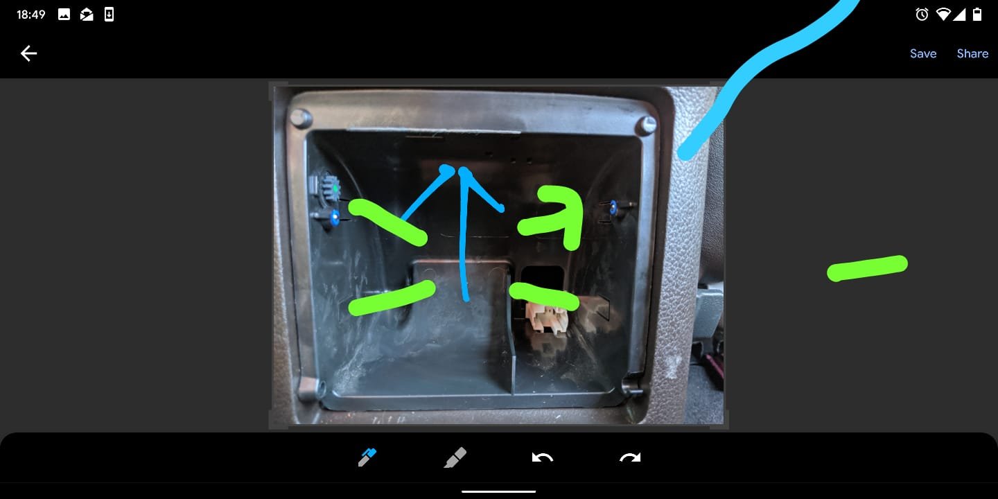

@Chazzy
Thanks for the info , I've had a look tonight and still a bit clueless
Would you mind just doing a photo of where these lugs are ? Or draw some obvious colour on the photo ?
Be really useful for this bewildered reader
Pretty sure it will all become abundantly clear
https://photos.app.goo.gl/Gcq7ZBVEP7zEhNat7
I think what you are saying is the black housing for the ashtry stays in sit and you push the clips up from the inside
And these are the clips you are referring to
https://photos.app.goo.gl/h1wnunEKtqXWvv578
Many thanks 🤯
No. Need to remoce ashtray holder to get to back of vent unit. Clips are pointed in green. No 1 son explained giw to edit a photo in phone!! ( wattsapp edit and send then sent back. Hes only 12!)
The clips need a manly pull inwards and something to keep them clear of the ridge they sit behind. Be careful tho!
Good luck !

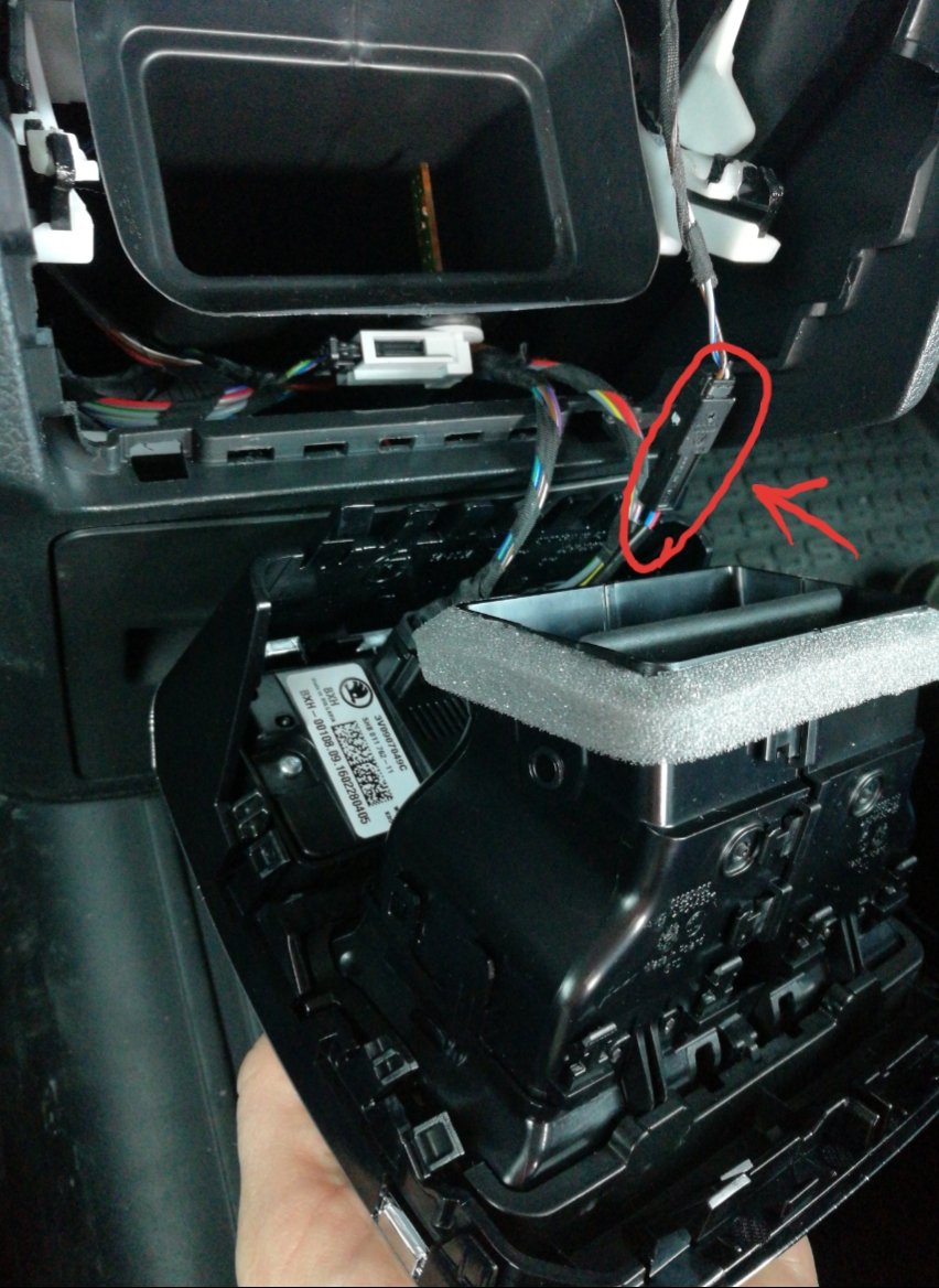

Can anybody be kind enough to advise how can I disconnect this wire joint?
press into hole by small screwdriver,
weren't easy even on ~fifth~ attempt, sits so tight

To remove the outlet grid part, as described by others, all you need is a plastic card. Insert it gently as shown on the picture, push a little in and move the card aside. The grid part will slightly pop out with a click and you can take the whole thing out.
To detach the cable connector you need to push the metal bud on it, with a small screwdriver (as mentioned by MartiniB), towards the brown and blue/white cables and then help further with your fingers. It's a tight link.
If there are parts fallen down in the vent pipe a vacuum cleaner may come handy.
