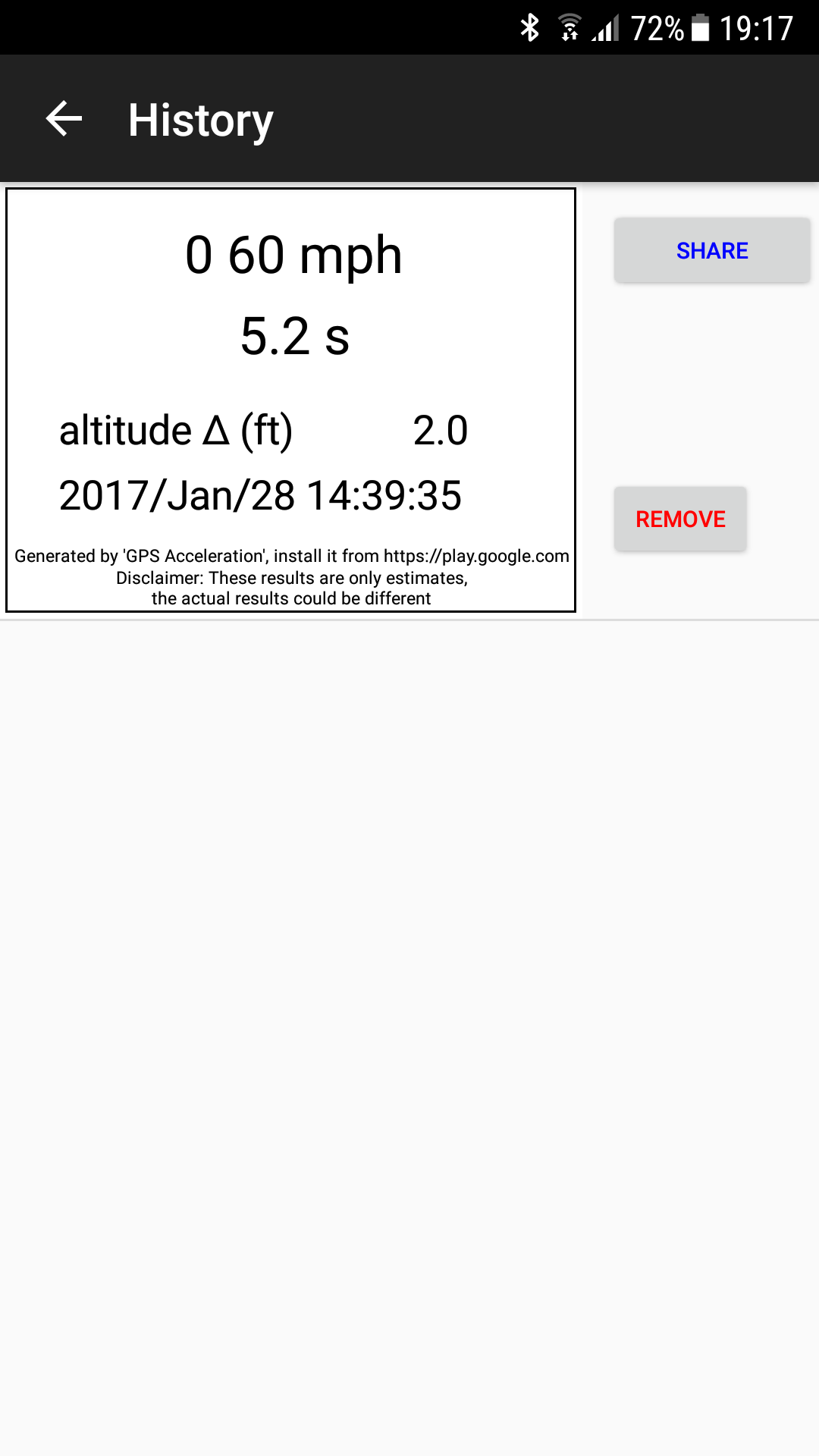

In September I bought my Dec 13 2.0tsi vrs Octavia. It was purchased from a dealer and it came with a private plate with vrs on it. I have needle sweep so presume that the previous owner activated that.
I did a 0-60 test with a mobile app and it said 5.2 seconds. I have a feeling it could have had been mapped. How could I tell?

Just a thought... what's the app? Perhaps someone else could test their stock 220 and see what the result is?
GPS acceleration. It's only a free app.

I was only trying to find out as this is the screen shot from the app. I am just worried if the car was modified as the insurance would need informing.
