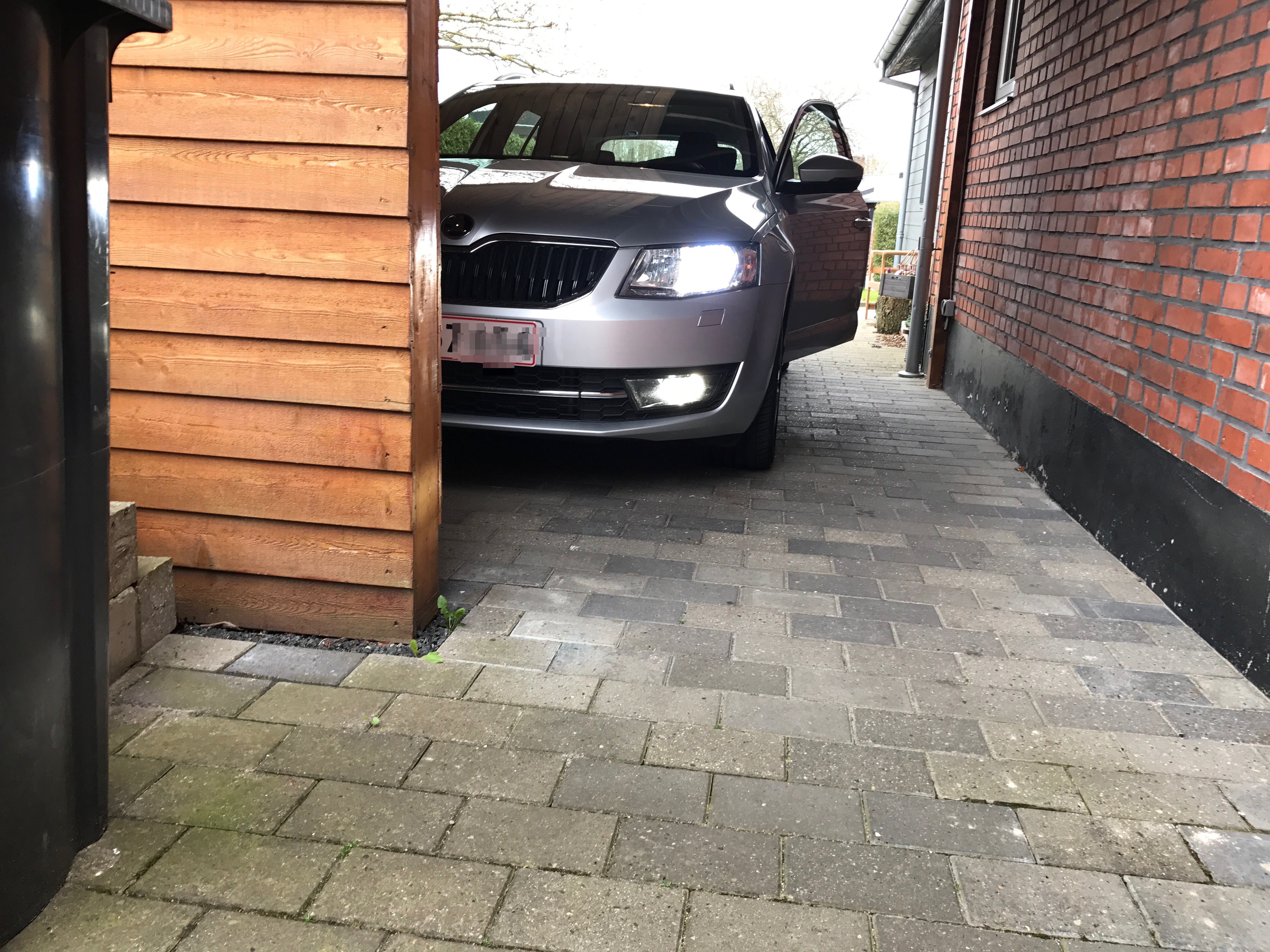

Here is my setup
Philips ultinon h8 in fogs, fogs also used as DRL instead of the H15
Philips Diamond vision in H7 for dipped, the H15 sidelight are dimmed to 5 to get rid of the yellowish along with dipped beam.

I don't understand your brightness setting for the side lights either, is that 5% or setting 5 ?
I think he disabled only the side light function so main beam / DRL still work as normal.
0% brightness setting can cause bulb out error, so probably that's why the 5%?
Edited by aki78
Yes dim set to 5
