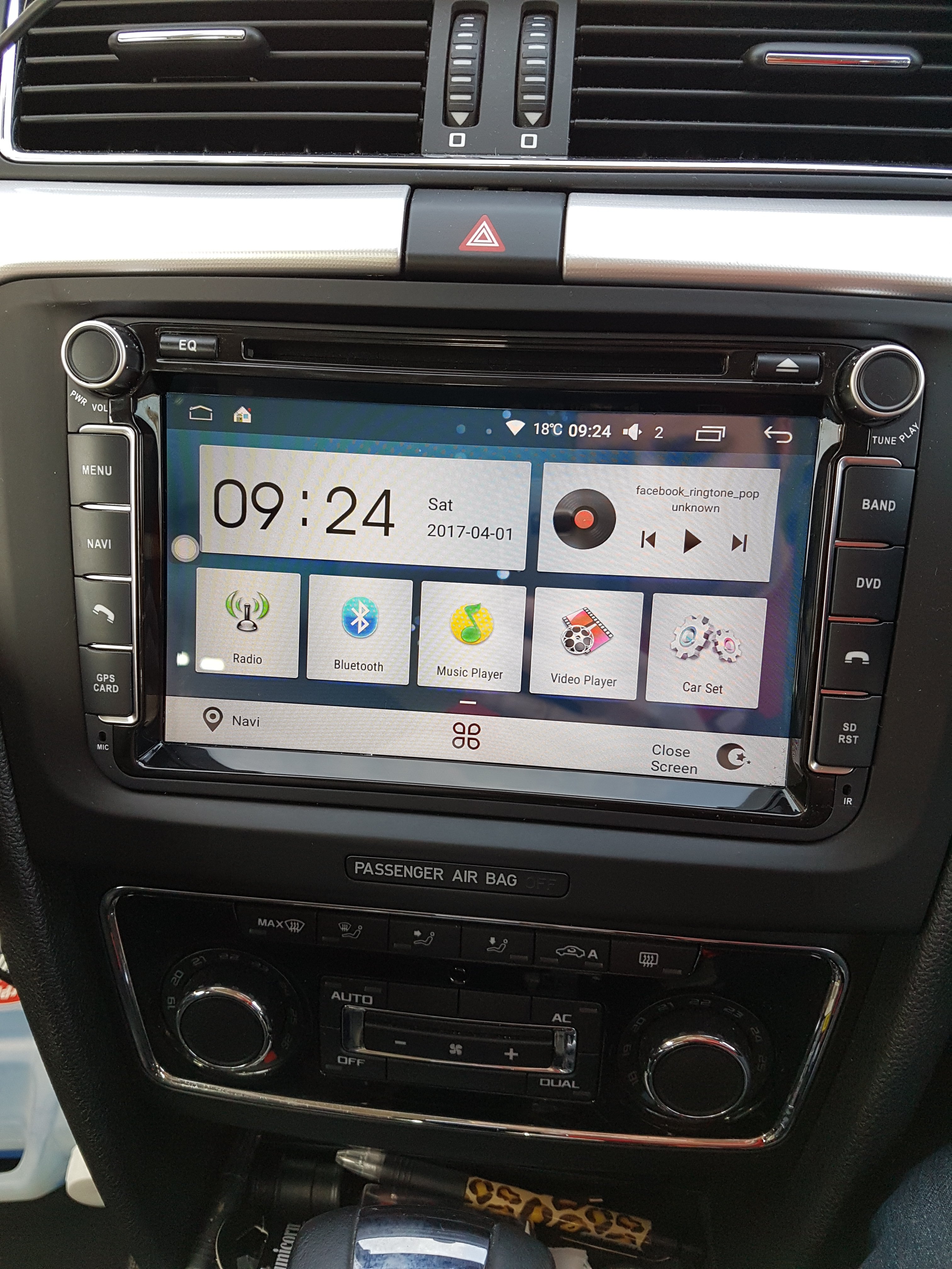

That's mine installed into my Superb. Pretty much as it came out of the box. I've installed a few apps (very easy with the Google play store) so I have chrome, iPlayer, iPlayer radio, radio X, YouTube and Facebook. I've also installed Waze but to be honest I've not found a nav app I like enough to part with my TomTom stand alone device.

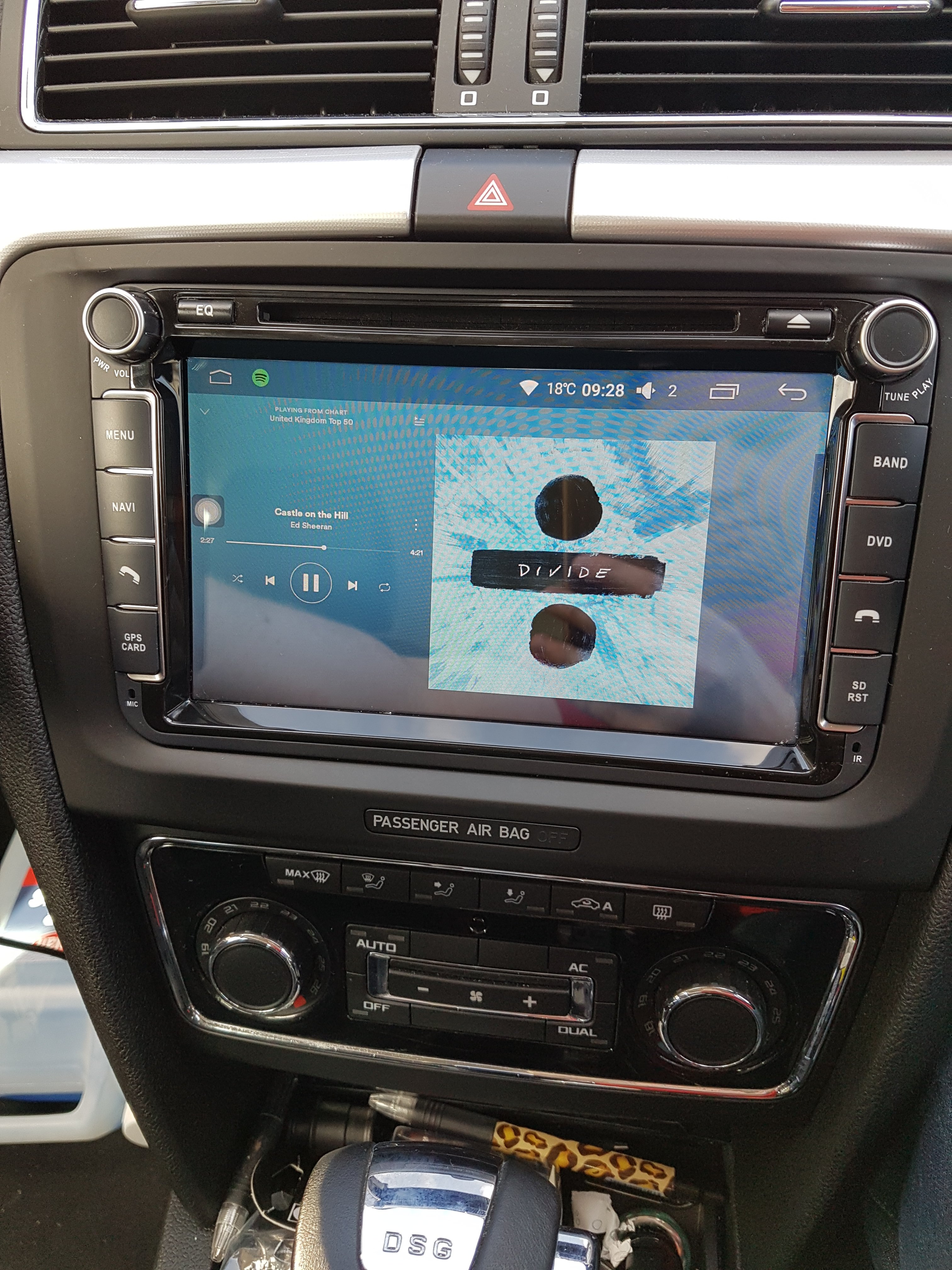

That's running Spotify.
Looks good Chris, thanks for posting those photos.
