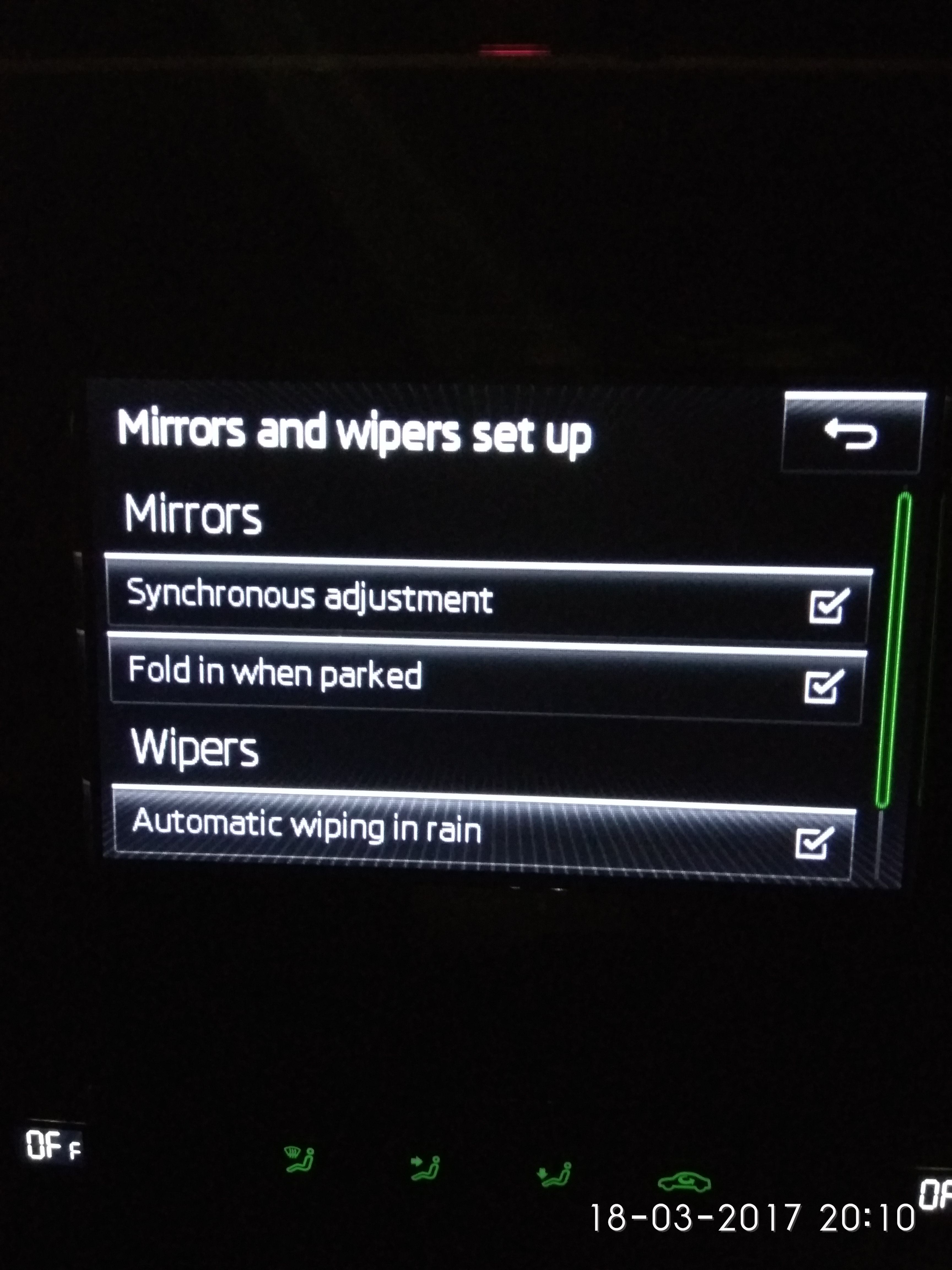

Folding is never a problem,its only unfolding...I have tried many ways..it seems I don't have that option in infoteinment..what I have there is Fold when parked option only.
There is no special option for "unfolding" it should fold & unfold automatically if the option is selected in the infotainment.
As long as the alarm is working (which I know as its gone off several times with people inside) Im not interested in a flashing light...
As I said you, in infoteinment there is no option of folding and unfolding..only options regarding mirrors I can see is the following one.
If it is an early 2013 model then the mirrors only unfold when you turn the ignition on, not when you unlock.
