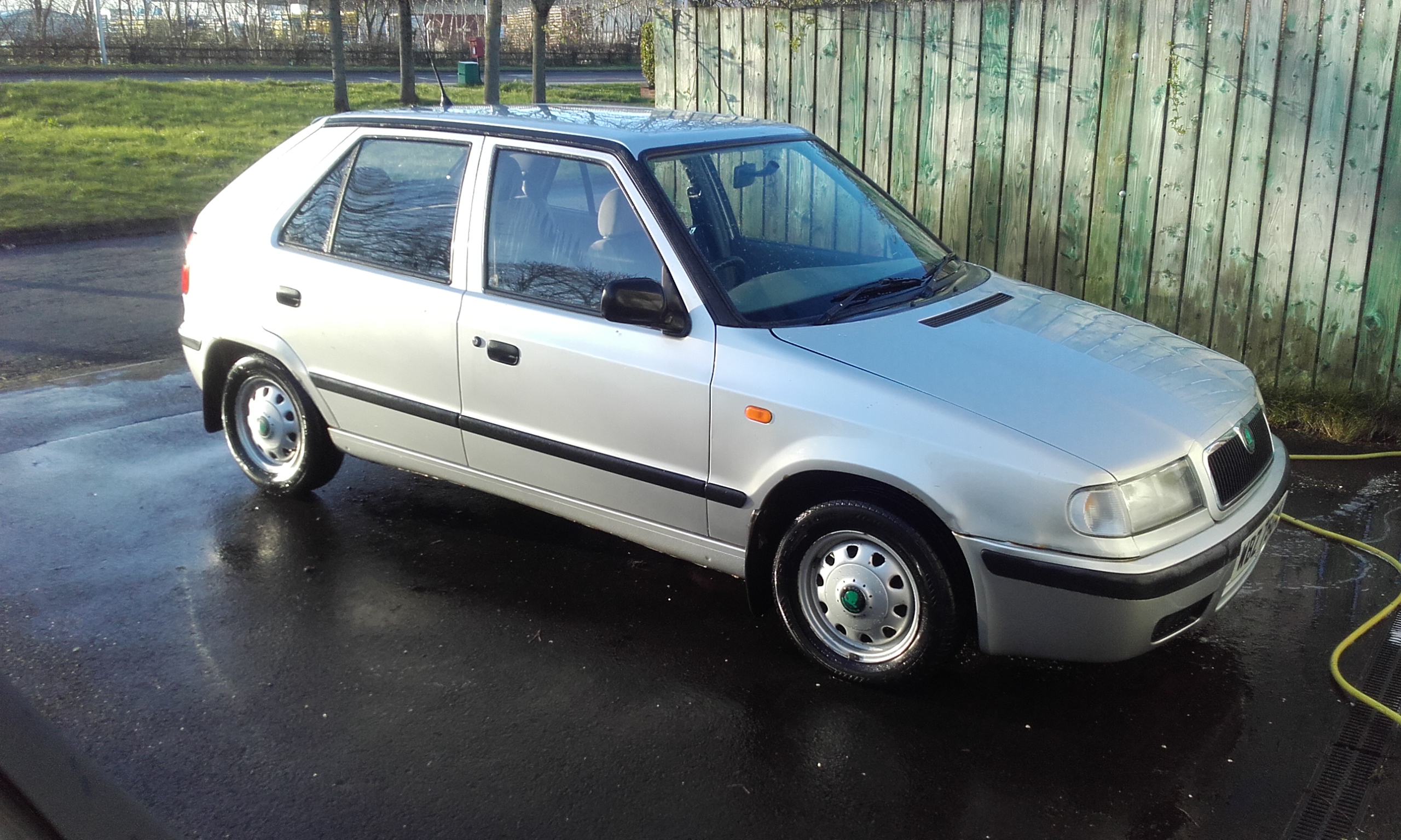

I think you may be right Ricardo. Thanks for all your input here. I can't find the source myself, which led me to suspect that something may be wrong with the drive train  (when I previously mentioned the diff). I was thinking that with worn bushings, strut tops etc, that the components may be flexing or moving more than normal, allowing say the hub assembly and driveshaft to press against the box and diff.... I haven't a clue what's going on. All I know is that when I steer hard left there's a noise from under the car, that I can't find, and all the components look good!
Edited by faker
wee car really is in good shape. Drives great, will probably need a clutch soon, and could do with a couple of drop links, but other than that it's good.
I'm not planning on rebuilding the thing though!
