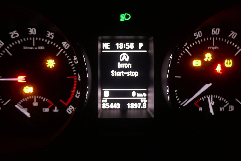

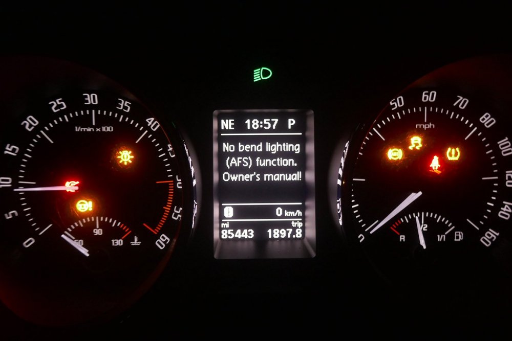

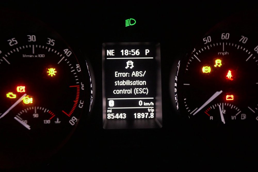

I've got a similar problem with my mkII Superb...new member here so not sure whether to start a new thread or keep this one going...advice/suggestions welcome!
Various warning lights suddenly appeared last week - unsure whether they're all related or just coincidence that they've appeared at the same time.
Tyre pressure warning was on previously and think I have a slow puncture - refilled tyre and reset the tyre pressure, all ok for a few days. Once the other warning lights appeared the tyre pressure warning appeared again and although I've checked and reset the pressure in all four tyres I'm unable to reset it.
Bulb warning light - there's been a temperamental fault with number plate lighting - one of the two bulbs goes out occasionally - tap it and it comes back on, so not sure whether the warning light is on for that fault or the AFS.
Anyone with an OBD scanner local to Penzance?! MOT due so may end up biting the bullet and buy one myself.
From what I've read on here there could be a few causes for these warnings to appear - faulty abs sensor perhaps.
Think I'll re-post this in Superb section...
If you've got that, ABS and traction control (any type) warning lights at once, I'd suspect an ABS sensor or wheel wiring problem, or a slow puncture, since all 3 systems use the same sensors and depend on actual rolling radius.
Thanks @KenONeill - I think I have a slow puncture but I've had a slow puncture on a couple of occasions before without the ABS/ESC lights coming on but appreciate what you're saying. Think I'll get chance to jack the car up today and get at least a couple of the sensors removed and cleaned up to see if all that's causing it is a bit of crud! Hopefully they come out without any issues.
Can't see any foreign objects stuck in the tyres so will give them a quick bath when I remove each wheel and see if I spot any tell-tale bubbles!
@Salad_Fingers - OK then:-
  1. Check for a slow puncture, and rectify that if required. Note that, in this context, a "slow puncture" is any condition that means one tyre loses pressure faster than the other on that end of the car.
  2. If there aren't any slow punctures, use a good code reader to determine which corner(s) throw ABS errors, then investigate there.
