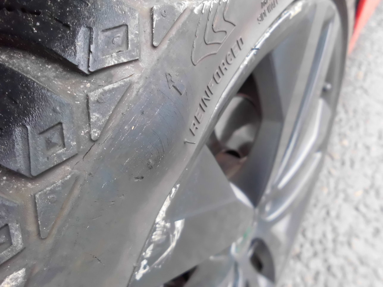

Speed wobble was easy, bulges in the winter tyres so a pair of 205/45 R 17 Goodride are on until i put good tyres on in the summer. £100 for a pair.

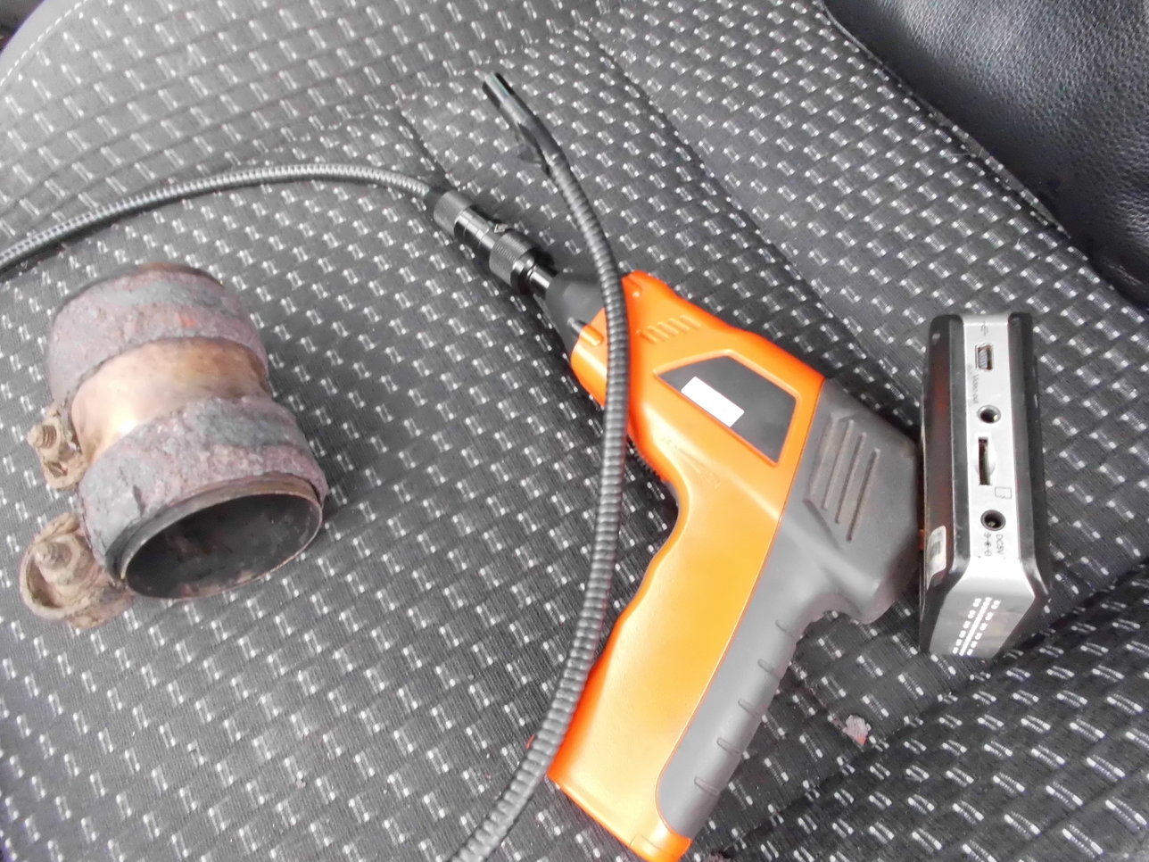

Exhaust clamp was all that was needed so £9.60
Fault code showing was just Catalytic reading, Park Assist and some that were from being left with a flat battery. £0.

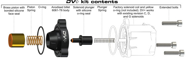

Slightly Good news my local fixer upper garage scanned and it has come up with P2261 which is the N249 Turbocharger Air recirculation valve.
I am thinking this the  (DV+Valve (T9355) .
I did buy the device second hand so maybe it has failed in some way. He advised me to take the car back to tuning shop to analyse the part.
Another option he said was to take the spring out of the DV+ Valve (if unit still intact) so it would then act like stock? Has anybody done this?
'O' Rings need checked, and connector.  Otherwise i know nothing about them.

Me neither, but i remember the tuning guy saying it was difficult to fit, so there must be something wrong with it. Its in the tuning shop next thursday but sounds promising if it is that. (ie no more major expense)
I have fitted them as per guide, nothing difficult there, it is just they were out a box new, and i know nowt about them, other than they work.
