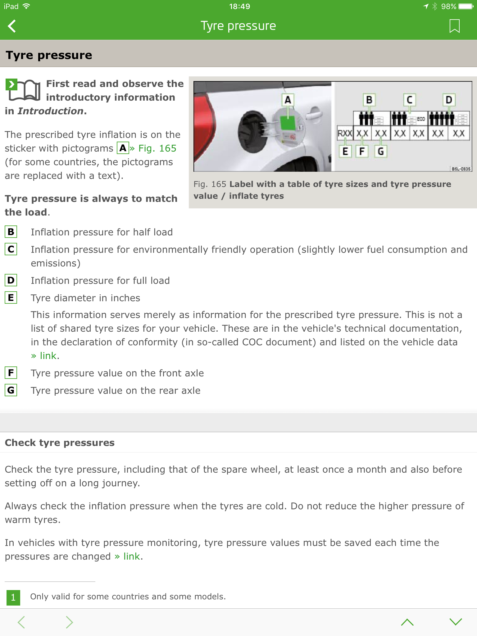

No idea of the answer for your car but the manual app thing on my iPad says
The pressure guide in the filler flap is good.
