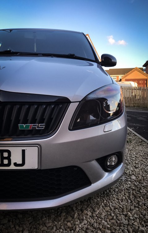

I had no idea you could get a mk11 with xenons, thought they were all just normal halogens but in projector lamps like this..
Anyway, has anyone tried the led replacements for halogens rather than something like the osram night breakers ?
