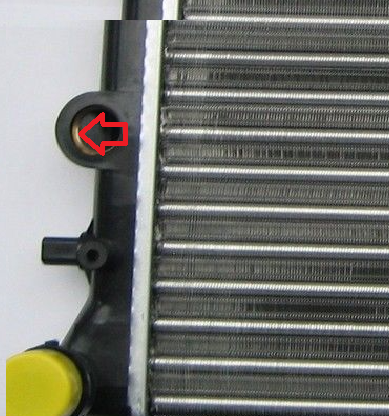

29mm spanner. There's a brass threaded insert in the plastic. :thumbup:

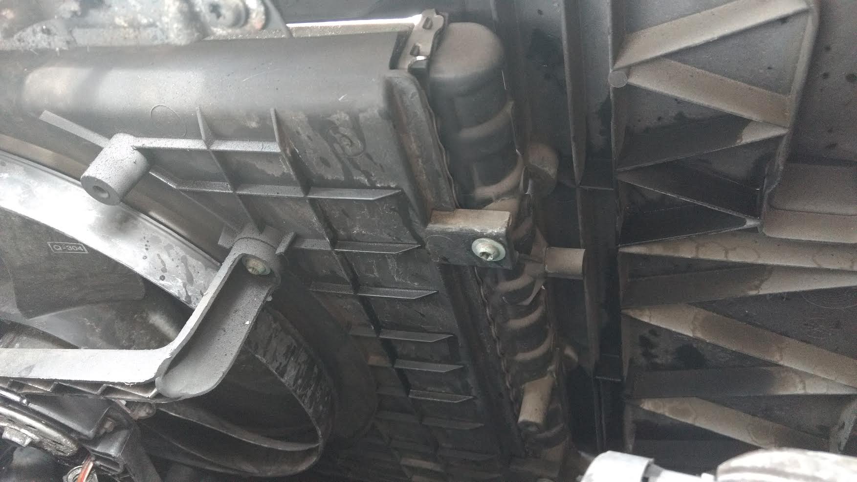

Thanks a lot everyone for your help. I'm struggling still, despite the excellent photo (I'm really not great at this kind of thing!!) - if it's on the side closest to the battery then there's little room to see or do anything! However, I took a photo of what I can see, and can't really match it up to your photo. Ignore the damp, I replaced the coolant sensor earlier and... let's just say I lost some coolant... and pride ; )
  • Sponsor
Yep, battery side. May be better coming up from below, access-wise.
Between the radiator and the engine (ie the rear side of the radiator) - if you look down with a good LED torch you will see it.
