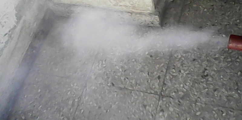

Well it cranked...but didn't go well: I got a lot of grayish smoke, oil being burned? If that's the case, perhaps, since I can't have original rings so the ones I put are "made". Oh well, I see I will need to tear it down again and check stuff. I could visually inspect inside the cambers through the spark plug holes, there is oil there. I wonder are the rings, or I went too happy oiling the chambers while building the engine. When I did a little crank without water, just to check it starts, I could see this kind of little smoke out of the thermostat casing and the water pump. I guess it would be paint, oil, etc being fried. I put hoses to the engine and the out hose into a bucket, I didn't got bubbles there. I guess compression is not going into water system, right?
Also: sparks 1, 2 and 3 are slightly oily. Spark 4 started to get black burn
So what could be? Rings? Bad carb settings (too rich)?

@Aram - Assuming the engine is warmish, or at least that your local air temperature is still in the 20s (Celsius), that makes me think either oil or that the bottom seals on the cylinder liners haven't sealed properly.
My guess is oil. When I put the cylinders I tested for coolant leaks to the sump and got nada. I think I can blame the rings, since I can't find originals here so they get made by guys in lathe using cast iron from sewage pipes.
@Aram - As a generalisation, compression rings are cast iron. Oil control rings are more complicated.
