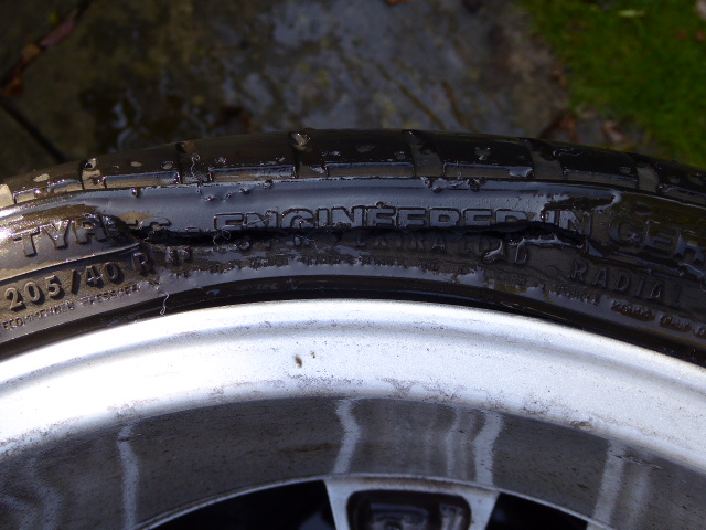

I had a puncture yesterday (see attached photo).
The tyres on my VRS have now done in excess of 40,000 miles and I would like to get all four replaced at the same time.
I know that the standard tyres which I have fitted are 205/40 R17 84W Continental SportContact 2.
