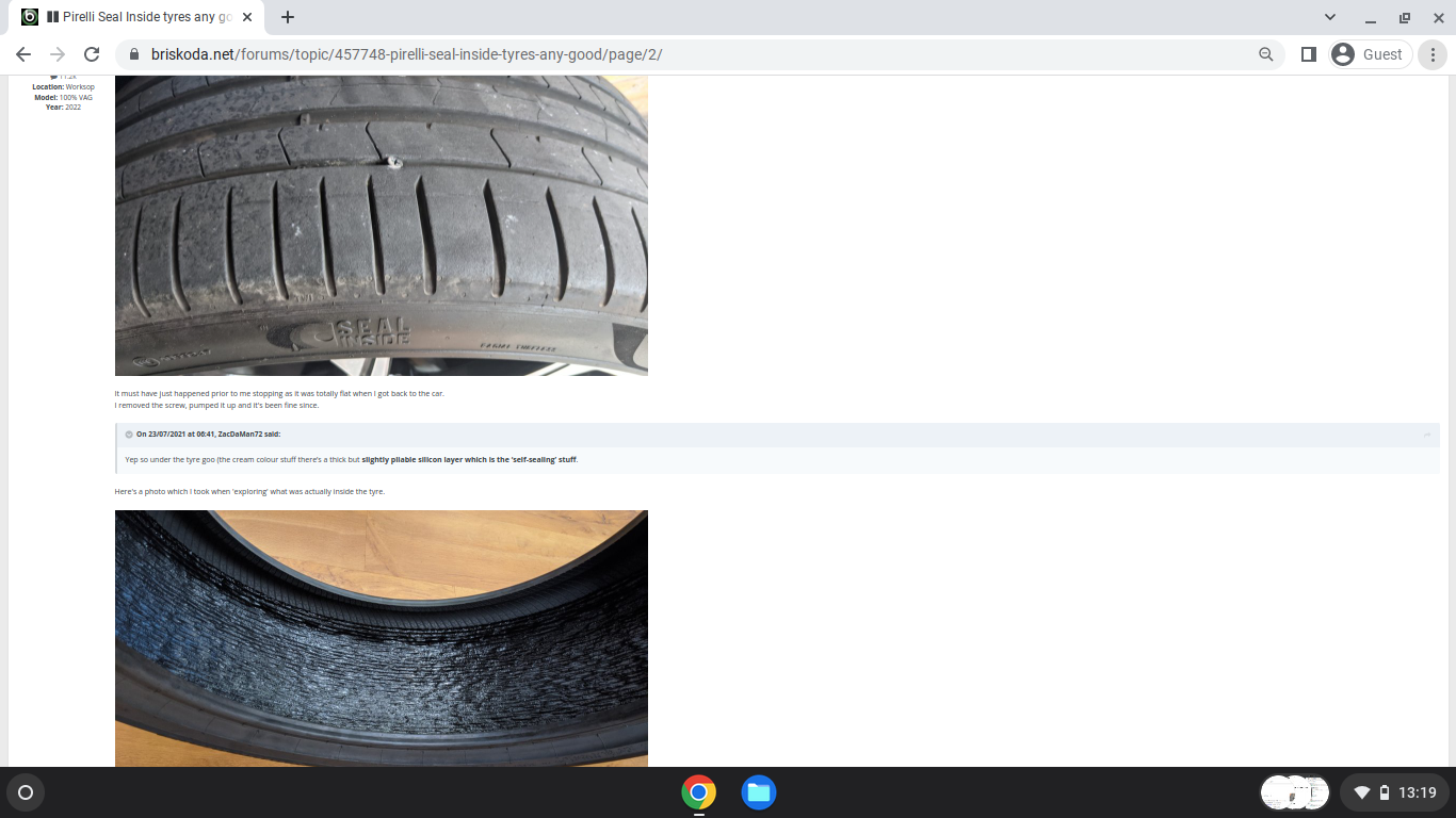

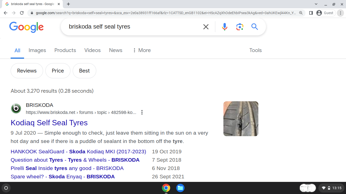

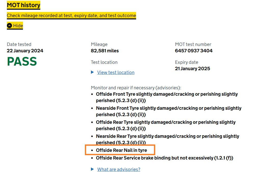

I'm not sure, but is 'foreign body in tyre' not an MOT failure?
Surprisingly not.
Not my car, but one I got through MOT recently without noticing the screw (not nail) in the tyre:
