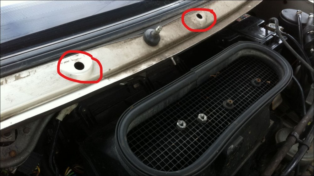

I checked at the forum and i found here this
do you meen to seel the two holes on red?
(THE PHOTO IS NOT MINE ITS FROM THE TOPIC common issues by Tech1e) i just notice with red

@Kcha I'm pretty sure that @HeavyMetalRich is correct about the leak being related to the windscreen rubber, and/or rust in the windscreen frame.
The 2 holes you've highlighted in the picture are for "other hand drive windscreen wipers" and can be sealed with big blanking plugs and a smear of silicone bath sealant.

2nd : do you thing that is better to seal the 2 holes or to set them as they are?

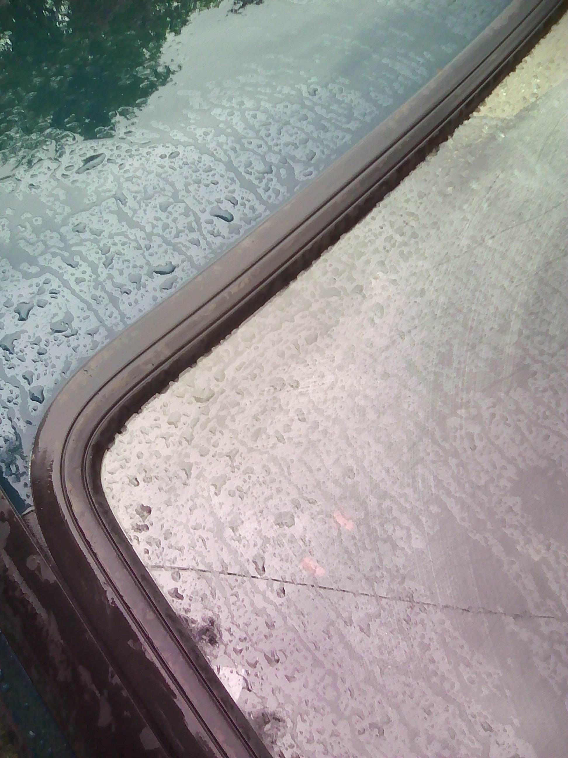

the photo is from the car today

@Kcha Well, that portion of the seal looks to be in first class condition as does the visible paint, which inclines me towards the bad seal or seat idea.
Which in turn means getting the car somewhere under cover if at all possible, and then drying it off, removing the windscreen, and cleaning the channel in the sealing rubber properly before re-installing. You should be able to find a video guide to doing that on youtube.

  • check the body frame for rust, cracks, holes. There are 2 holes, one on each side, made by Skoda for draining water (see photo). The output of the holes is in the engine bay so don't plug them.

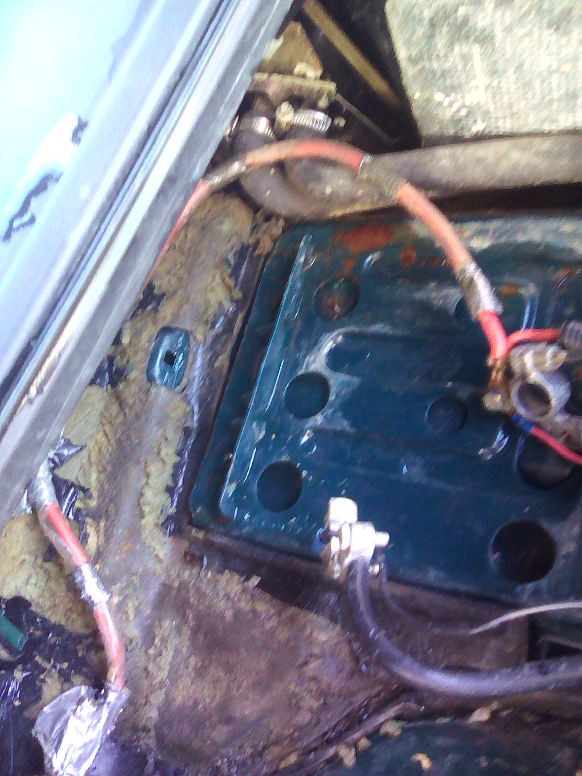

Second : he took off the battery to see if there was any problem (see photo) nothing there too, we wet it with a lot of water nothing hapend. Inside the spong was dry and after a few time still dry. He gives up and made a call to his friend (Sheet-iron merchant Is it correct word?) . We are going to make an appointment to check it to !!
