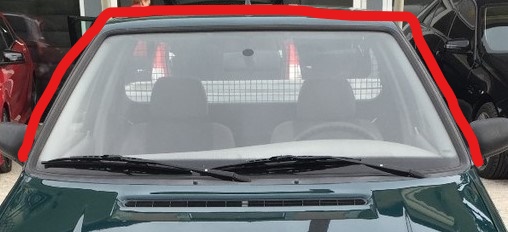

What is really important is that you try your best to solve the problem. Take pictures to show what you have found.
PS
Skoda used a resin to better seal the lower part of the windscreen. When installing the windscreen use silicone liberally all around the perimeter of the windscreen and seal.

1st a special thanks to all of you espesialy to KenONeill RicardoM HeavyMetalRich.
I was busy all summer so never had the time to reply (thats not good i understand) So anyway my apologies
I fixed the leak at carglass company, They said its nothing serius so they put a black silicone for sealing  around the windscreen
Now everything is ok
