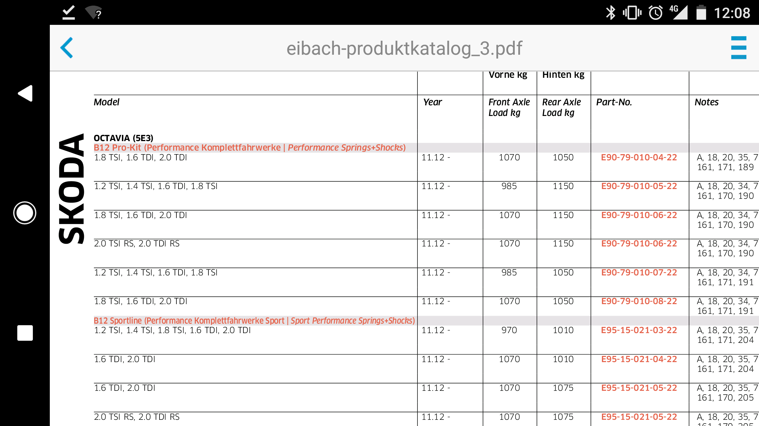

I bought bilstein B12 pro kit. If you go to Eibach website you'll be able to download a catalogue of the selected coilovers where they'll have loads listed, strut dimensions, and all other data you need for your car.
Here's a screenshot of the kit i bought and MK3 octy data from their catalogue
The reason why I mentioned eibach was because the b12 consists of bilstein b8 dampers and eibach springs.
