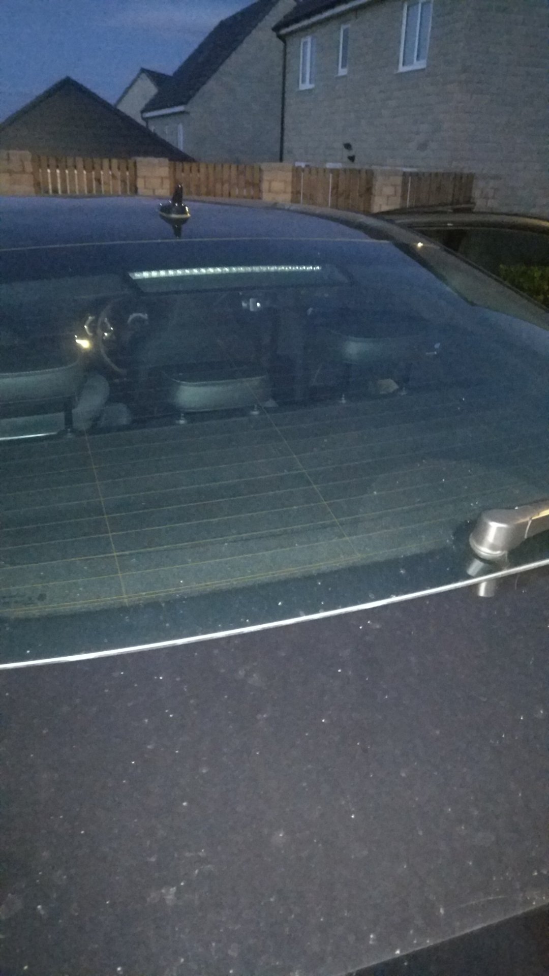

I have an aukey dr02d dual camera and i havent noticed my radio signal going. I use DAB all the time.   My camera isnt stuck directly on thr screen, its stuck under the high level brakelight so it sits more central.  Can just make it out in this pic. Screenshot_20180809-201450.thumb.jpg.f35747a3850e720c731662c76e15102a.jpg

Can I ask what way your wiring comes into the boot lid. Is it from the passenger or driver side. I've run mine the passenger side and I'm losing the dab signal at times. For example at home I can't get absolute when the car is in the drive unless I have the boot lid open. If I disconnect the camera the signal comes back immediately.
Thanks
Adrian.
Is the rear quarter on the LHS not the antenna? There is a wire embedded in it. I can't remember if the RHS also has an antenna
I really don't know I cant find much on the subject.
I'm playing with it right now. If I move the camera from the mount into the car the radio reception returns. But as soon as I move it back to the glass it goes. Does the superb use the rear window as the dab aerial? I assumed it was on the roof?
