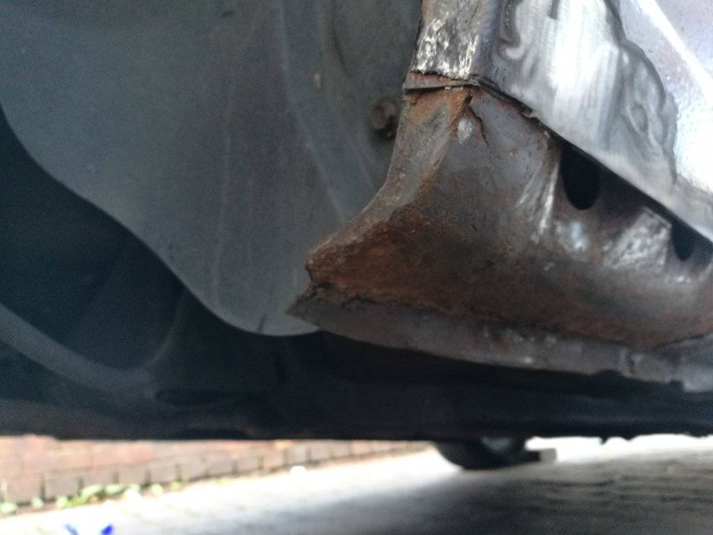

rust, just surface rust, according to MOT histor, never been welded.... now thats a rarity!

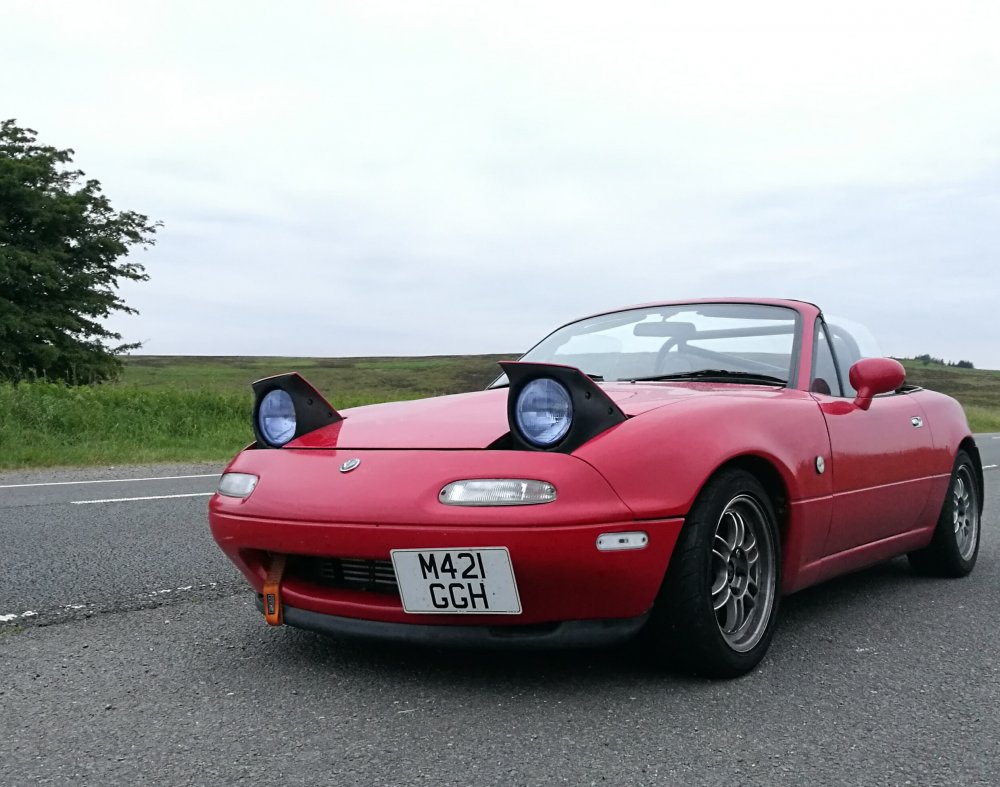

    Driving home from work today , two kids (about 7 y/o) walking home from school, pointed and said "cool car" lol.... too young to know what an old MX5 is then, but maybe recognise the lotus badge?! lol

OK, after discussion with Ash, its now officially called Ozzy, as it's a bit old and decrepid, but has a lot of attitude :)
when we first picked it up!
Rose approves....
Lotus badge, just for ****s and giggles....
