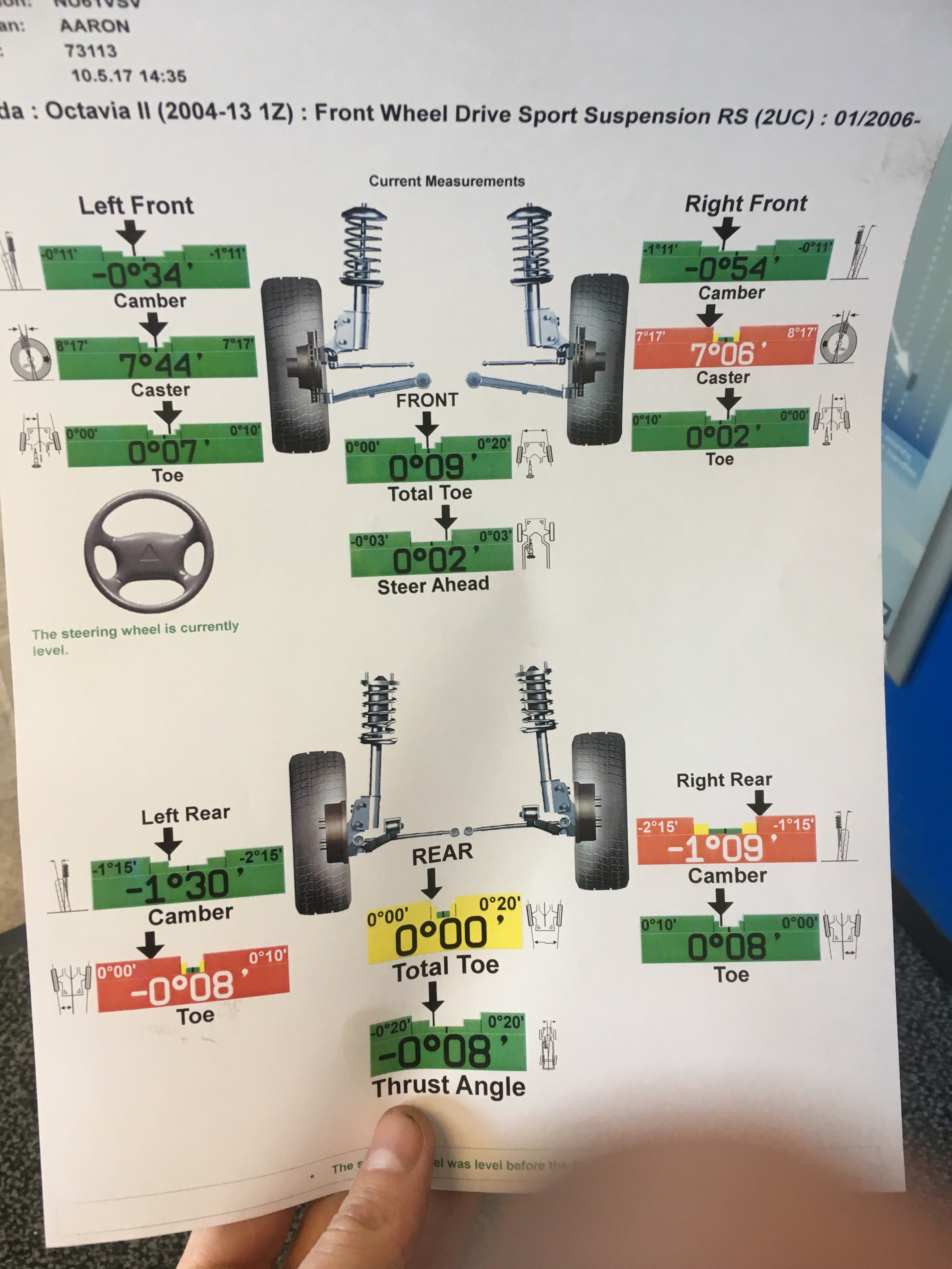

Just sat having a hunter wheel alignment done and the garage have given me this as the before. The alignment is only a fraction out. Probably not the cause of the issue.
Yes, doesn't look that bad but you have to start somewhere. Did they have any ideas?  Any next steps suggested?
Like I said experience is valuable. If they've left the rears at spec near to -1.40 that is pretty harsh on the rear tyres inner edges. Better to go more moderate than spec at the expense of a little on the limit grip.
However, I agree that shouldn't be causing you such significant issues in terms of vibrations out of round tyres.
1. Do you have the after geometery?
2. Was there any feedback from the alignment engineer in terms of causes of your problem?
3. What tyres are presently installed?
