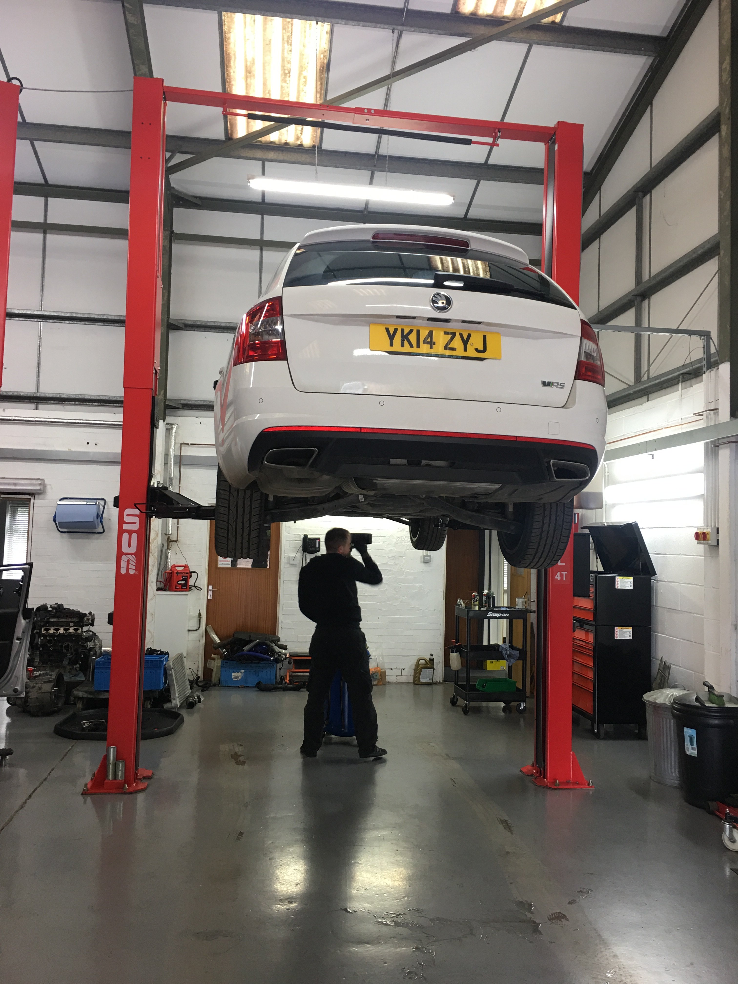

Spent this morning at AKS Tuning having DSG Service, Brake Fluid Change & General Service got rid of the crap long life service will be returning to the 10k service like I have done on all my cars.
Also discussed up-rated roll bars and lowering so that will be happening n the near future.

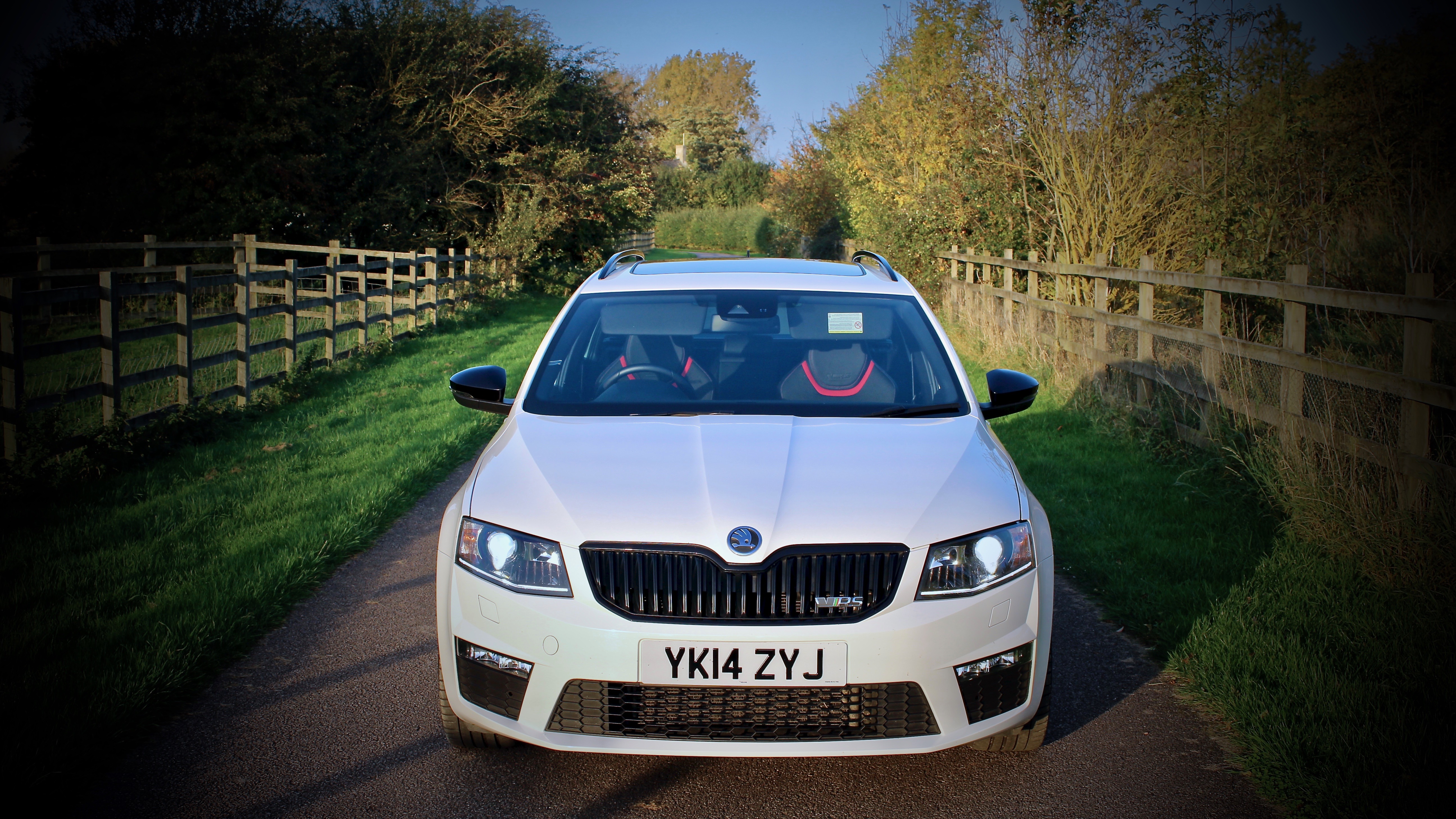

  • Cleaned the car today so thought I'd have ago at this photography thing  these were the best of a bad bunch!

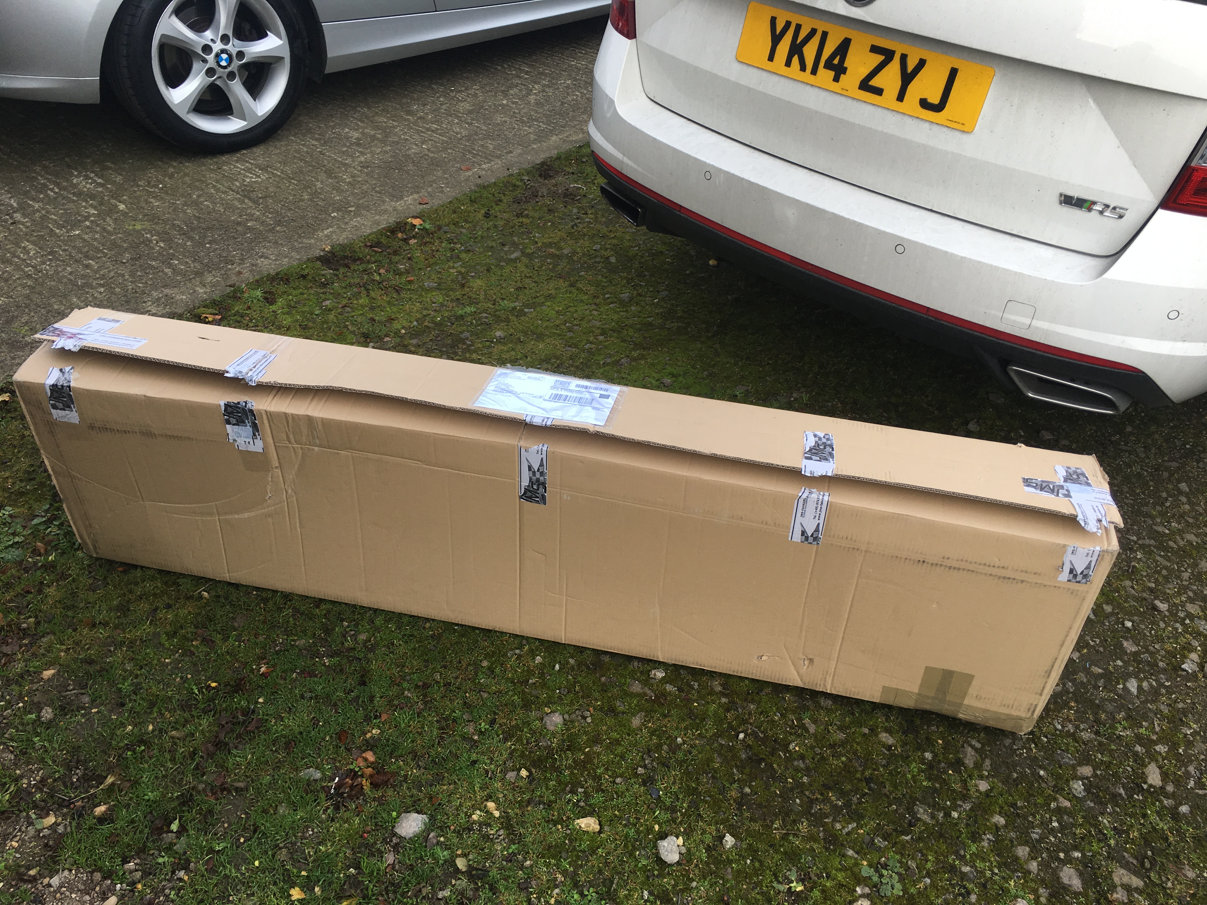

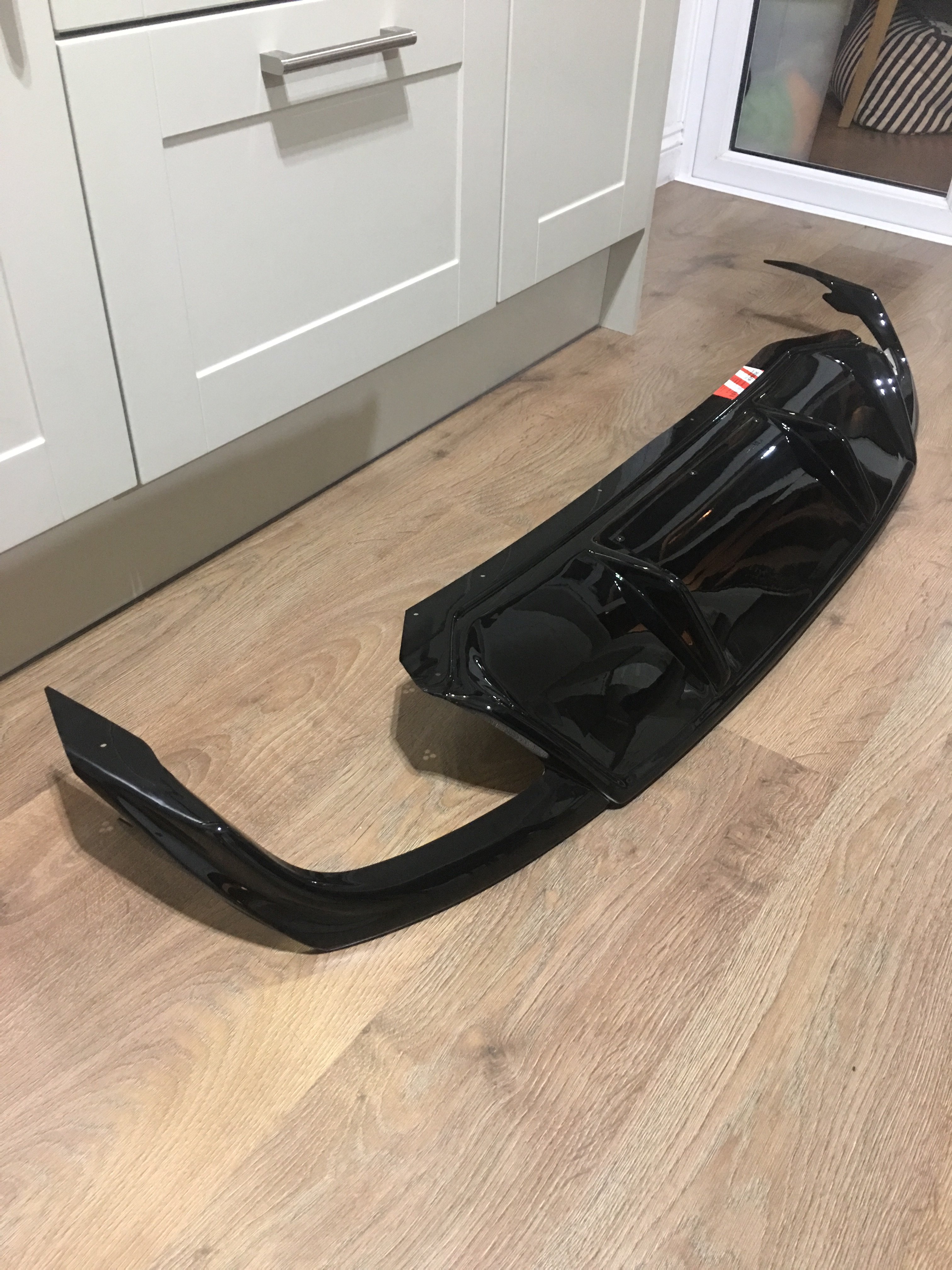

Rieger rear diffuser with tow hatch has arrived in the worlds biggest box, pretty excited, hoping it will be a nice improvement.
Dropped it straight off at Detailers to be prepped and ceramic coated.
UPDATE: Got the diffuser back so should have it fitted on Saturday if weather allows.

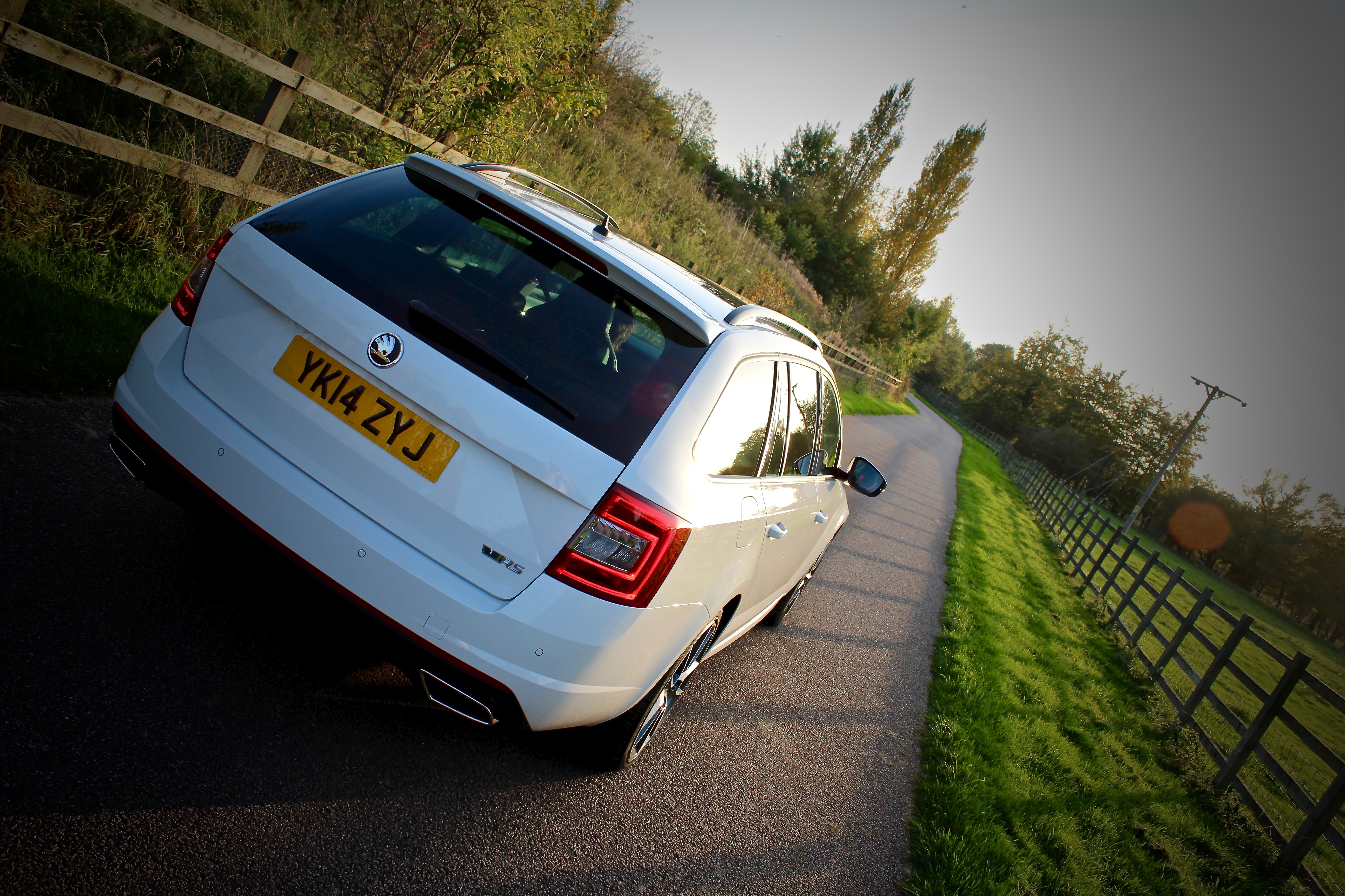

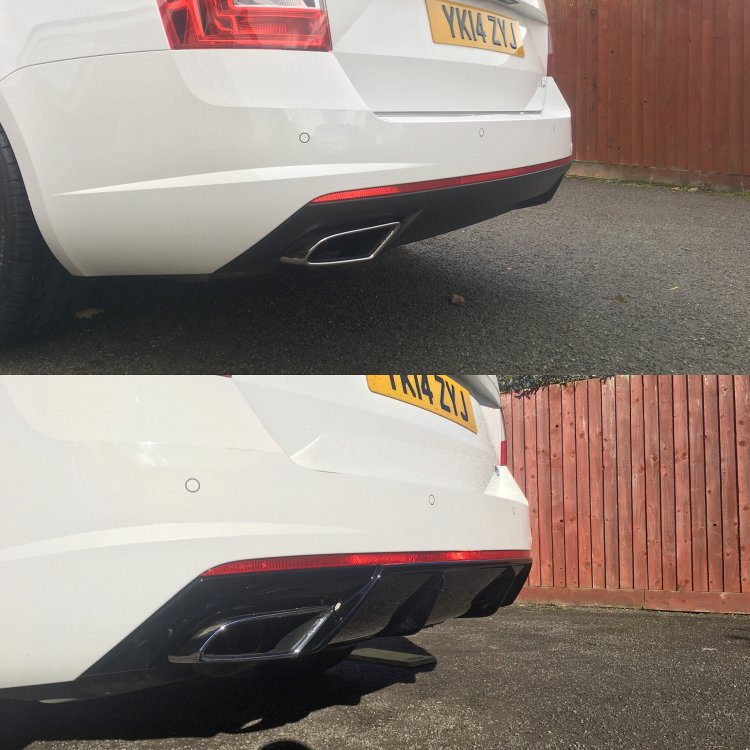

Picture doesn't do it justice, makes the rear look so much nicer!

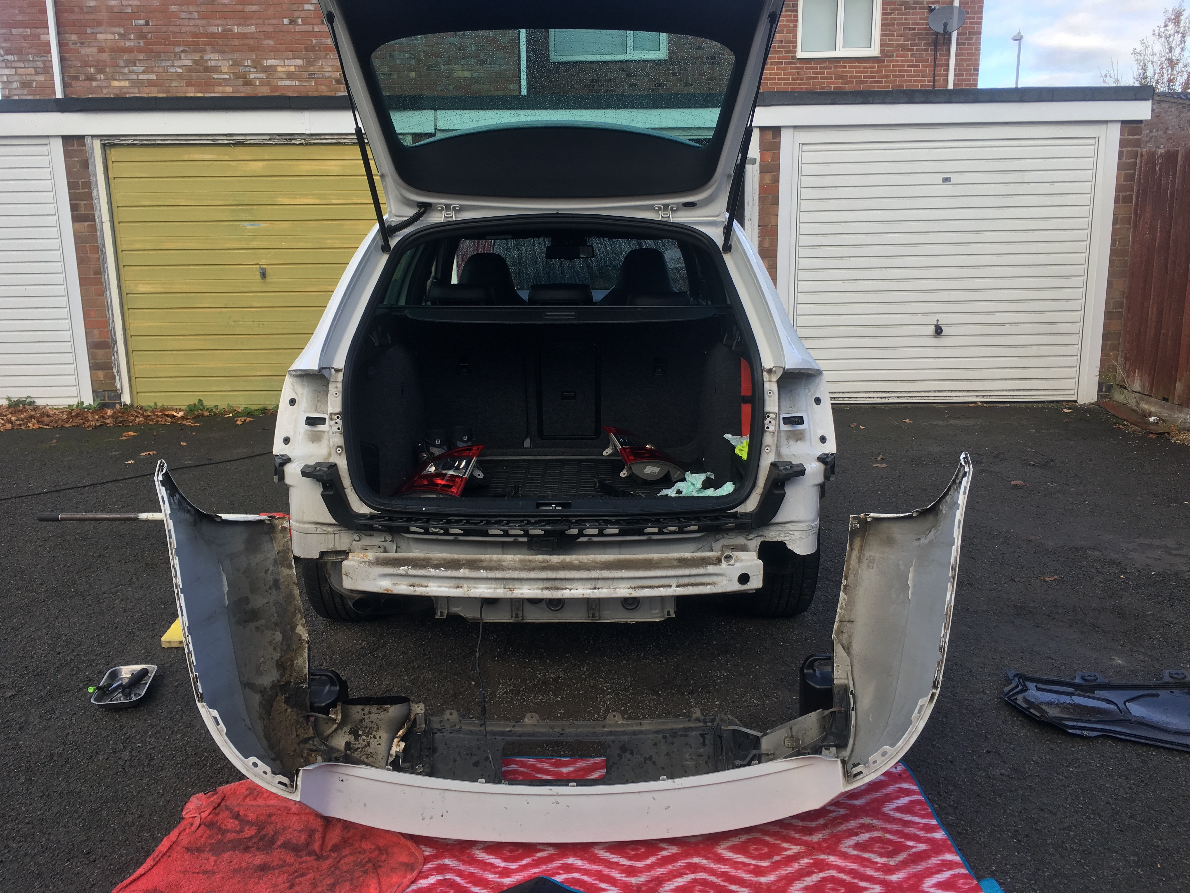

I removed the rear bumper to fit it but was informed afterwards that if you remove the exhaust tips you can gain access to it all, however if you don't have a ramp like me bumper removal is probably the easiest way to go.

How hard is it to remove the actual trim then either with the tips removed or the bumper off? I have a ramp and pit at work so possibly something I could do in my lunch hour or after work perhaps?
Was really easy with the bumper off, 4 Screws in each rear arch (1 behind the liner).
3 screws for each rear light then it’s just a matter of careful pressure in the right places to remove it.
 Its probably a similar amount of screws to remove the exhaust tips and simpler with ramp use.
I gave the back end and inside side of bumper a good clean while it was off as it looked like this!

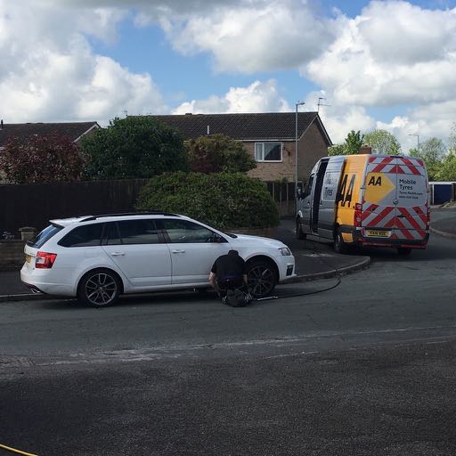

Bought a roof rack and boot liner. The boot liner fits nicely but isn't as good as the autoform one I had in the jetta. Also had some Michelins PS4's put on the front, it had continentals with life left in them but couldn't get on with them, just didn't seem to have the grip levels I wanted.

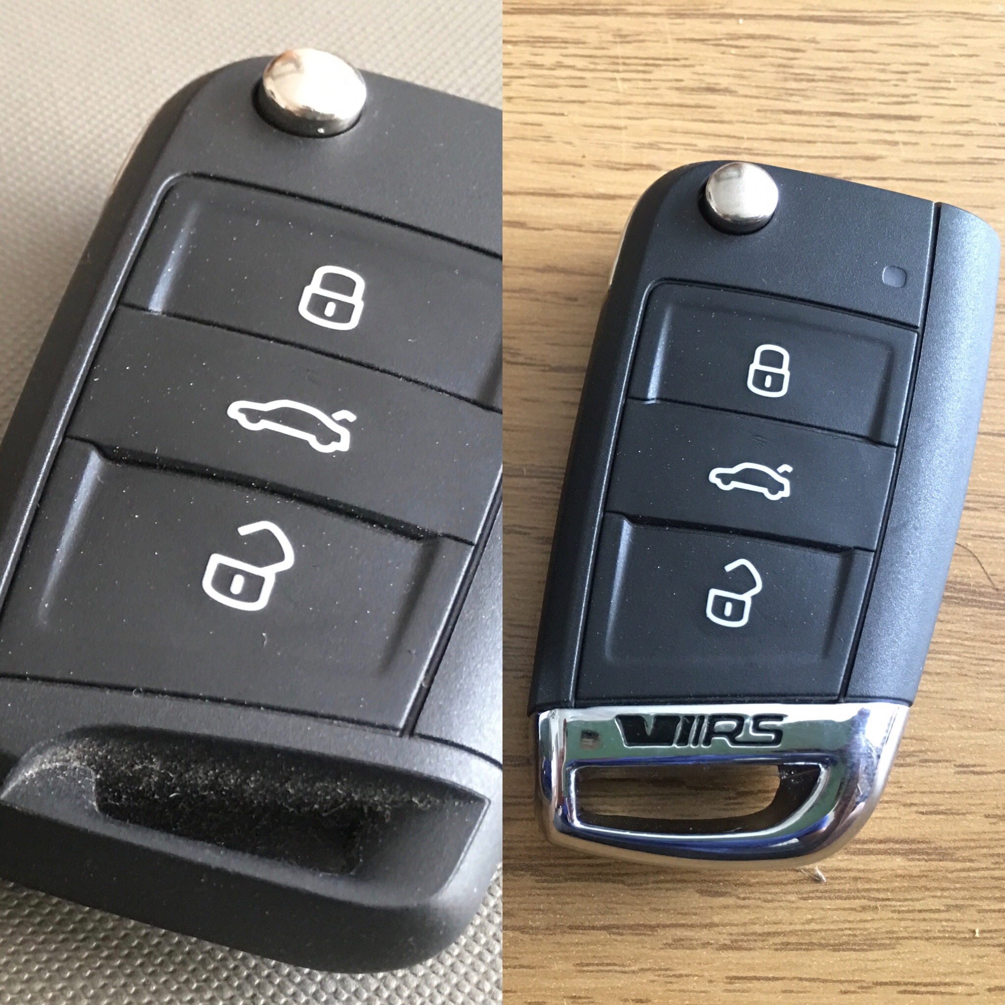

Bought LED's to do an interior light conversion and also replaced the bottom trim on both keys.

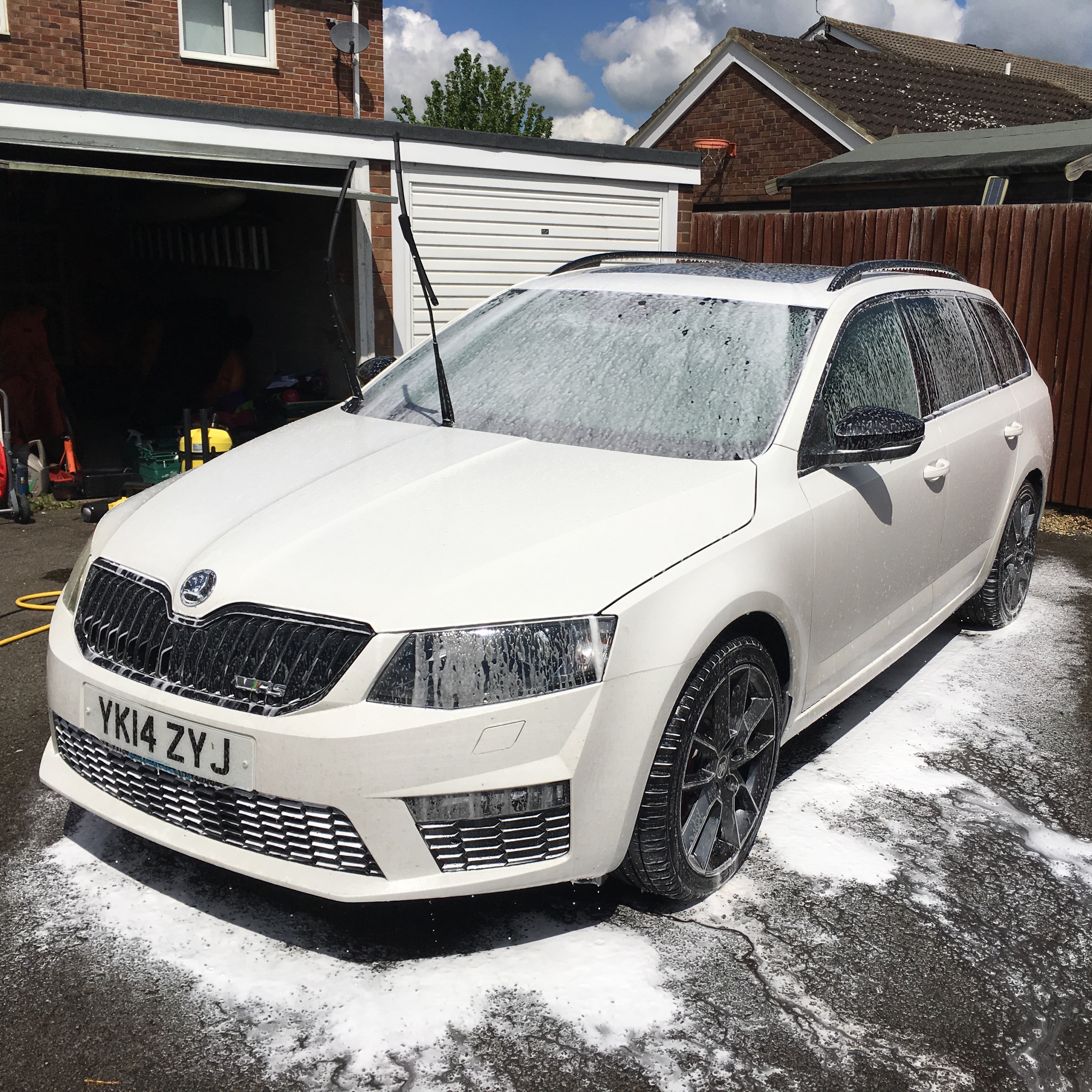

Also gave it what seems to be its first every proper clean, Snowfoam, degrease, wash, iron off, tar remover, wash, clayed, wash, rinse, waxed and rain X. This also gave me chance to inspect the bodywork which is fairly good condition, several stone chips on the front that have been filled in with paint pen but its three years old so it to be expected.
I would like to get it properly detailed as the swirls are fairly bad.

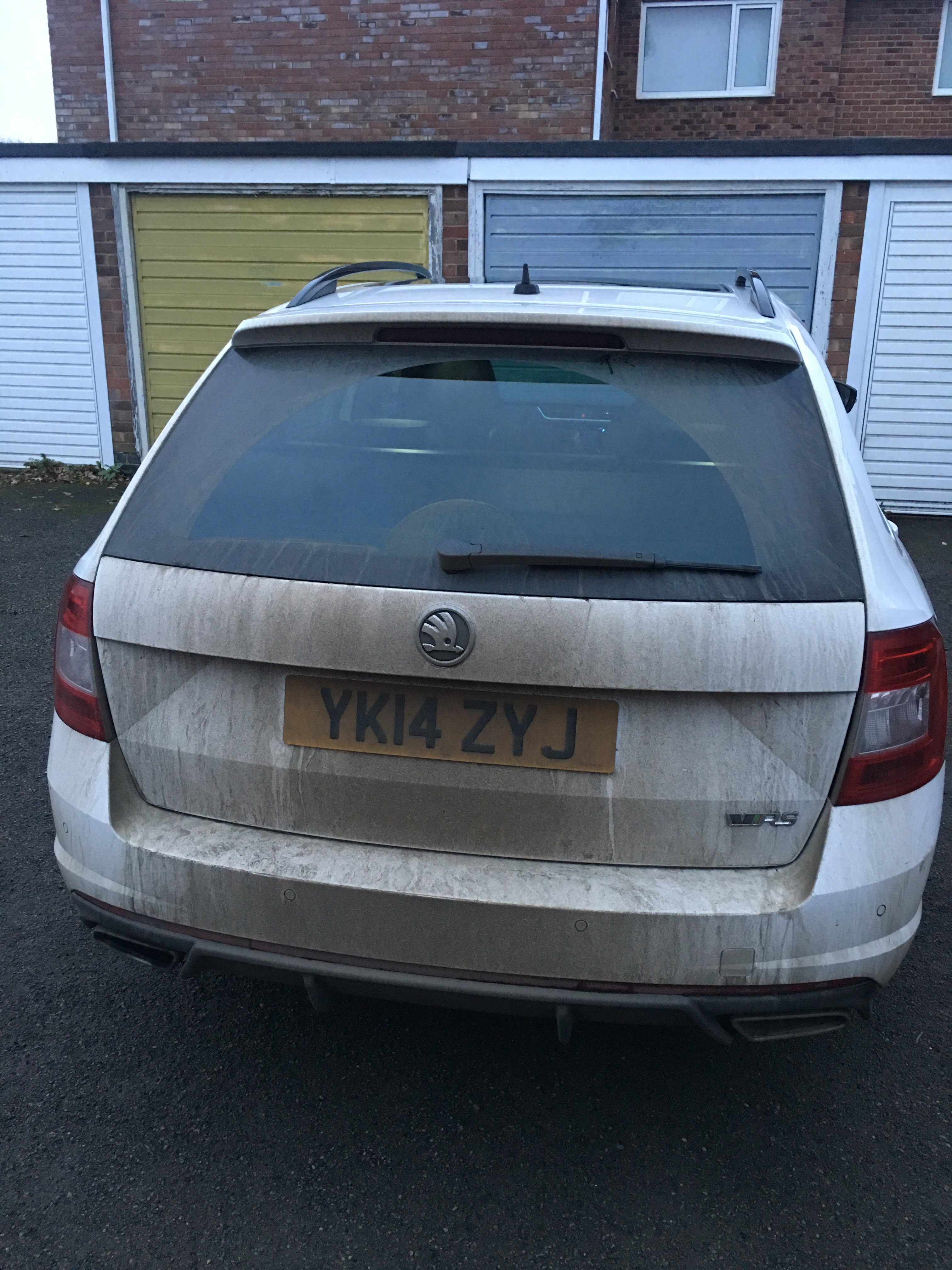

I hate winter for keeping the car clean.... only washed it last weekend! It’s clean again now for the next five minutes :D

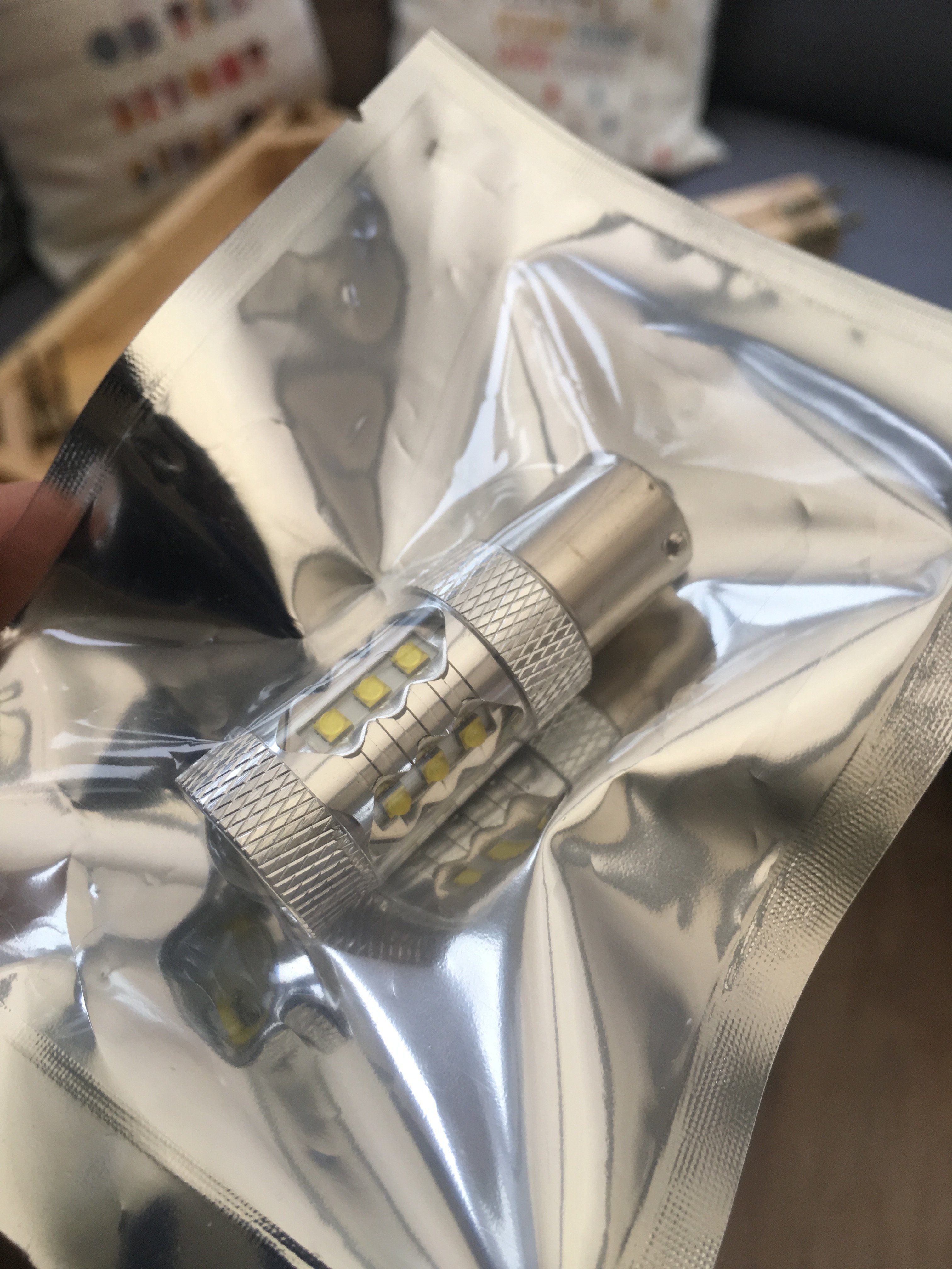

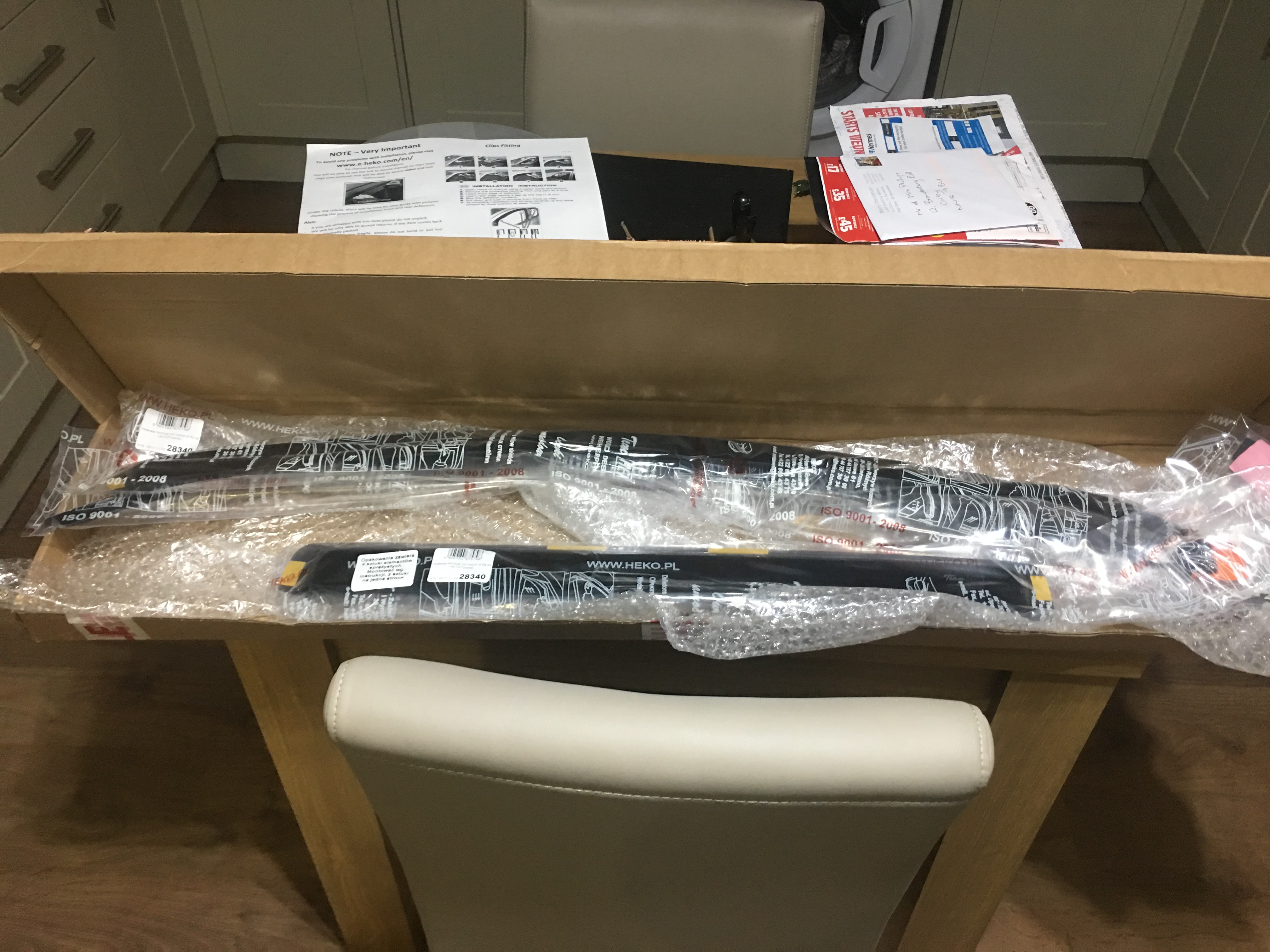

Also ordered some Team Heko Wind Deflectors, LED reverse lights (only ordered one doh!) and booked in at Shark Performances for a DSG remap.

7 hours ago, Tim1631 said:
Do you have a link to the reserves bulbs please
They’re from Horizon LED1156/BA15S/P21W - CREE LED 80W
