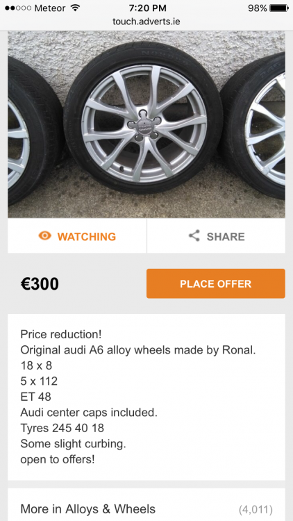

Would I be correct in saying these alloys would fit my 2012 Mk2 Octavia?
I know the tyres will be too big but would I be correct in saying I could fit 235/35/18 tyres to them?
Hoping to pick up tomorrow so any advice would be greatly appreciated!

they would fit, I would recommend 225/40/18 being 8j wide it would be like a Neptune 7.5j with a 12.5mm spacer on the front and rear,  rears are fine as they are a smaller track than the fronts, fronts may stick out a little bit but should be ok

Thanks for the reply, are the 240/40 tyres too big? Would you recommend any brand of tyre ?
with the extra width 240's may catch on the arch ...this all depends on your car of course vRS/lowered  etc. with a 225 you get a slight stretch which may help with arch rubbing should you get any.
tyre suggestion... ive never driven on irish roads  but I personally like pilot sport 4's or P Zero's
