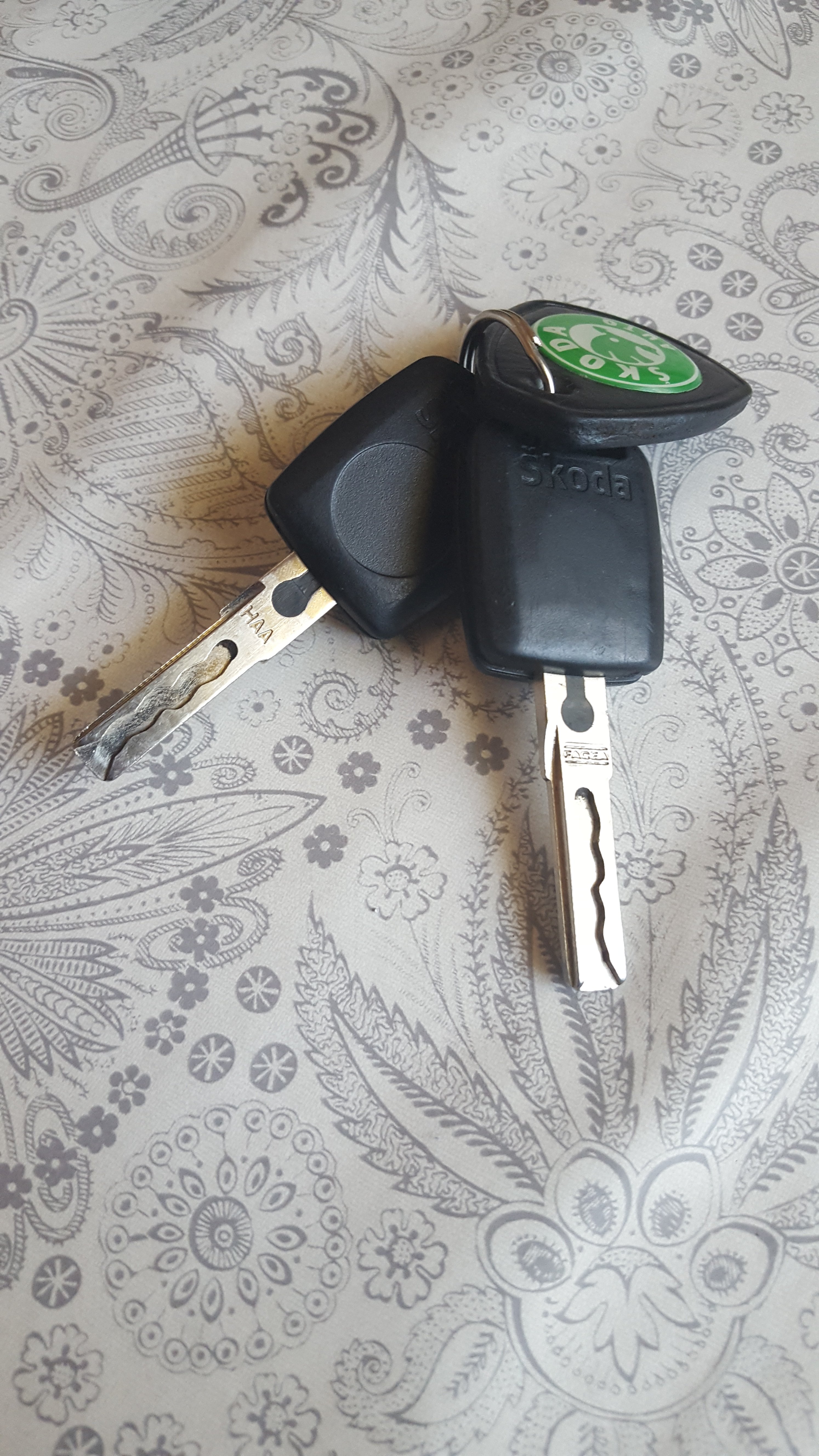

Older central locking didn't used to close windows, then it started to, depending on model variants. I had an old VW that did it but many cars didn't. I am assuming your car has been tampered with in some way or another. Do you have the folding fob key or just a key? Is there an immobiliser fitted to the key?
I don't really know if there is immobilizer but this kind of keys I have.

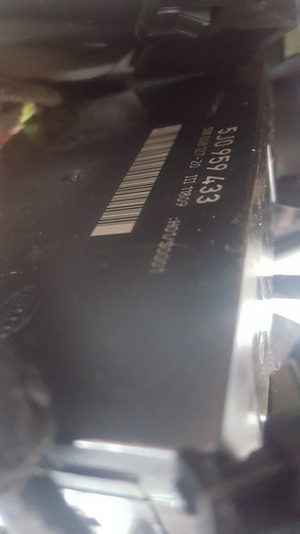

1495372532929967189348.thumb.jpg.33c5a9520467b3e0527956bfaa6c673a.jpgI found it!
Allright, those realoem codes show that without A end of the code-> means central locking module without remote control. So it supports only central locking. Is it possible to buy used box somewhere (with A) and swap the boxes and buy couple of keys and code it with vcds? What I have to code if I change the boxes, do I need more parts or just that box
Edited by okku12
WOW! they look like they come from a Favorit, not a Fabia! Looks like your country must have been supplied with low spec stuff as I have never seen these on a MK2 Fabia. Sorry. Perhaps an aftermarket alarm might be the way to get remote but not sure how you would marry it up.

20 hours ago, okku12 said:
I found it!
I'm not sure what else might be needed, if anything.  I can have a look at the wiring diagrams to see if there are more wires associated with the remote-locking version of the module, later today.

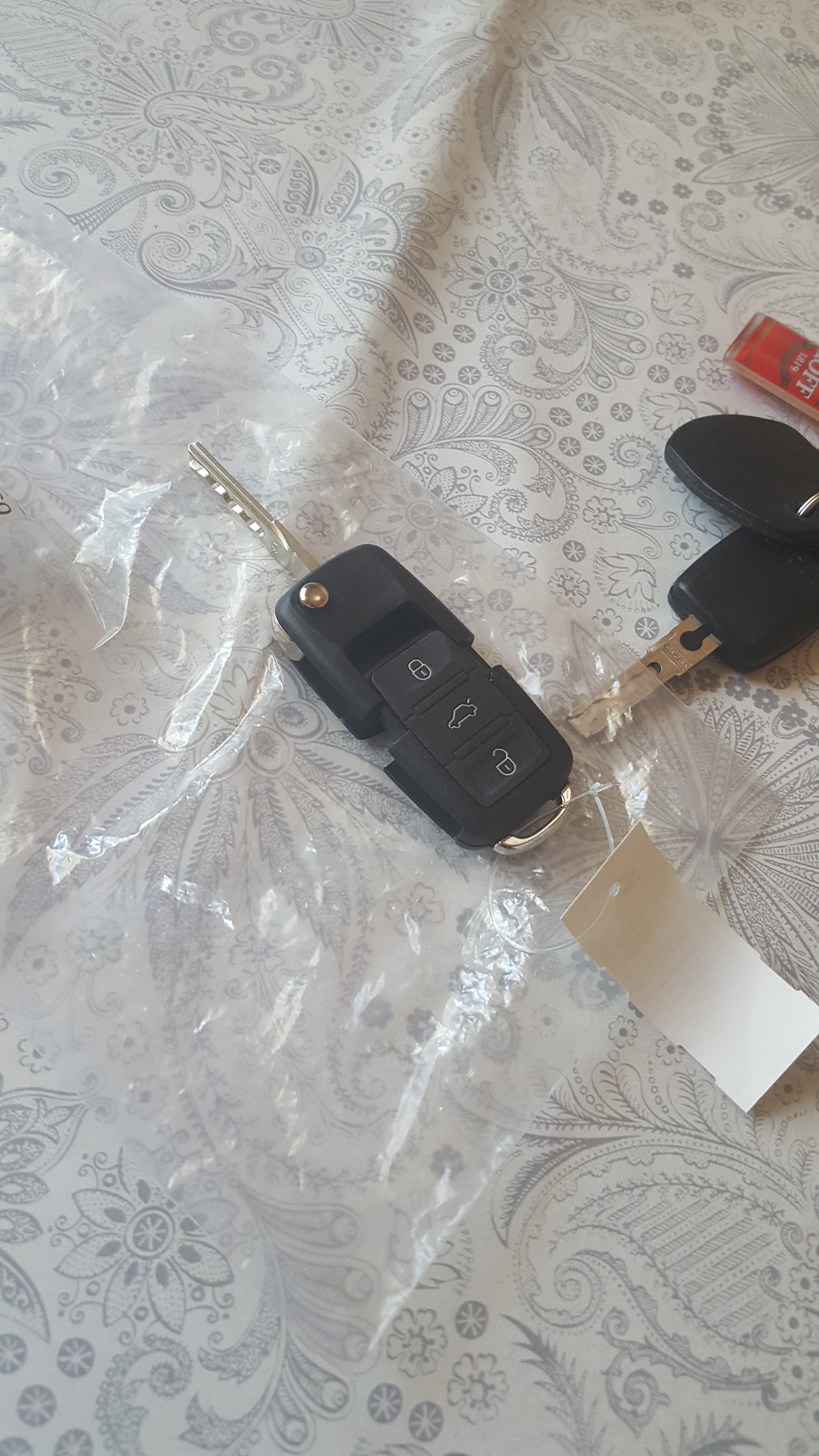

Okay, things are going forward. I ordered fob key and it came couple days ago.
The next question was: Do I have to buy new one or is it enough to buy used central locking control module. When the used box is already coded for car A, is it possible to code to car B. Problem was most likely solved when I asked dealer's staff mechanic about it. Used box probably can be re-coded. Today I will order used box which comes a lot of cheaper than to buy new oem part. It's also in that kind of place that there isn't water so I dare to buy used one. Haha, everyone (even brand's part dealers) is saying, when you get that thing done, tell me how things went and how you solved problems.:biggrin::biggrin:
I am guessing you will also need to put the lttle "Rice-like" immobiliser thingy into the new fob but you are in fairly unchartered waters doing this job. Might have been easier to get a decent after-market alarm with remote linked to your central locking.
It's oem key and immobilizer came with that key. It will be coded with vcds.
