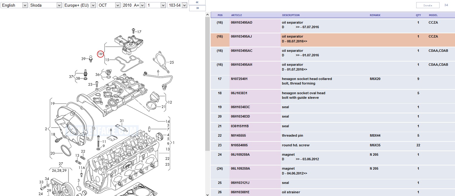

Well, for 2.0 TSI engine code CCZA is last modification separator 06H103495AJ. It surprises me you have now 06H103495E as this is old one for 1.8 TSI from same family.
But to be fair, when I look at other brand, Audi A3, they make no difference between 1.8 and 2.0 TSI EA888 concerning oil separator and last one they say is 06H103495AH... Mess as always in last few years... So it seems AD and AJ knows only Skoda and maybe VW, do not know what to think about it. I am sure it is related to oil issue and pistons+rings trouble as breakpoint is June 2010, time when modified pistons+rings were introduced ... will post here details for Passat CC just to compare.

So that PDF suggests I need AH?  It seems to flow as such:
06H103495E > 06H103495AC > 06H103495AH
But then at the end of the document, it says 'TILL 14.6.2010' (which includes my Oct 2009 registered 2.0 TSI) it says 06H103495AJ which is the part number mentioned by TPS also.

Well, Skoda says for CCZA only new separators, VW still have at ETKA those two groups separate. In light of these information I would stick with AH. But it´s only my personal view based on data from VAG catalogue. Before you buy, try to pop in few dealers and ask what they will offer to you, do not mention you have info too, wait what they tell you. Then you can confront info you have with official dealers knowledge. Based your engine is made before June 2010 as registered already 2009 B), I really do not know what to advice more, have experience only with 1.8, not 2.0. Know only from photos on web new ones (H+AD+AJ) differ a bit from old ones (E+AC+AH), haven´t seen it on own eyes.
Sorry fot that mistake on last page with printscreens from ETKA, it´s my fault, should be "from" instead "till". File corrected.

My garage have just replied with 06H103495AJ, so I'm very confused..
I'm struggling to find anywhere that stocks the AH so I'm thinking that AJ is the only way to go.
And I take it I can't simply purchase a new diaphragm on its own?
Edited by planehazza
The volkswagen extracts seem more complete. My vehicle is April 2011, revision H is fitted.
Your car is presumably earlier than that (i.e pre 13.06.2010) and has E fitted.
VW suggests E => AC => AH (most current)
And a different path for 14.06.2010 and later vehicles If I am following correctly...
H=> AD =>AJ (most current).
So, I guess if I was replacing in my car, I would go for AJ. For your car, based on earlier build and E fitted, AH.
Can there really be that much difference though? And how come the skoda Etka histroy doesn't appear to reconcile to what was fitted to cars, the VW one looks far more representative unless we both have replacement items fitted.
