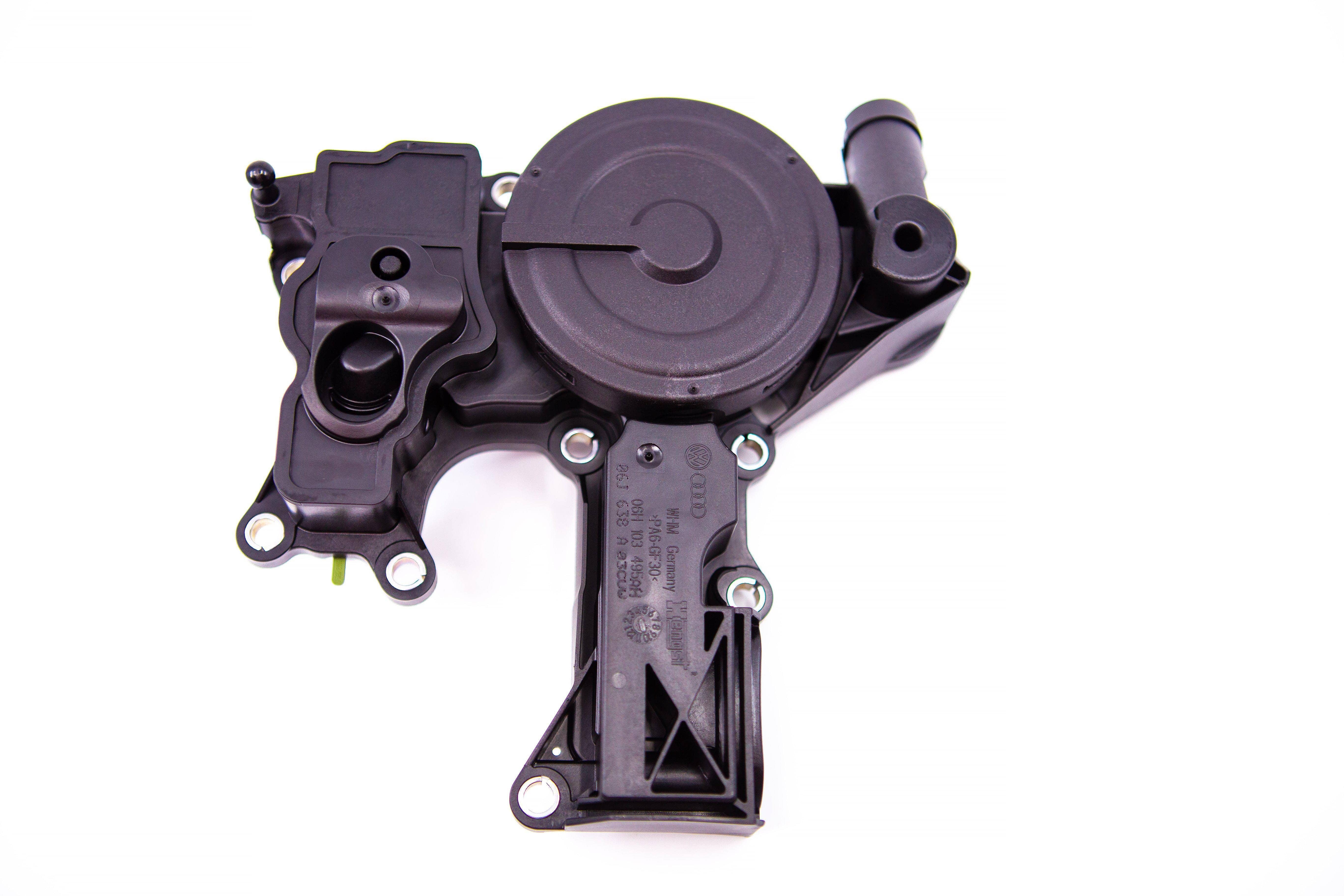

Wife has a  ( 2012 ) Octavia-II with EA888-II TSI  engine.
The car works incredibly well, but drinks a lot of oil.
( I only put 100% fully synthetic oil 5w-40 in it. )
Was thinking of changing the PCV-valve to see if it gets a little better,
but it comes in 2 different versions that are apparently not interchangeable.
The latest updated version of the PCV-valve are apparently available in 2 different models from VAG-dealers with 2 different part numbers !  😵
Even my SKODA dealer didn't know the difference and which one I should have
🤔 Anyone here know what physically separates the 2 different PCV-valves for this engine ? 🤔
🤔 Anything else that is good to replace at the same time as replacing the PCV-valve ? 🤔
06H 103 495 AH
#  06H 103 495 AJ
